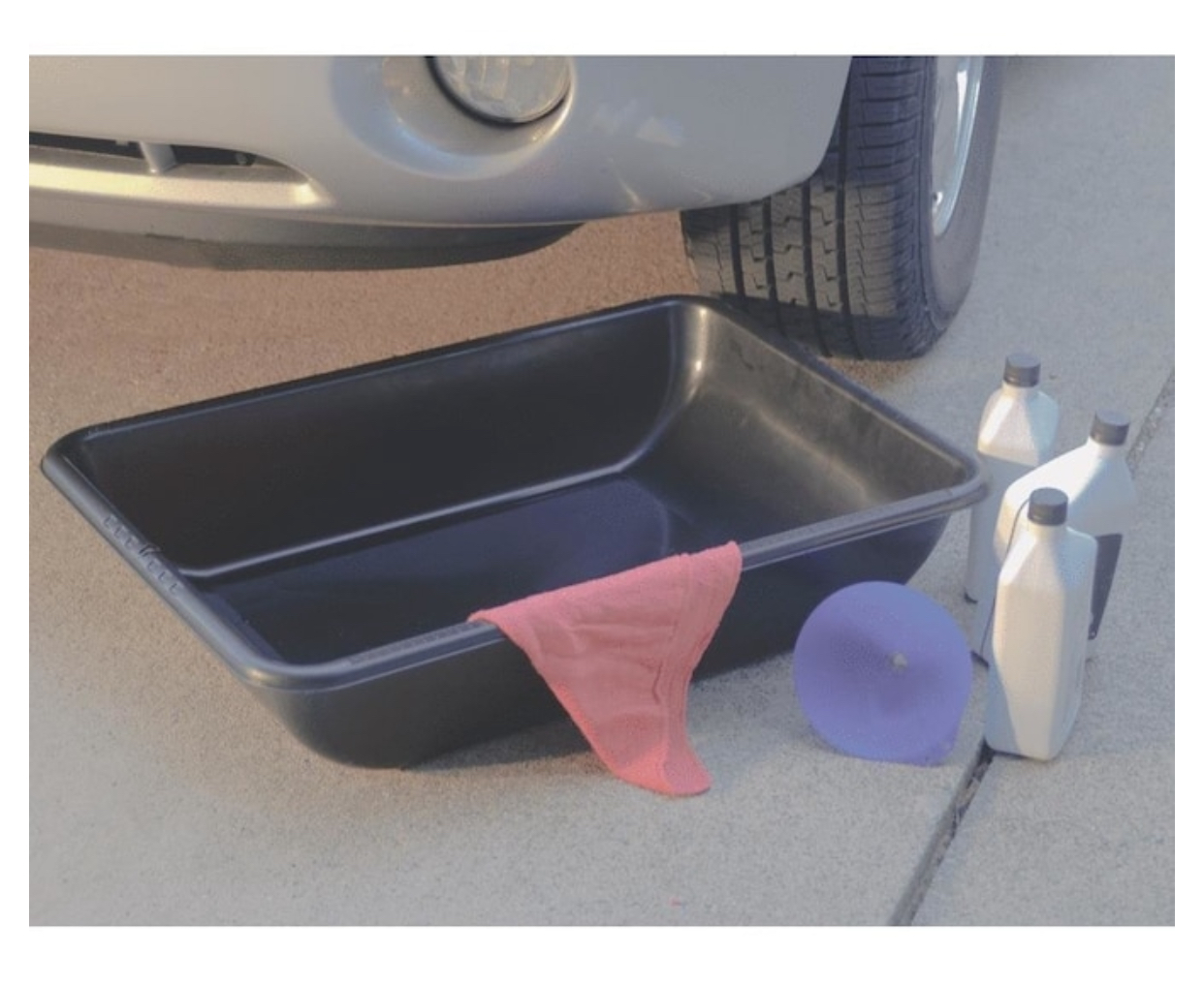

Go to Lowe’s, back in the area where that have cement bags. They have a very large, deep pan for mixing cement. It works great to drain transmission fluid into. You’ll have to pour it into something afterwards but it’s plenty big enough to catch most of anything.
I’ve had a couple of them for a couple decades and it helps a lot.

I don't need another thing in my garage. Pan drain plug takes up no space and makes no mess. YMMV.

Say it with me everyone, “different strokes for different folks”.
