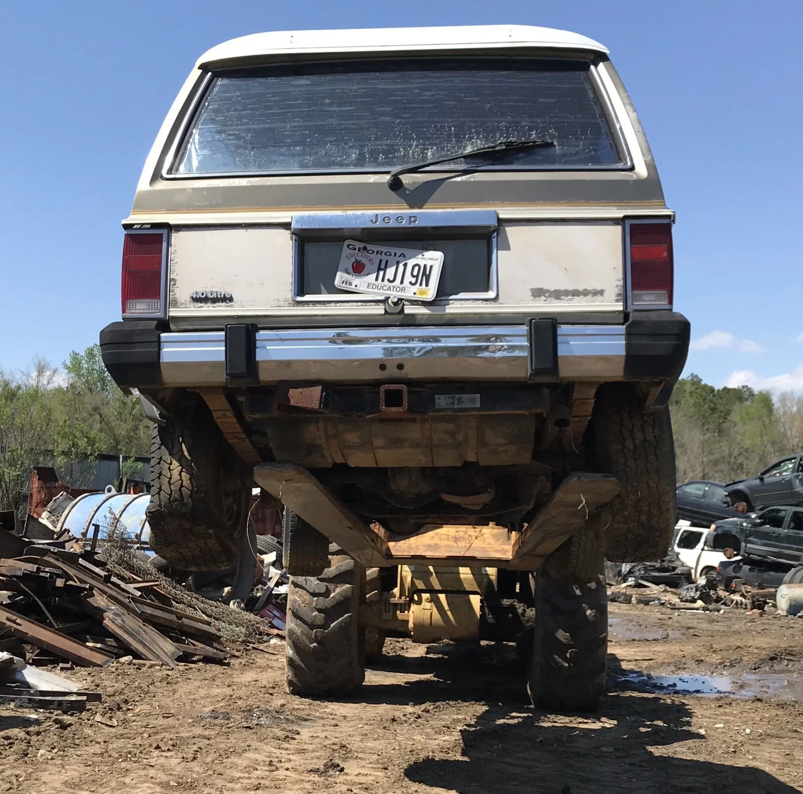

While reading on a forum, someone mentioned that some 86 & 87 XJ's had Dana 44's. Awesome! They then said that the Dana 44 is considered rare, as the Dana 35 was another axle option those years. I decided to give my local junkyard a try and see what they had. I guess the Jeep gods were looking out for me that day because I found two XJ's with Dana 44's. My donor Jeep is an 87 XJ Wagoneer with 3.54 gears.

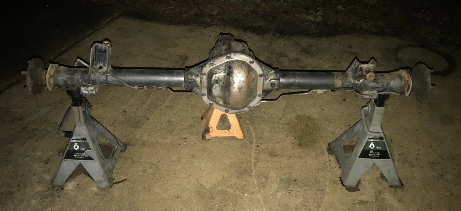

Anyway, I created this post to document my Dana 44 swap into my TJ. I've got all the parts for the disc brake swap ordered, I took the drums and drum backing plates off, and I've started removing all the grease and dirt.
My next steps will be a disc brake swap from a 96 ZJ, 5.13 gears, detroit locker, and an Artec truss. Any suggestions would be appreciated, this is my first axle swap.

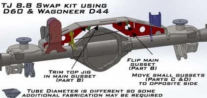

This should be a helpful thread! What's required to get the Dana 44 from the older XJs to fit on a TJ? I assume you've got to weld some spring perches on since the XJ has leaf springs, but is there anything else required?
Yup, all the brackets on the XJ axle will be coming off and an Artec 8.8 TJ truss will be welded on. Artec has instructions to adapt the 8.8 kit on a Dana 60 & Wagoneer Dana 44 so it should work on the XJ Dana 44, maybe.
If I wasn't going the Artec route... spring perches, shock mounts, lower and upper control arm mounts, sway bar mounts, and a track bar mount would have to be welded on.

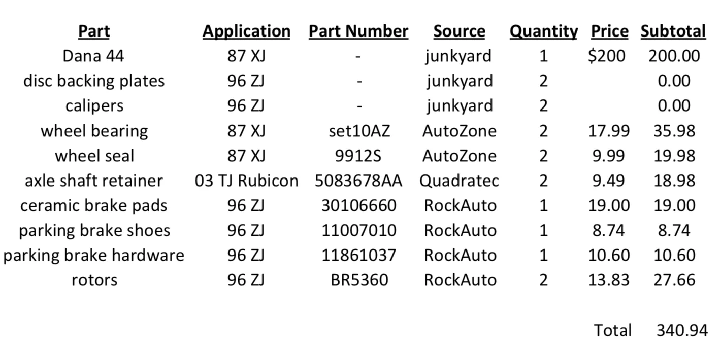

These are the costs for the purchase of the axle and disc brake swap. I still don't have the ZJ disc backing plates or calipers yet so they aren't factored in.
