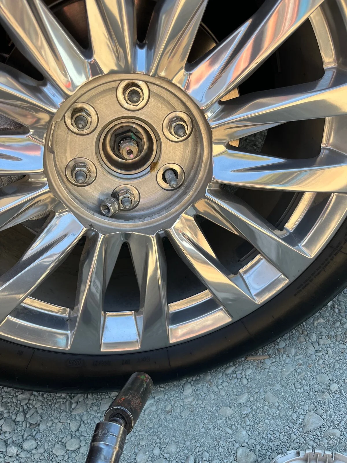

I got my 2023 Escalade back from the dealer after getting it first oil change and tire rotation and check up. Since the first service is free from GM I took advantage of it. A few days later it developed a rattle in the wheel, I pulled off the center cap and found a lug nut had come loose on two different wheels. WTF
