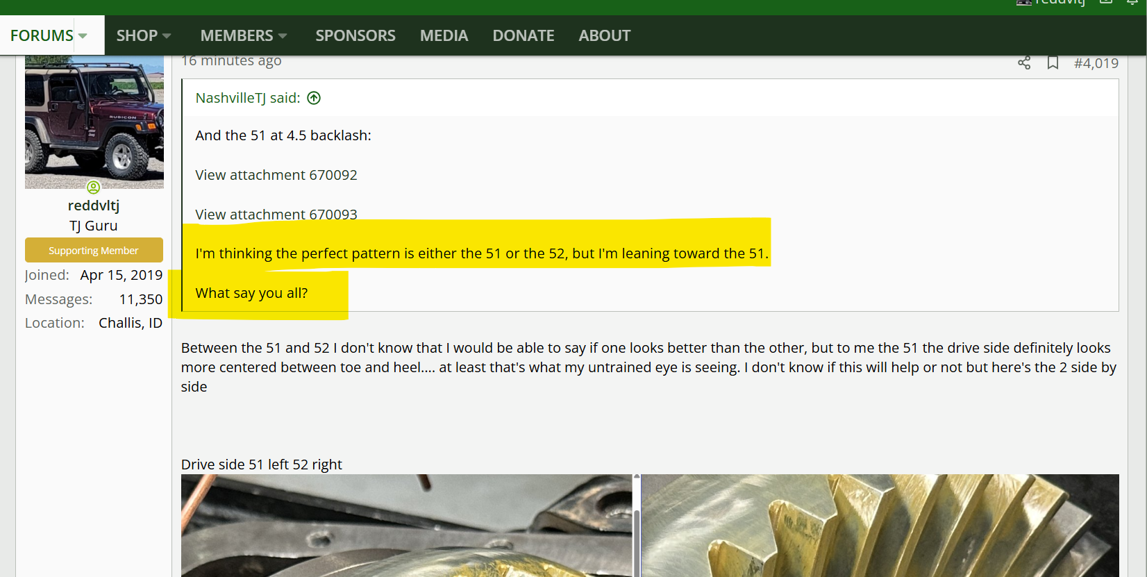

I take that to mean that the best "traditional" approach pattern was the 52-7.5. So, Ben agreed with Mike on that one.
For the deep approach, his favorite is the 47-7. So ultimately, he's recommending 3 thou deeper than a standard setting.
It sounds to me like Ben is saying either of these would work. As a final question I replied back and asked if there was any expected downside on the deeper setup. Wear, excess noise, or anything like that.
I do want to make sure these things are quiet - as that's the whole problem I was trying to solve this time.
So, it sounds like I need to decide between these two setups. Anyone have an opinion on which way I should go?
I think he’s saying both the 49/7 and 52/7.5 are runnable, but the 49/7 is better. That’s what I’d run. Sounds like Ben will warranty either.
What did I win??? 😂
I just went back and looked at both patterns. The 52 is the best non-deep pattern. The 49 is the best "deep" pattern that still works. If you want to be slightly deep, then 49 is your best option.
What did I win??? 😂
Thanks Mike. I'm leaning toward the 49.
So, no love for my way of picking the best setup? I'm surprised - it seemed like a sound way to evaluate the patterns. :ROFLMAO:

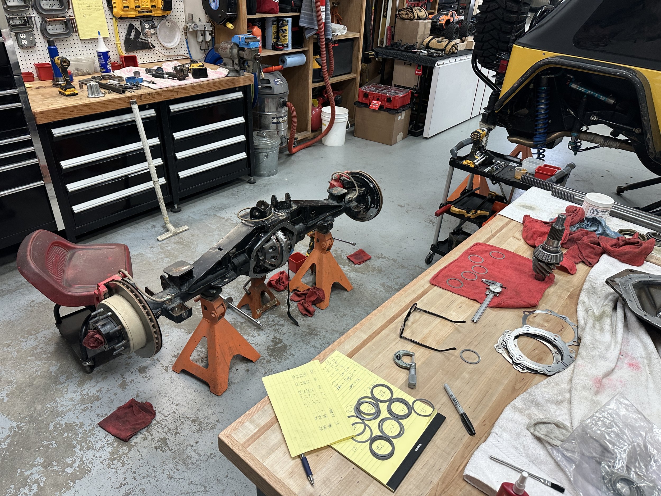

Interesting thought, Flux.
I don't install the retaining clips when doing the setup. But I am very careful to locate the adjusters in the position where the clips can be installed. When properly installed - at least on mine - the clips actually press onto the rounded ends of the adjustment slots, and keep the adjusters from moving at all.
That said, if I somehow positioned the clips to be centered in the slot, there could be a little movement. My guess is that this would allow the adjusters to move about 1/10 of the movement of moving an entire slot.
To validate my preload, I've mic'd how far the adjusters move when adjusting one slot. It's 4 thou. So at most, if the adjuster were to move the entire length of that freeplay, it would move less than a half a thou.
That said, on the ARB the preload spec is 15 thou - or a little over 3 slots. That is actually a lot of pressure on the adjusters, and I think it's unlikely that they would move given that much pressure against the carrier bearings. Certainly possible, but as I said above the movement allowed would not be consequential.
That does bring up an interesting thing about setting backlash on the 14 bolt. It is not infinitely adjustable as you might think, as you always have to position the adjusters where the retaining clips can be installed. Once the preload is set at the very beginning of the setup, you adjust backlash by moving both adjusters in the same direction one full slot at a time. This is how you maintain the preload once set, and always results in moving the carrier 4 thou in one direction or the other.
That is why the backlash numbers on my labels move around a good bit with each different pinion depth. Backlash spec on the 14 bolt is 3-12 thou. For my setup I want to be tight, and target as close to about 4 thou as I can. That is the reason my backlash numbers go from around 4-5 to around 6-7. If I adjust the pinion depth and get a backlash of 6-7 I can't go any tighter because one slot tighter on the adjusters would take me down to 2-3 backlash. It's not a 1 to 1 corolation, but it's close.
Anyhow, a nice thought exercise as I'm sitting here drinking my coffee. Now I'm off to button this thing up. Should be back on the road today.
