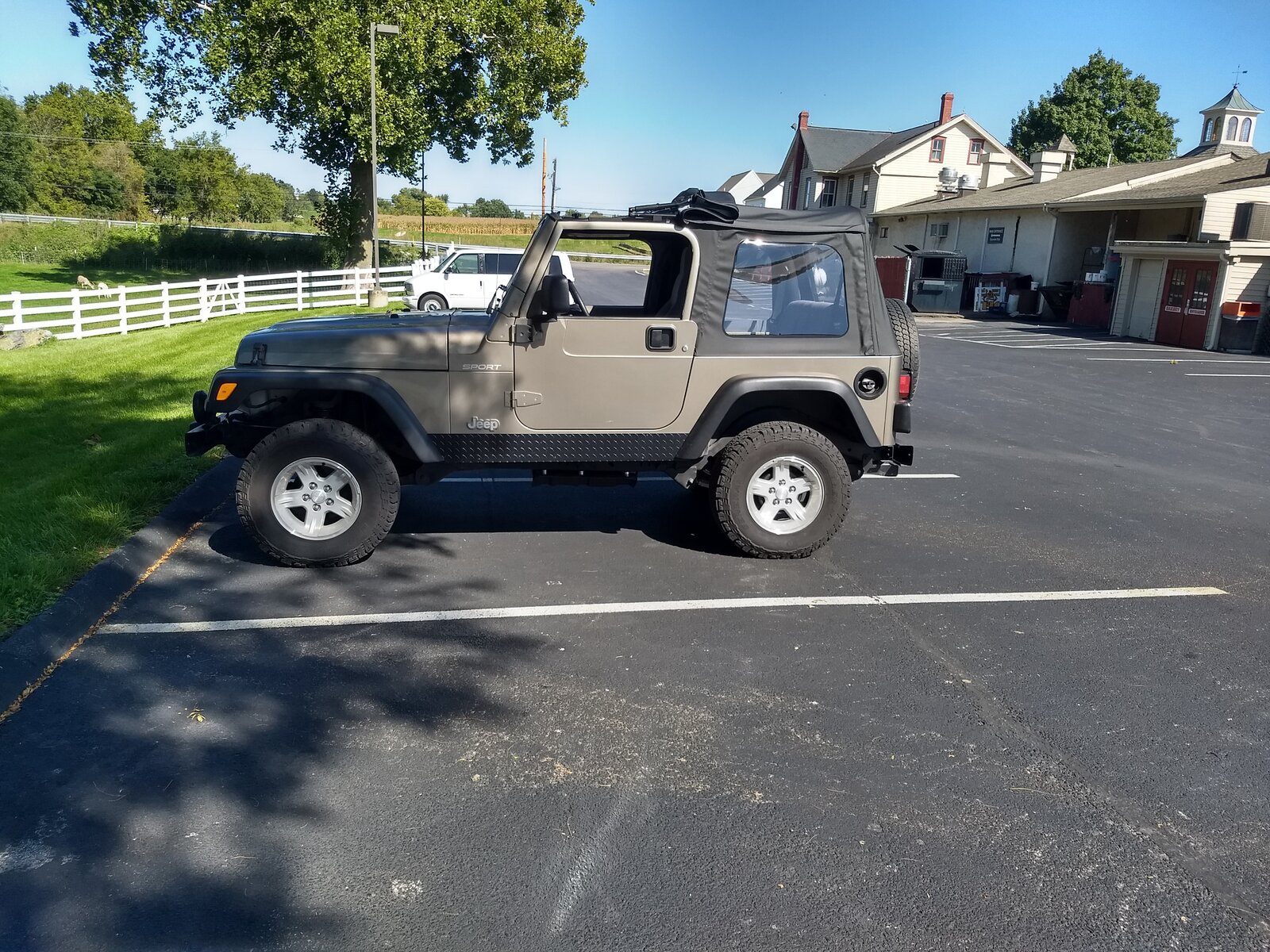

On the cheap, look at OME springs and Rancho RS5000X shocks. This is what it looks like with 30" tires.
