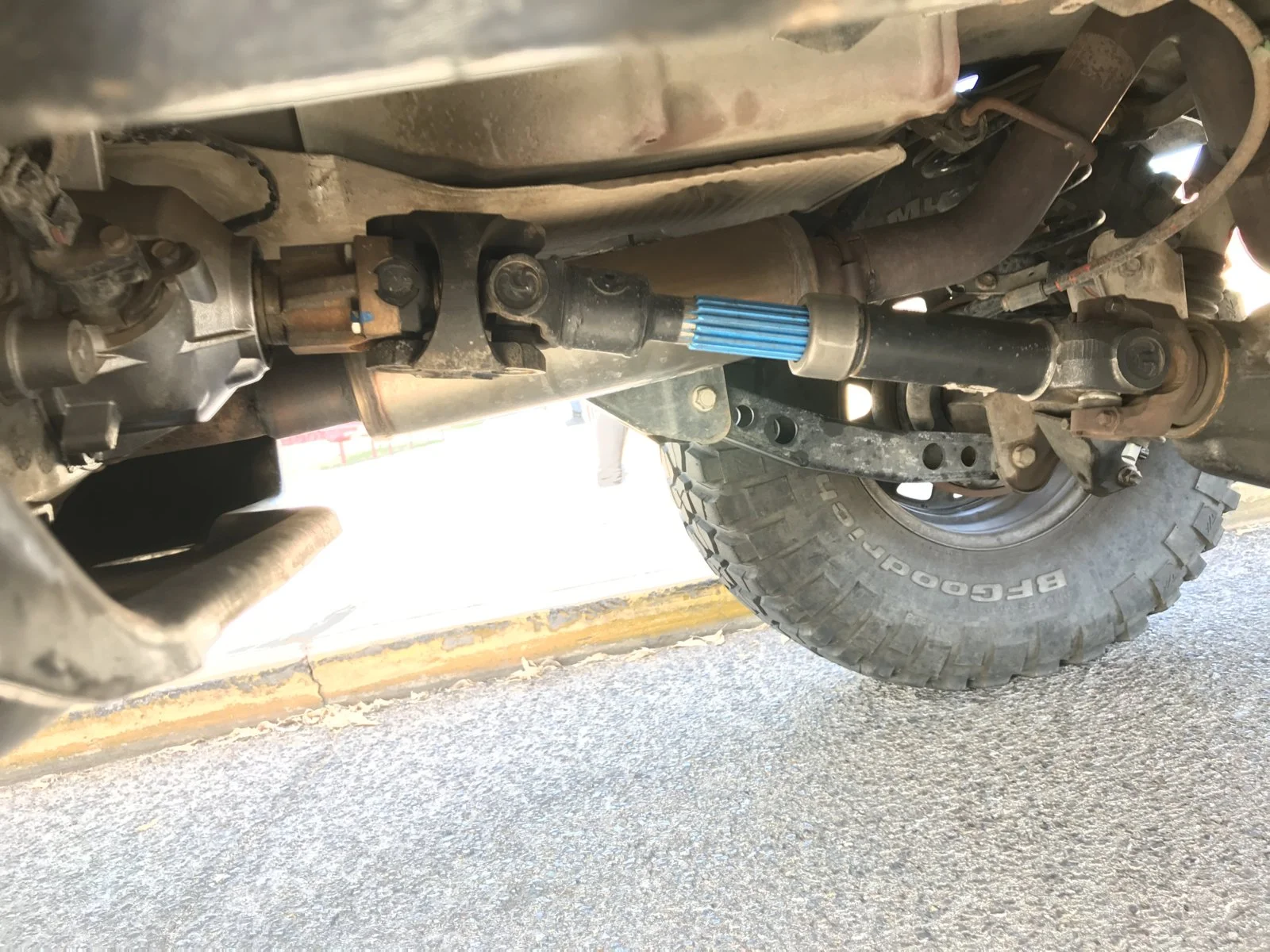

Question, I read through the SYE thread and still don’t know if mine has one ( see pic). I contacted a local 4x4 garage and I was told with them making an new ds and installing a SYE it’s cost me near 3grand. Is this how much these things cost. My TJ has a 4” pro-comp lift. Any help would be appreciated.

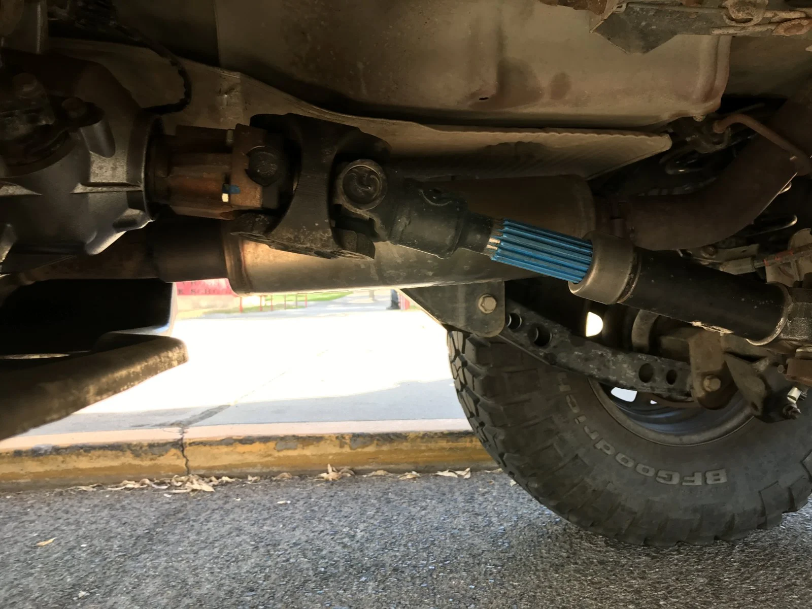

Another pic

I paid about $325.00 for the kit, a friend gave me a front drive shaft from a jeep Cherokee that I spent $75 to get shortened at a local driveline shop, and I was done. You can save a lot of money if you can do it yourself.
By the way, your picture looks like you have the mod already.

Thanks man, I wasn’t sure if I already had it or not. I was just worried with all that shaft sticking out exposed.

That drive line does look like it has a little bit excessive amount of spline showing. It may have been fabricated when the jeep had a lesser amount of lift. Can you measure the amount of exposed spline? Mine has 3" of travel, with 1.5" showing when it is in the neutral position.

There’s 3” when it’s just sitting like in the pick.

Do you know how much travel the driveline has overall? I suppose it's possible you have one with lot's of travel, but you'd have to have like 6" travel in order to be centered up with 3" showing...

I have no idea on how to ascertain how much travel my driveline has.
