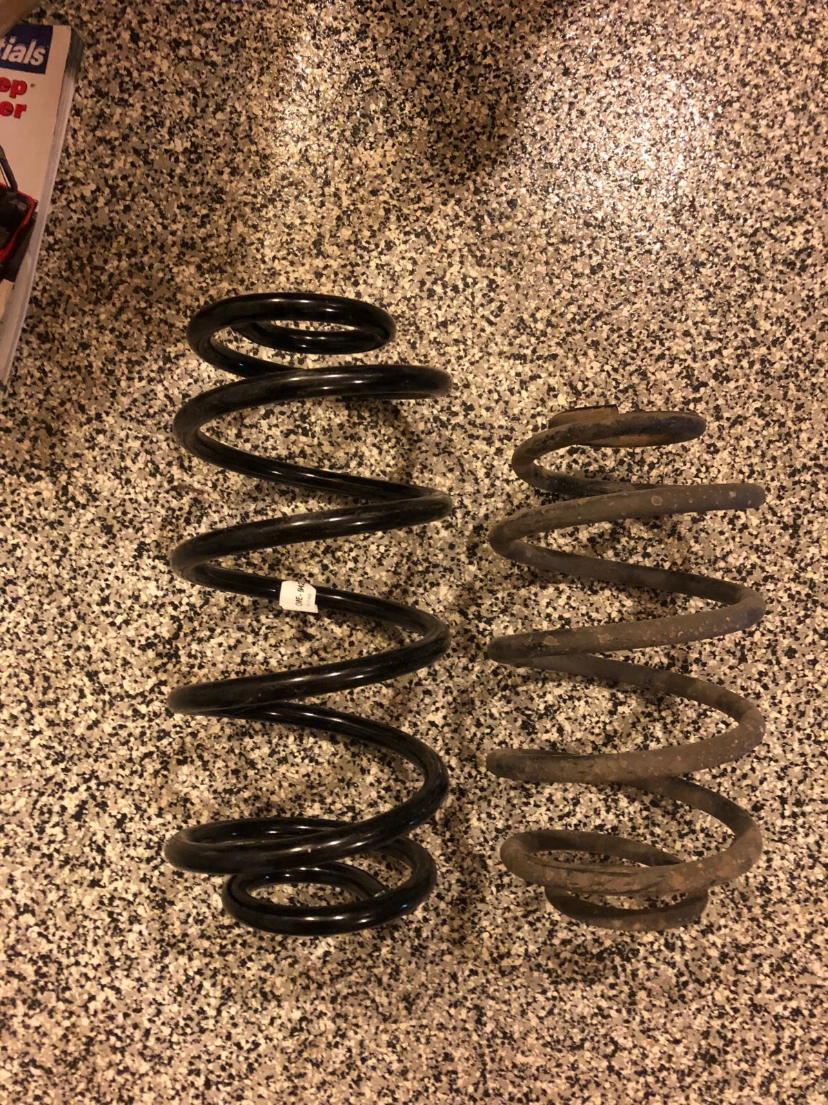

I have understeer after my lift so I need to do it anyway. I will correct the alignment and the steering after I get mine to sit right. <= or the way I want it to sit. I am still waiting for my springs. Hopefully will be here by Friday so I can get them on this Saturday. By the way here is a picture of my stock rear spring in relation to the 2 inch rear heavy spring @bobthetj03.
Even has the 942 sticker on it. Do a comparison of the 941's when you get them to the 942's. The 941's should be a tad taller unsprung than the 942's. With the lower spring rate of the 941's, it may or may not sit lower. Hopefully, for your sake, they sit lower.
