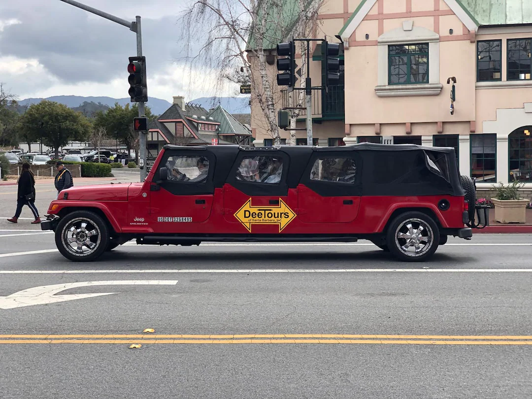

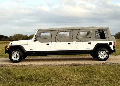

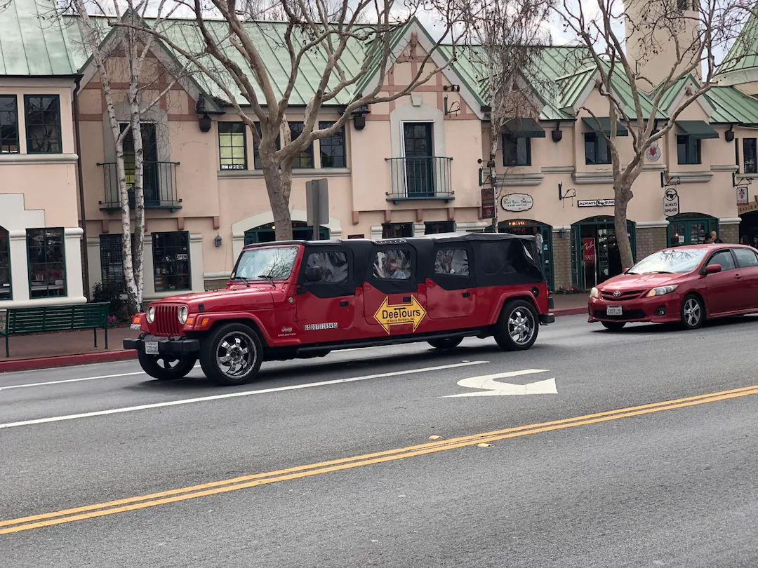

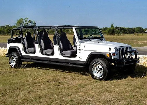

Don't want a 4 door TJ?
6 door or bust
You can do better than a Cadillac
