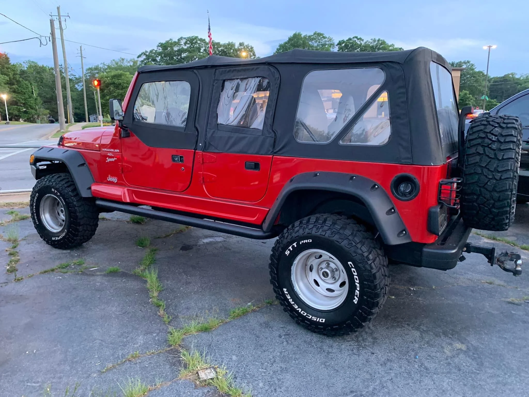

... I just noticed my oil pressure gauge is reading midway all the time now, have no idea why, I assume that is normal for tjs
It always read that way. The late TJ oil gauge is a dummy gauge. Straight up means the oil pressure is within parameters.

Looks like you have a drop trackbar mount, but not a drop pitman, hard to tell from the pic. If that is the case you might be feeling some bump steer.
