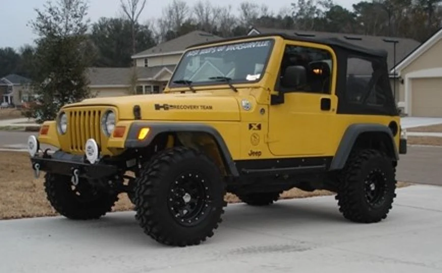

Welcome to WTJF. You DON'T want a RC lift, used lift or a 6" lift. For 31" tires, I'd go with a 2" lift or just a 1.25" body lift. Pic of a 2" lift and 31s.
