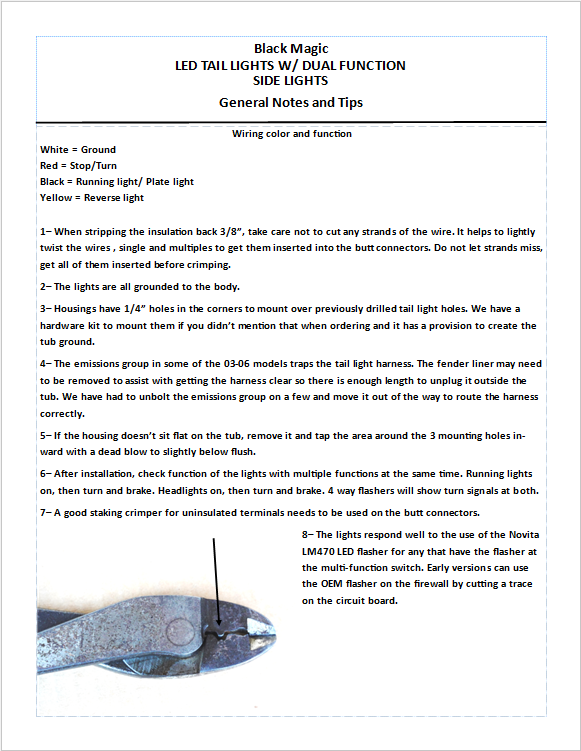

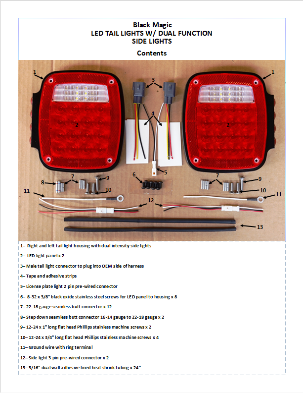

Sample, and best I'm going to be able to do.

I love when the pictures look like they've been photocopied 100 times and everything is blacked out and there's a little line pointing off that's supposed to be an arrow that says "do XYZ very specifically right here" and you can't even see the picture. Or "remove the part" so you take out the bolts/screws only to find out that there was also a plastic clip that you just broke because you didn't know it was there 🫤
Fantastic - although you might want to label the lights as "1A (Right)" and "1B (Left)" - otherwise some idiot will wonder why the side lights point inward... ;) I'm only partly joking...
You can't really screw that up. The reverse light has to go at the top, it won't fit in the housing the other way. If I am worried about someone trying to put the marker lights to the inside, then they will need more help than a set of instructions can fix.
Just add a caveat in the instructions. "If when complete, the side marker lights face inwards, please remove the lights and return for a full refund because you don't deserve these lights." lol

My biggest pet peeve doing instructions is what you see on the screen always prints darker so you have to keep messing up the brightness and contrast until it is so washed out that it then prints well enough to see some detail. The edit, print, check, change, print, check part drives me crazier than I already am.
So, some ingenious idiot will invert the housing and drill new holes while cussing that "this damn thing doesn't fit"...

But it's that detail and effort that sets quality products apart from others.

Why not provide digital download of instructions on BMB website under the product description? That way no requirement for you to print, pack, et al.
