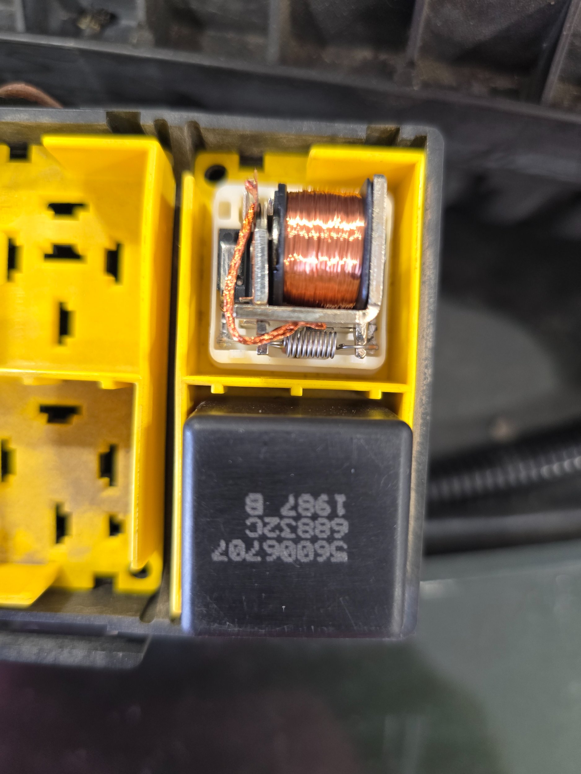

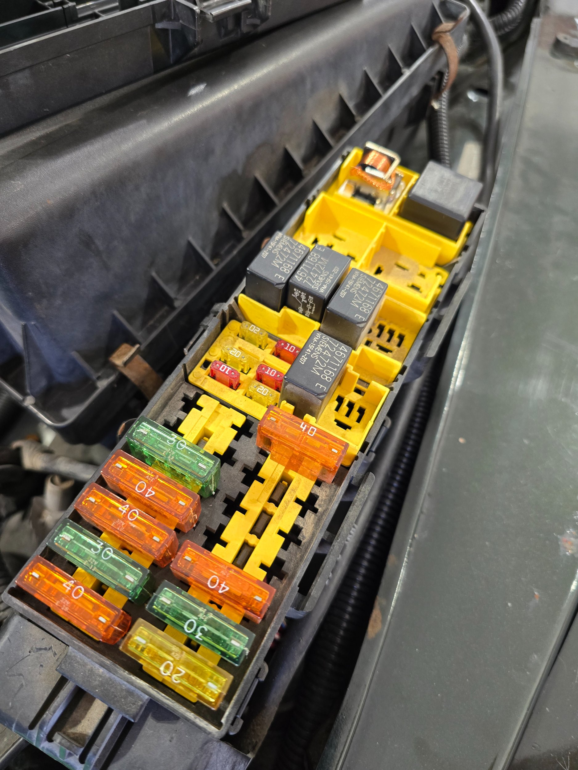

Starter has been replaced because it was original to the jeep and had given me a few different issues intermittently before so I just went ahead and replaced it hoping it would be my issue. It was not. I bypassed the clutch safety switch and it still did not start. Battery is clean newer and all connection are tight. Im going to switch the starter relay out with a new one. There is 12v power to the relay terminals. The relay itself read nothing on my ohm meter.
