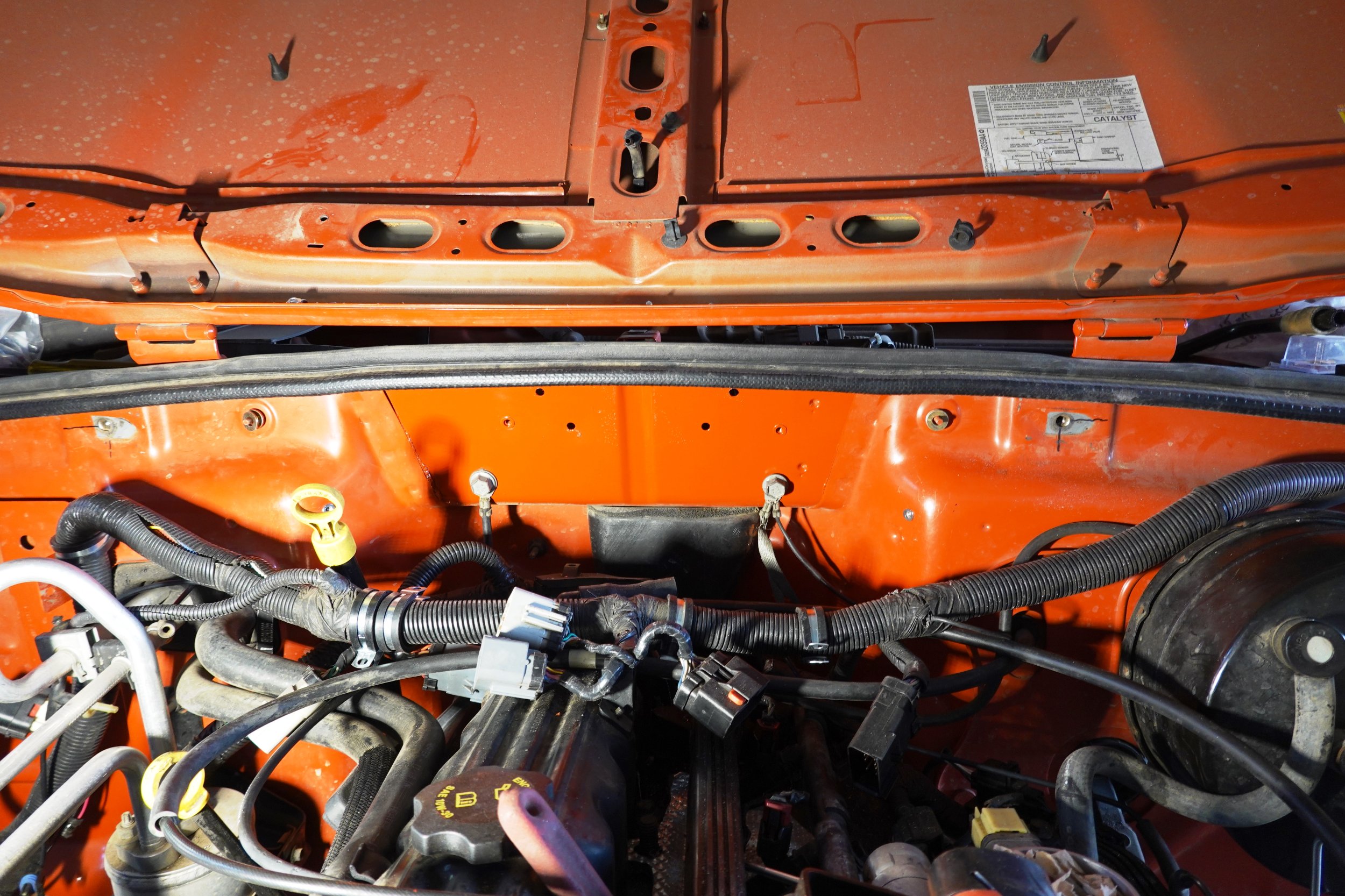

I assume Blaine’s new profile picture is your Jeep, @psrivats. Is that an aluminum raceway behind the Switch-Pro to clean up engine bay wiring? Looks very nice.
Yes :) Blaine did some really amazing work and this was just last couple days too. I am really very fond of what he did, the pics put a BIG smile on my face when I saw them.
The stock harness and connectors are routed through the inner plate, with lots of room for everything. He put in slots to allow the connectors to get in behind the cover plate without pain. SwitchPro is installed with a grommet for the power. The area with the green oval is for relays for the compressors and for the the power outlet in the rear that I had requested.
I really love this mounting solution .. there is nothing outside that comes anywhere close in functionality, let alone the super clean installed look. Perfect example of Blaine's operational manta of simple/clean and functional.

So...where did you drill new holes to mount that wonderful mounting panel? I assume you installed nutserts?
