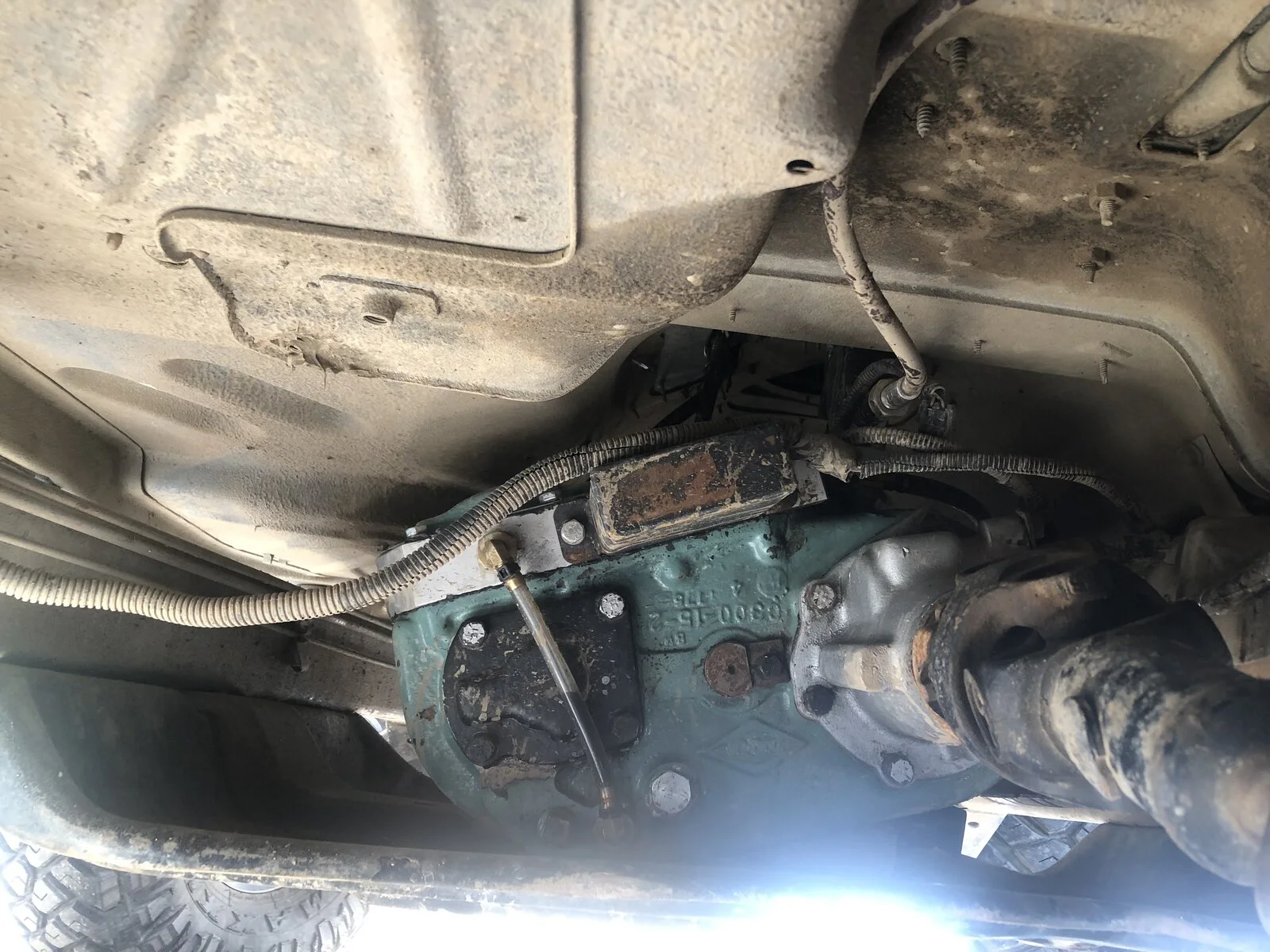

I moved the vent to the higher end of the cover. With it on the low end it blew some fluid out, perhaps I could have solved that issue with a little less fluid but moving the vent made a whole lot more sense. I will look for a pic on how it sets. I didn’t plan ahead for a flat belly skid. We clocked my Brother in laws as low as possible to help the front pinion stay at a decent angle. So I wound up just clocking mine the same. It could have been clocked up a bit more. The only thing I see that would need some help is the shift rod cover on the back of the case will hit the tub if used with the doubler box.
I guess it’s clocked where it should be.
Here are some basic pic with a 1” body lift. Might be able to go flat belly with a low pro mount. I decided to do with the no body lift skid which will arrive today. These pics are with the stock 97-02 skid.

One thing I did not notice until these pics is the cable shifter doesn’t leave a lot of room between it and the case. Looks like I really lucked out by being lazy and going with the no body lift skid. Lol.
The name is a bit tricky. It requires no BL of using the low pro mount. I will be using the stock mount and a MML. I am not interested in adding idle vibrations for a bit of clearance, at this point anyway.
Man looking at your pictures you have TONS of room compared to me and my setup.
