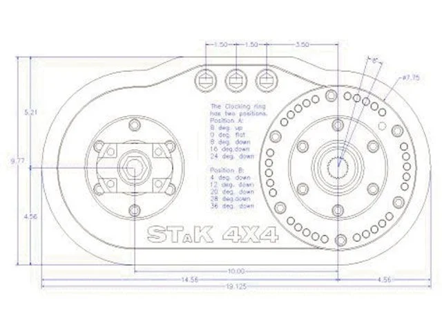

Here the dimensions for the STaK's Monster box.
I'll be watching to see what the NP205 measurements come out to be.

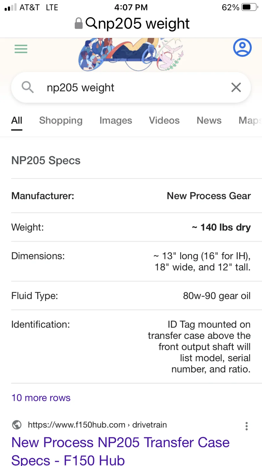

A stock NP205 is like the STaK's in they are both pigs. I think a stock 205 weighs over 100lbs and my STaK's is 150lbs.
Reactions: someguysjeep
Yes I'm hoping Midnight has a better price point than Behemoths prices. I'd like to see it around $1500-1600 and you add the internals.
Midnight is $1400 I think.
Reactions: JMT
Stock 205 is 130-140lb I believe.
