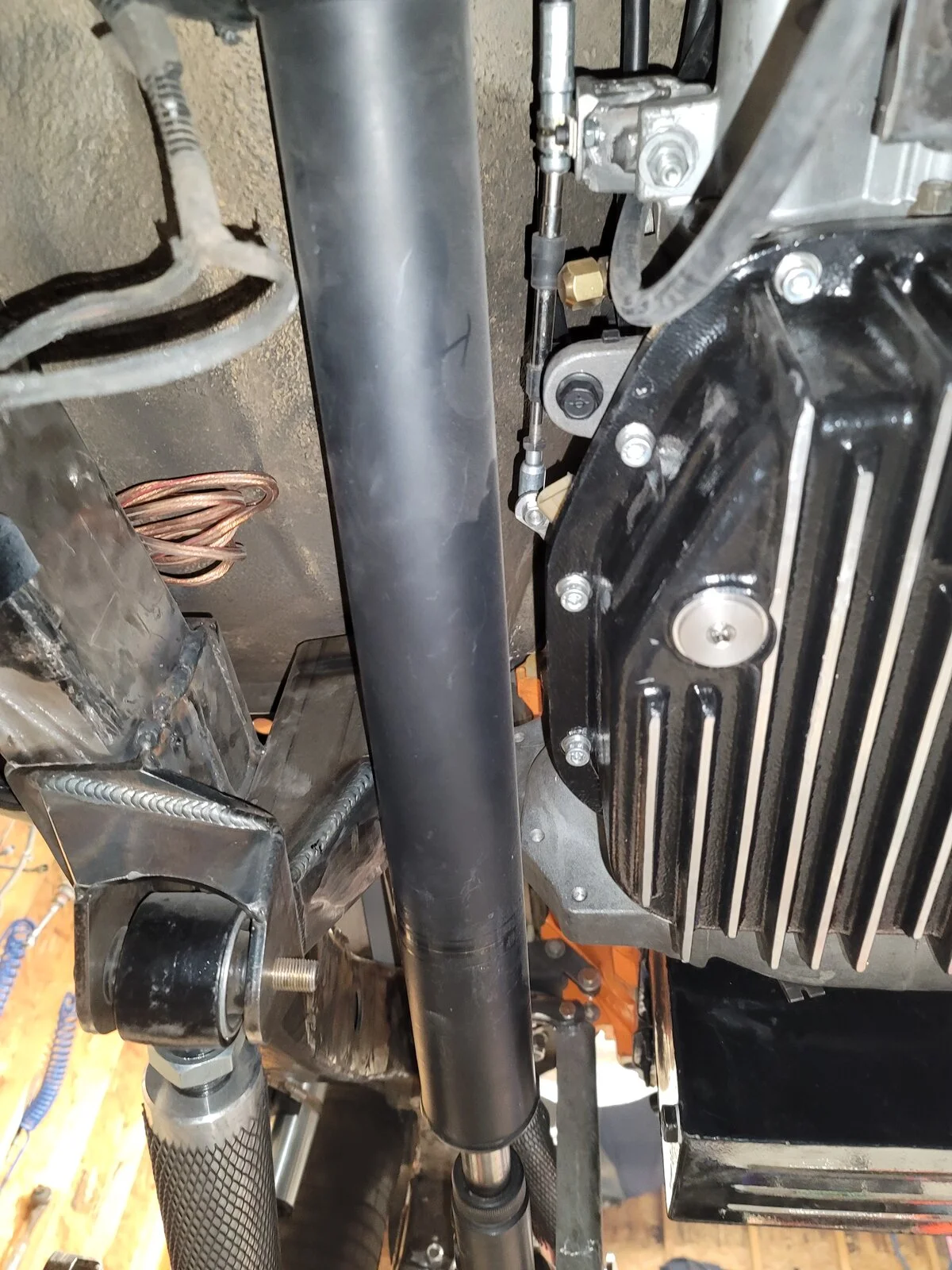

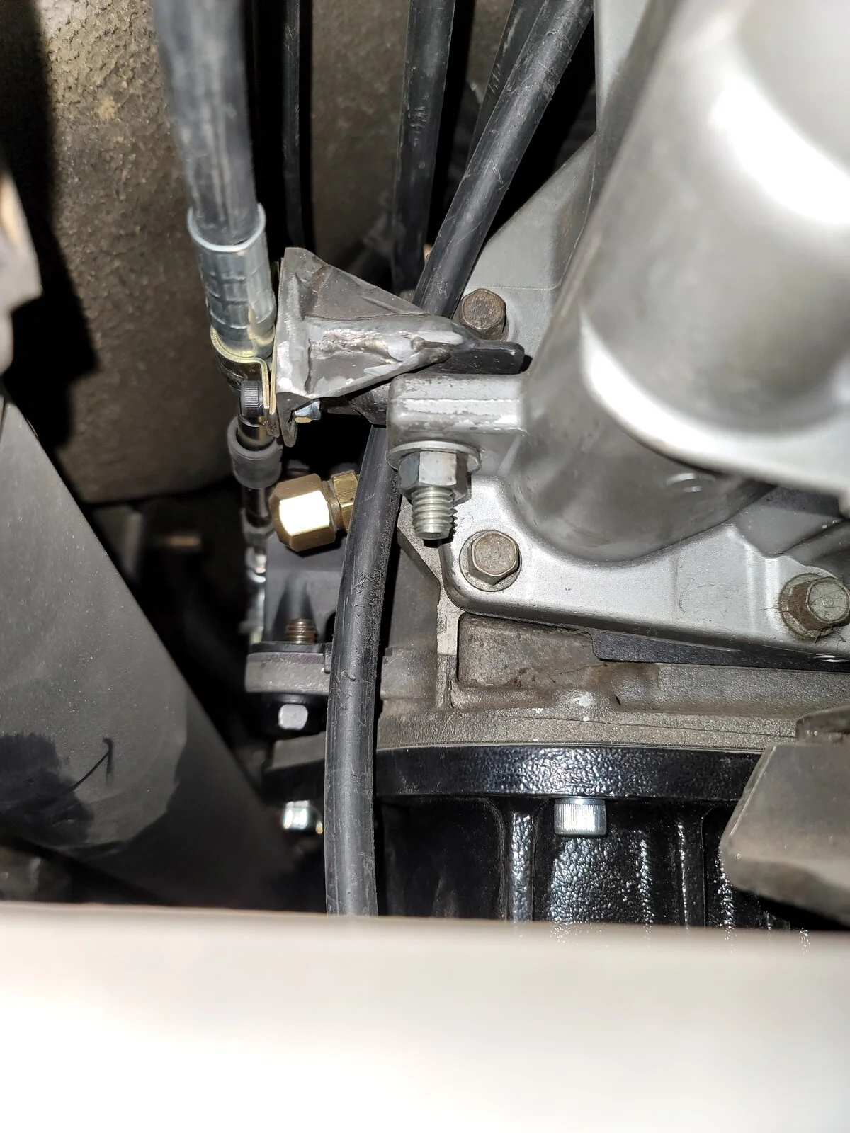

so sounds like there might be doubts about a 300 being offset enough to reach the driveshaft past some auto trans bells, anybody got a guess on how it'd fit against the 42RLE? i read the front output is about 1" less offset than the 231.

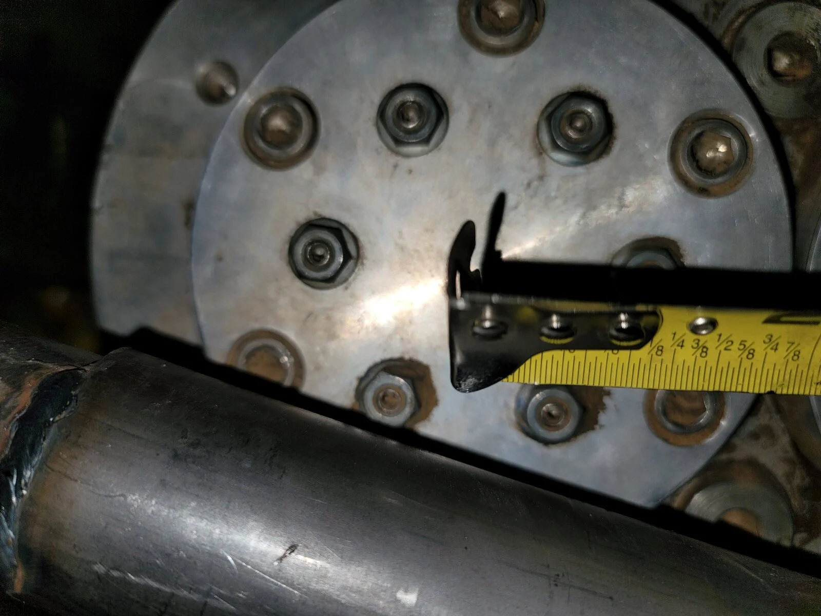

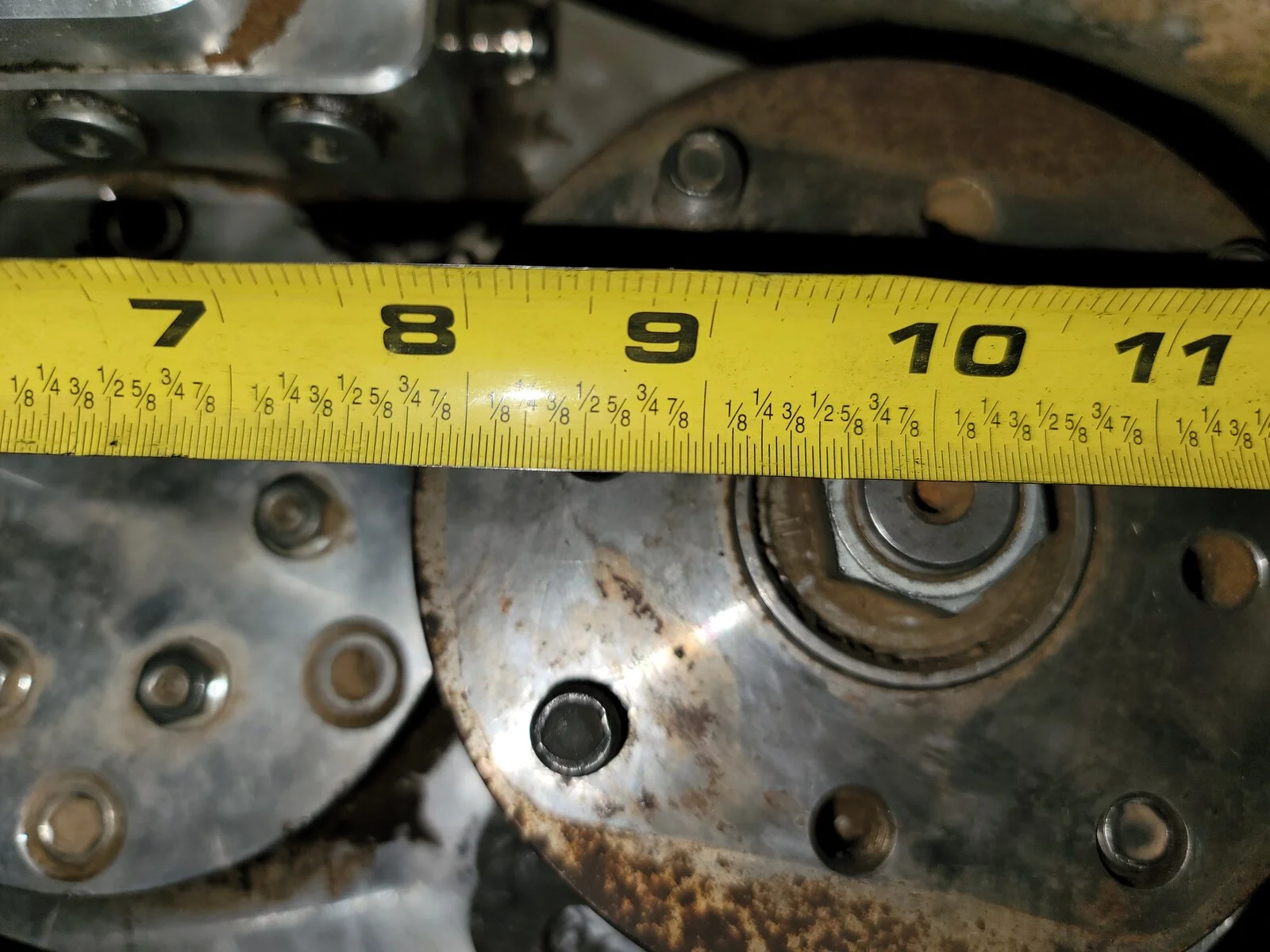

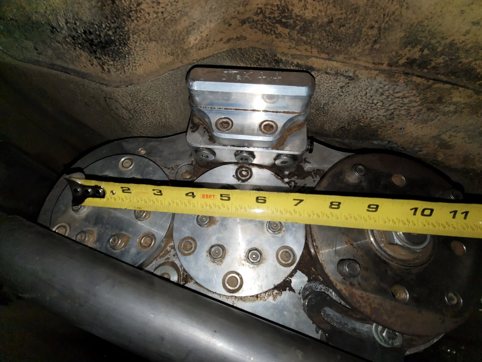

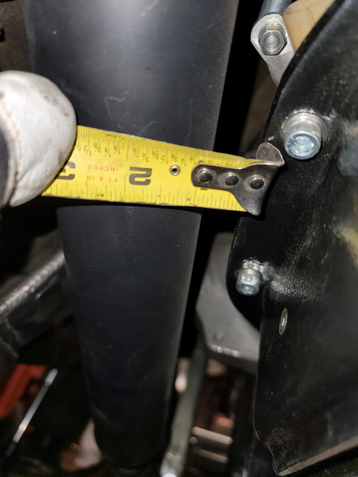

My STaK's is 10" roughly. So about 1.44" wider than the D300.
And then the driveshaft is 2.75" outside diameter.
So a narrower driveshaft would help with clearance.
And 1" clearance between the driveshaft and transmission.
Reactions: someguysjeep

Well I think from the measurements we just looked at that YES it'd be tight fit but it also matters which automatic transmission you run.

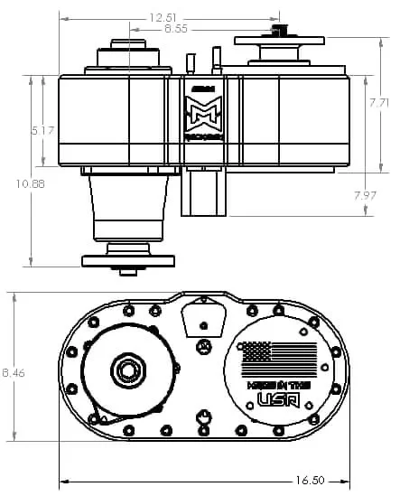

I have an email in to Behemoth for their 205 case dimensions. I will update this post when I get them. The dimension on their site shows it roughly the same exterior as their 300 which I find difficult to believe.
