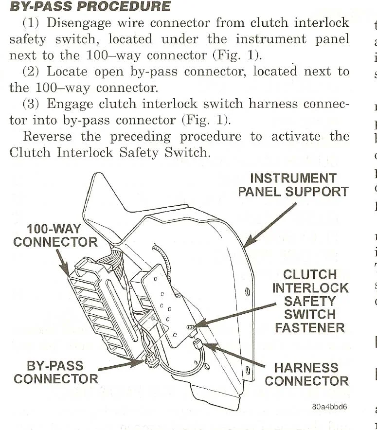

It's just the bottom right fuse IIRC. Might say auto trans?
On the 97 model ONLY you had to move this cable.
Got this from another source.
The clutch interlock override feature was redesigned for the '98 and '99 models to make it much easier to bypass. On the '98 TJ, you simply insert a 20-amp fuse in the socket labeled "Auto Trans" (see page 127 in your owner's manual). On the '99 TJ, insert a fuse in the socket labeled "Clutch Interlock" (page 126 in the owner's manual).

It can be as easy as unplugging the clutch safety switch and using a jumper at the firewall side connector.

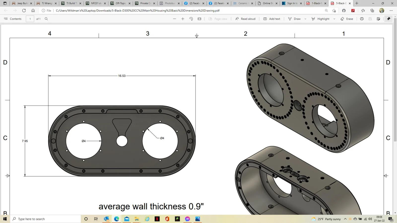

I got the drawings from Behemoth but there isn't a centerline listed for either case.

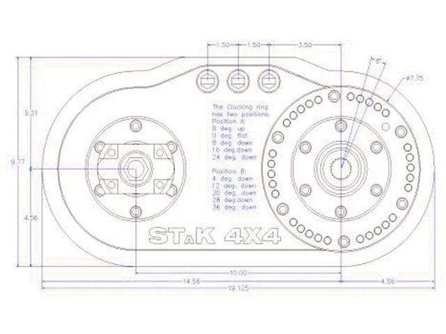

Just for comparison.
mostly eyeballing but based on the height and width being essentially determined by the outer radius of the sides, I'd say that one might have about 8.5" between the centers.
The first one is harder to tell since they machine flats on the ends but I'd ballpark it around 10.

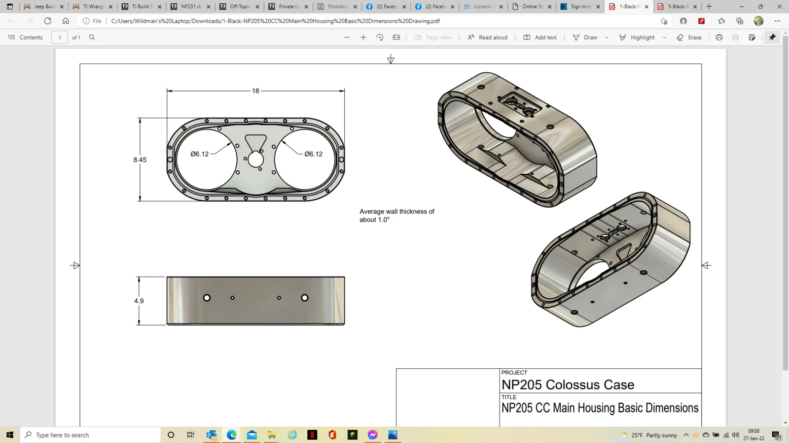

Someone was going to measure a stock 205. They will be the same spread. The BH case isn’t overly large. But the price will make an atlas a better choice. I think they are around $2200 for an empty case.
Someone posted the centerline spread on the D300 and yes I think it was 8.5". If a NP205 comes out at 10" it'd have the same spread as a STaK which is nice.
We all agree it's spendy. I think where it's a better deal is if you already own a NP205 and you've broken one or two stock cases. And hopefully Midnight will come in around the same price on their NP205 case as the D300.

Yes I agree. I have doubts that the aluminum case for the 205 is stronger than a cast case. The 205 is beefy. The only benefit would be the weight savings. If Midnights price comes in around the 300 case price it would be a nice solution other than the 2-1 gearing of a 205.
Well I'm looking and watching as the NP205 would give me close to the same spread if not the same as the STaK and for gearing I'd put a crawl box in front of it. 1.96 & 2.72 & 5.44 is okay but I'd rather have a lower final crawl ratio.
The 205 is probably a good option for big HP and Big tires.
