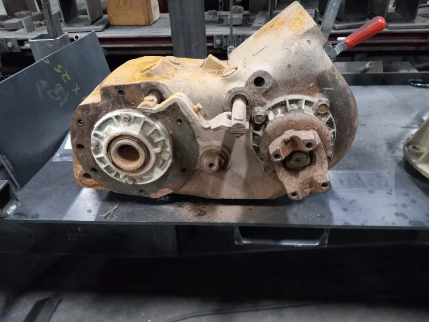

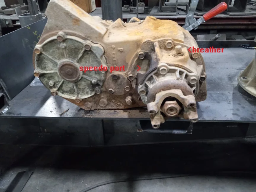

tranny adapters off, oils drained (do have evidence of some water being in there, not much)
this is the Ford NP205, driver drop, 6 bolt round adapter pattern. a couple pics front and back, the speedo hole is in the topside of the tail housing (gear driven) and the breather is on top.
output spread was reported to be 9.5" and is confirmed. front output yoke center to rear output yoke center lengthwise is 16" and it weighs in at 138#.
next is to tear it down. so far everything has come free easily no signs of heavy corrosion or problems getting things loose so far, even the pinion nuts broke loose without any pain.

Mike_H
Off-Camber is scary
Feb 28, 2017
8,670
Grand Rapids, MI, United States
Frogfab says, it's always in stock.
Be interesting to see what's in that giant chunk of casting sitting up above the front output.
someguysjeep
simple guy
Lifetime Supporting Member
Nov 17, 2019
4,816
ohio
it has mounting bolt holes that run fairly deep and do not appear to penetrate the case. by this evidence i'm hoping some of that is able to be cut away.

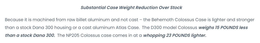

right from the horses mouth (Behe) .......100$ a pound.
23# is all that $ saves us, the rest (doubler) is moot cause it's an add on to everything, now that 23# savings could negate the weight of that add on. but in the end we're buying 23#.
midnights knockin that down to about 75$ a #, maybe?.
