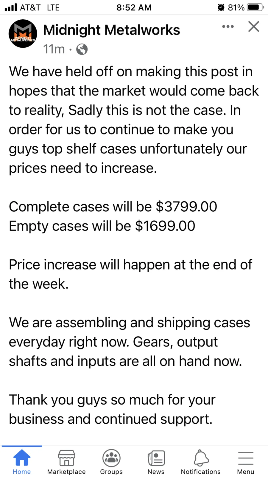

Uh oh.
  • Sad
Reactions: JMT
those billets probably jumped several hundred $, just to stay in the line to get any.
But it is it the beginning of the end? How much will folks pay?
ha, it's already a deep pockets game and always a player that wants the action and a reason the rest of us try to rework salvaged parts.
in my instance i've dropped enough fuel weight to compensate for the stock case, so no way in hell i'd be lookin to drop 1700 on an empty case.
Reactions: JMT and Wildman
More but not the end of the world. Gotcha, thanks. Honestly, I'm just waiting for some real world reviews hopefully from somebody with a TJ and I'll buy one.
Throw in some cable shifters and you are at $4k.
