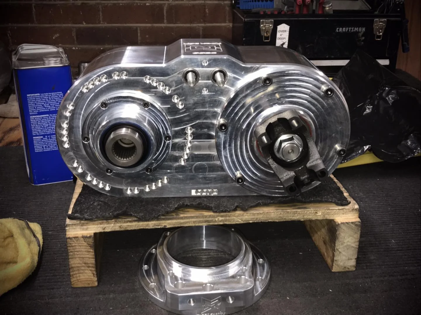

NP231 doubler / crawlbox
it's whole again time to think about the next steps soon. i put the 1310 yoke back on the front output until i make up my mind.
input retainer is temp'd just to hold the bearing, i assume it'll be removed anyway during the next step.
so thinkin about this a bit more i'm gonna slap that 1350CV yoke over to the front output and pick up a 1350 dual pattern flange for the rear, that'll give me the option of a pinion brake, if i choose later.
Reactions: NashvilleTJ
i got that rear output flange and i'm makin up a rotor to fit the backside of it to make up for lack of E brakes in the hat. still needs turned to be finished up but i wanted a test fitting. don't mind my cockeyed paint job. that'll get turned round when its surfaced. not meant to be an emergency brake really, just a parking brake. now to find a mechanical caliper and make a bracket.
