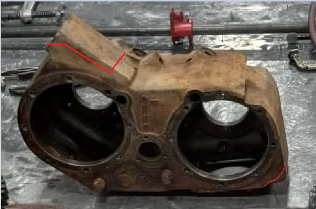

doesn't look like much stripped down, 6" long and 18" wide. got the inside pretty clean today, need to remove the PTO cover and it'll be ready for the saw.
not happy with the looks of the aluminum bits , but IDK if i hate it enough to spend $ for something i'll never hope to see very often.
made a few cuts today, they cut the lights off on me b4 i got pics, so Mon after some clean up grinding.

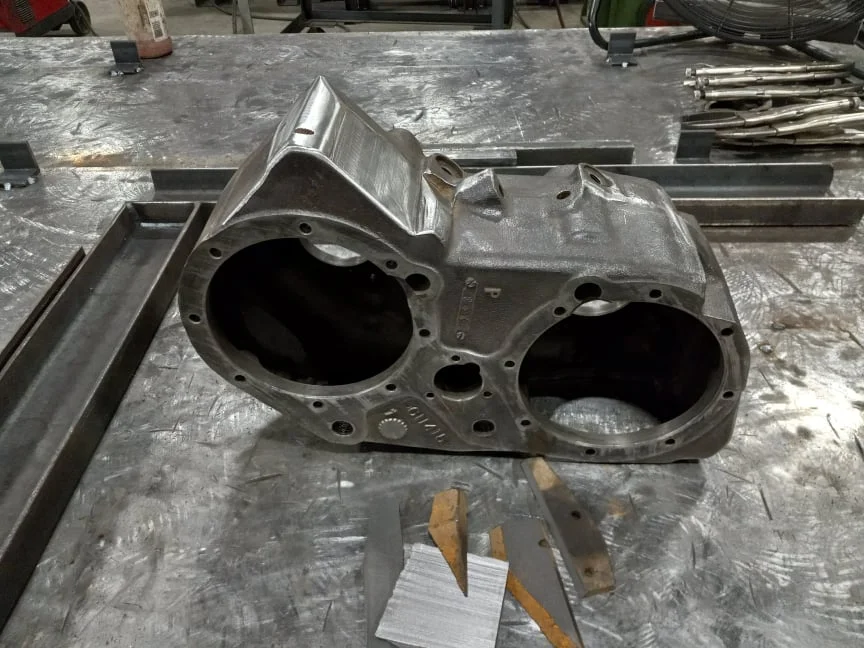

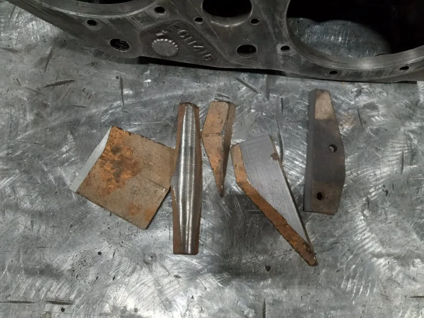

i took all i could without breakin into the case, it's was almost 2# of material. taking the rest of that boss would only net another 2#, not worth crackin the case for. now if room becomes an issue then maybe it's a venture to pursue but right now there is now reason to push further.
this is basically what i took off.

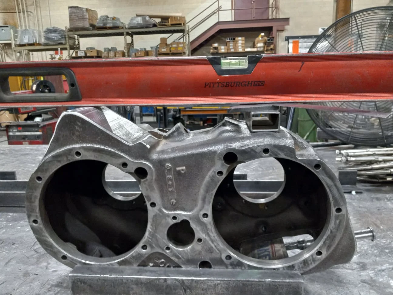

case is cleaned and ready for new paint i took almost an inch off the crest of the boss. with the case set level it's a 1.25" difference.

see those 2 oil plug holes in the case? see how they are now down very low if the case is flat, either it has to be filled b4 install or it needs a new fill hole up higher, clocked flat those both become drain plugs.
northwest fab does offer a PTO cover with a fill plug, but that also assumes it's not goin truely flat or it's in the bottom too. these cases are meant to run with that driver side drooped down a bit and that boss would be pulled down away from the body in the process.
at least thats how it looks right now.
How did you make the cut?
the shops vertical band saw, went through like butter. that way everything is squared off those flat faces also.
a good 1/2" off that boss is angled F to R if the case is sitting as flat as it can upright , the center chunk kinda shows the slope.
