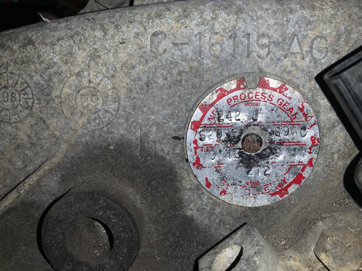

I just picked up the transfer case yesterday for $100 that came off a '01 XJ with about 100k ish miles. not too worried about mileage since there really aren't any parts to be worn down. took some pics of the tag yesterday and once i get off work ill send some more.

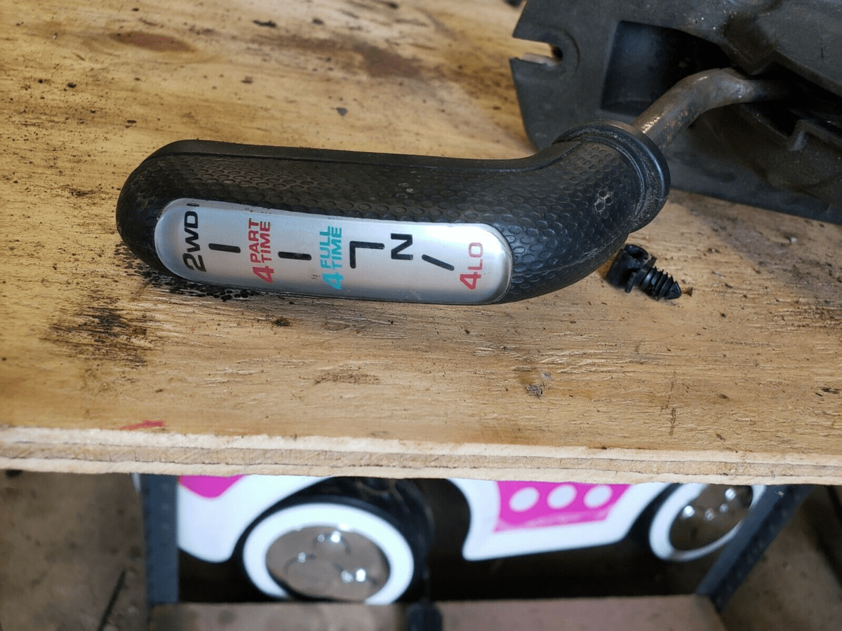

Here is a picture of a KJ (Liberty) shifter for a Select Trac t-case.

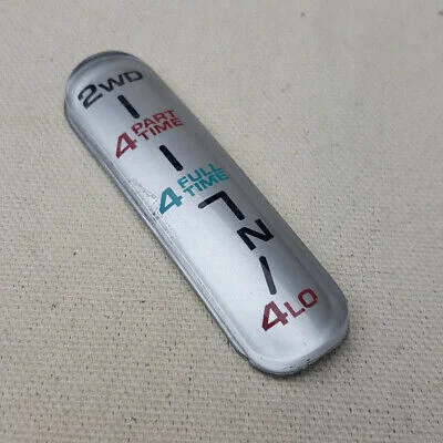

This from the Ebay listing is from a 2002-2004. Here is the Ebay listing.
https://rover.ebay.com/rover/1/711-...0001&campid=5337789113&icep_item=233451004799
Now if it will work in a TJ I have no idea but it would be worth a shot.
The other possibility would be to get JUST the shifter guide plate and glue it onto the stock shifter?
From what I understand the issue was that the TJ shifter didn't have enough room for the extended throw needed to hit the additional gate. But I know from having the Tera 2Lo before that it took a lot of trial and error to get the shifter JUST RIGHT so it could hit that additional spot.
The part number for the KJ shifter is: Shifter-Transfer Case - Mopar (52128942AC) and it is still available if you wanted to buy a new one.

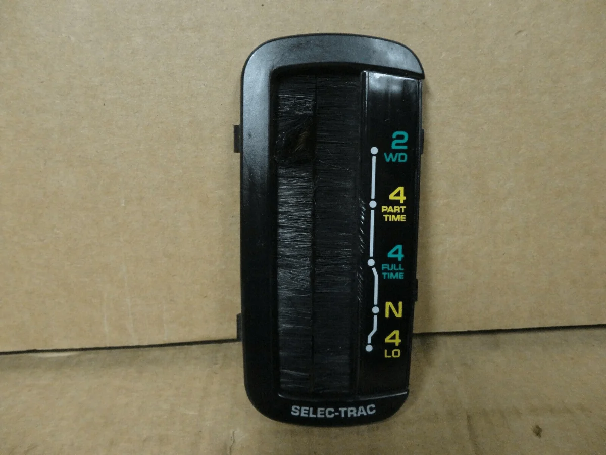

Yes but none of those bezels are going to work in a TJ unless you hack up your stock console and somehow put one into it.
This one is from a XJ so I'm not sure how you could get it to work in a TJ.

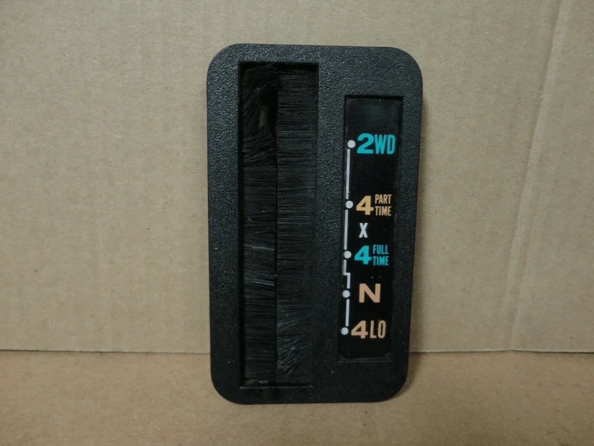

This one is from a ZJ and again I don't know how we would get it fit in a TJ. I still think using a KJ shifter handle or at least the shifter guide plate is the best bet.
