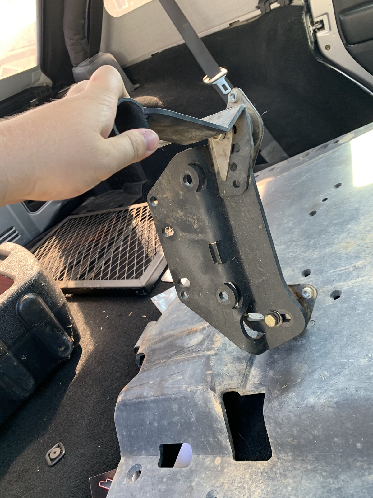

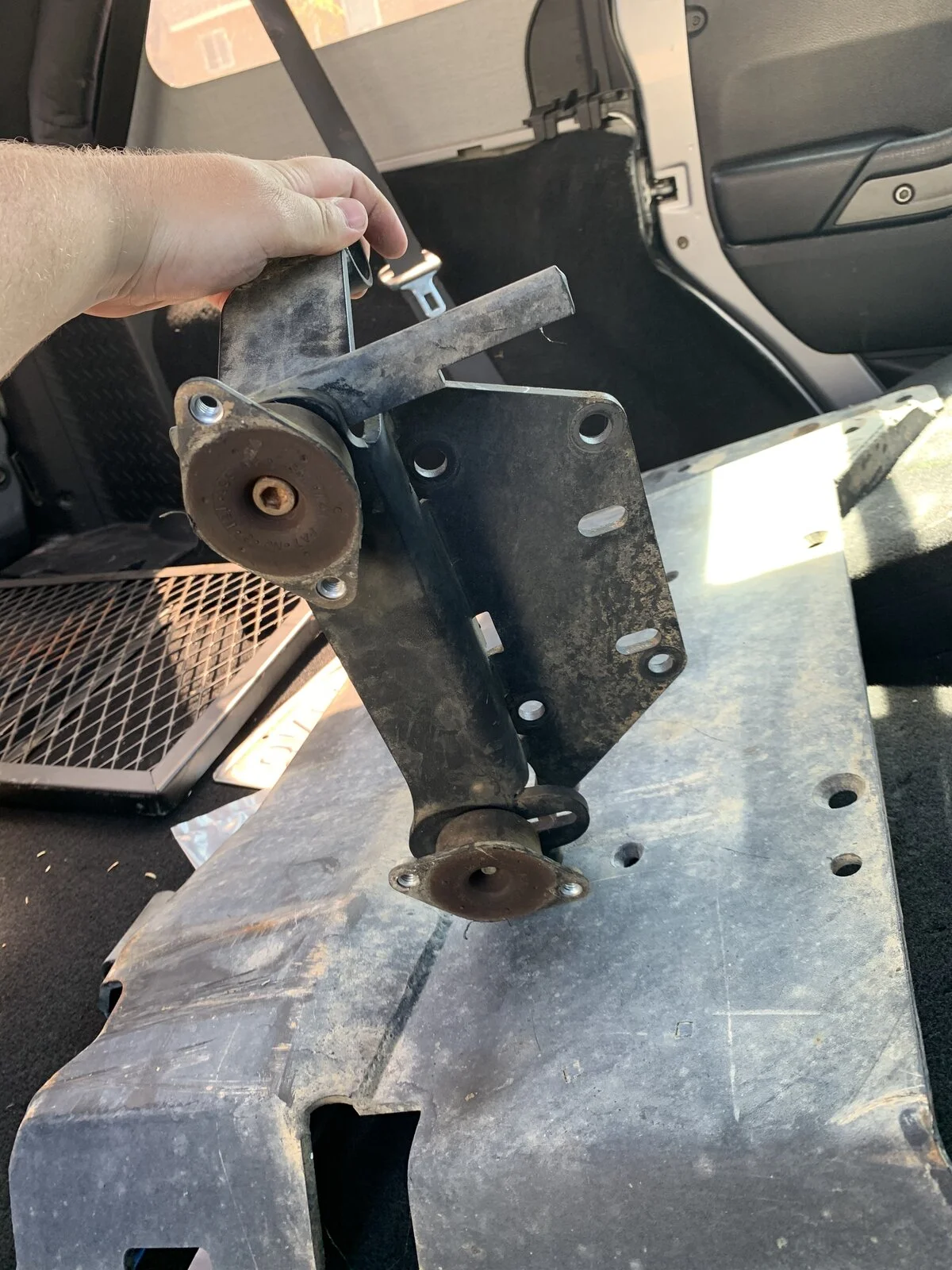

New to forum and to forums in general. Hopefully this is the correct place to post with my question. I came across ToddL’s post while searching for information on the Nth degree tummy tuck. I picked one up not too long ago but it came with the automatic transmission mount. My TJ has the NV3550 and I plan to add this on my Jeep along with a Rubi transfer case. I’ve been looking for the past months for a manual mount to come up for sale but had no luck. I was wondering if anyone would be willing to assist me with measurements off of there’s so I can fab one up. Thanks and appreciate any help!
I have the Tummy Tuck which has a unique transmission mount. Wondering if anyone has found a source for the rubber isolators.
Hello,
Do you still have the manual transmission mount for your Nth skid? I’m looking for measurements so I can fab one up. I recently picked one up but unfortunately the skid came with an automatic mount.
I would greatly appreciate the help!

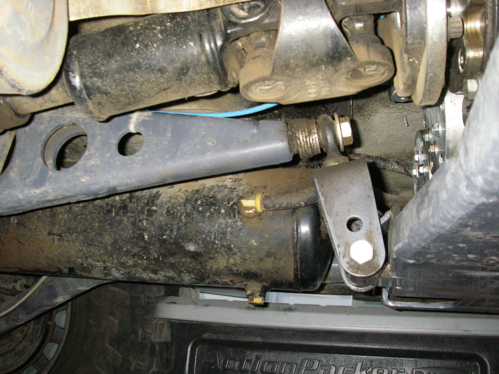

Anyone know where to find the rubber that goes in the inverted C shaped piece from the pinion arm to the skid plate? Looks to me like it should have a tube inside it, mine doesn't and the rubber is in need of replacement.
Have some of the Nth Degree installation manuals.
Al in Tucson.
Al in Tucson.
Get on the list with All J they are working on them.
Al in Tucson.
The early style were CJ shackle bushings without an inner sleeve. The later style were YJ shackle bushings with an inner sleeve. You can tell the difference by the OD. The OD of a CJ bushing is 1”. The OD of a YJ bushing is 1.25”. You can purchase either anywhere that sells automotive parts.
Nth Degree uses the same bushing a stock control arm does.
Thanks for the tip Daryl. Ordered a set of Moog bushings. I made it a hard job by trying to install them without removing the arm! In the end I had to remove them to press in the new ones. Could of saved a lot of time if I had removed them first!

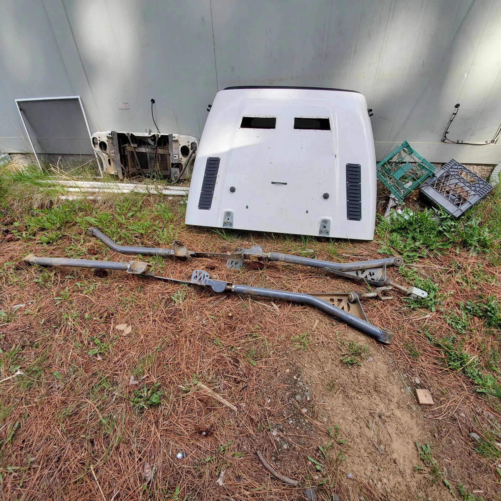

Sure wood like to have some Nth degree TJ suspension left overs. In any condition. Preferably not broke but will look at what you have. If anyone knows where I could find some. Send me a message.
I have no idea what it would cost to try and ship the front and rear arms from WA to GA but I'm sure it wouldn't be CHEAP.
I've also got the brackets and stinger setup for a HP60 rear axle.
