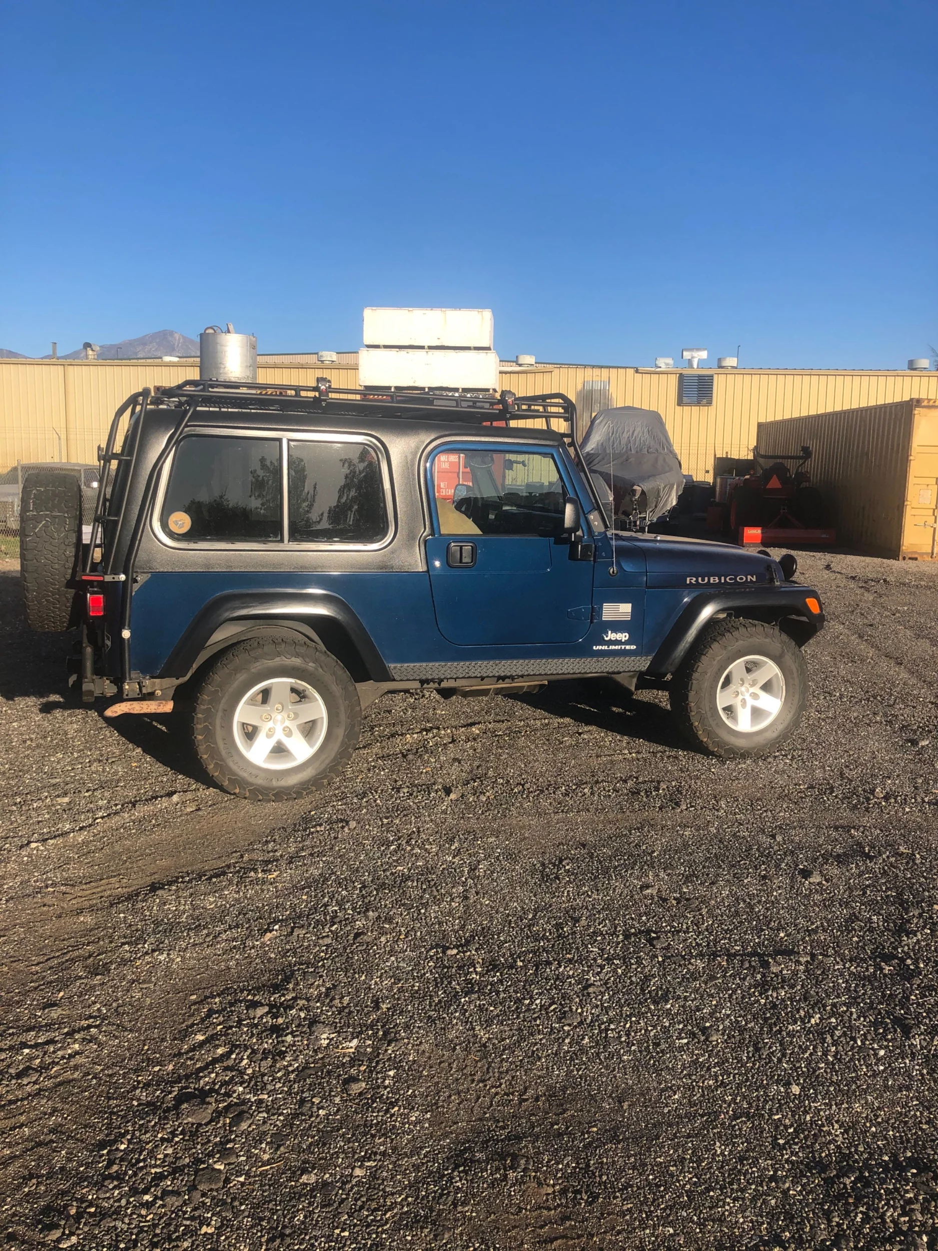

I ran 2933/2942 and got about 2”. Then I added a 10mm spacer, then removed that and went with a 1.5” spacer. I thought long and hard about a 2934 up front. If I’d wanted to stay around 2.5” I would have done that. No way to know exactly what they will do on yours. Everyone weighs differently.

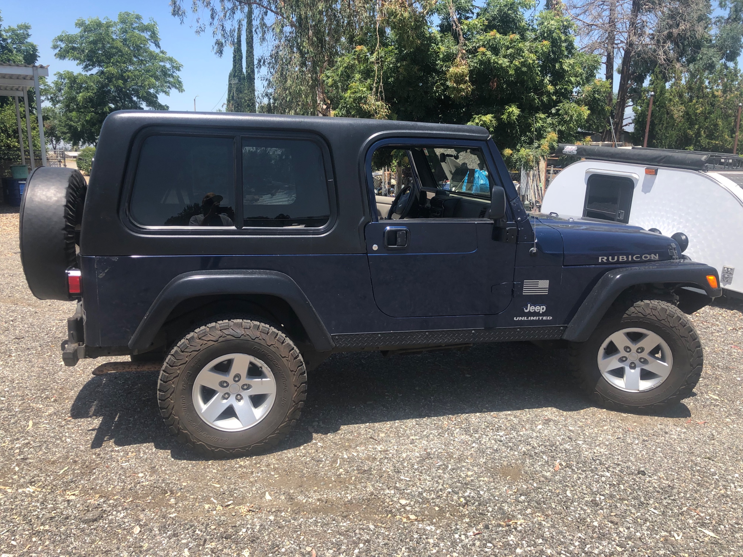

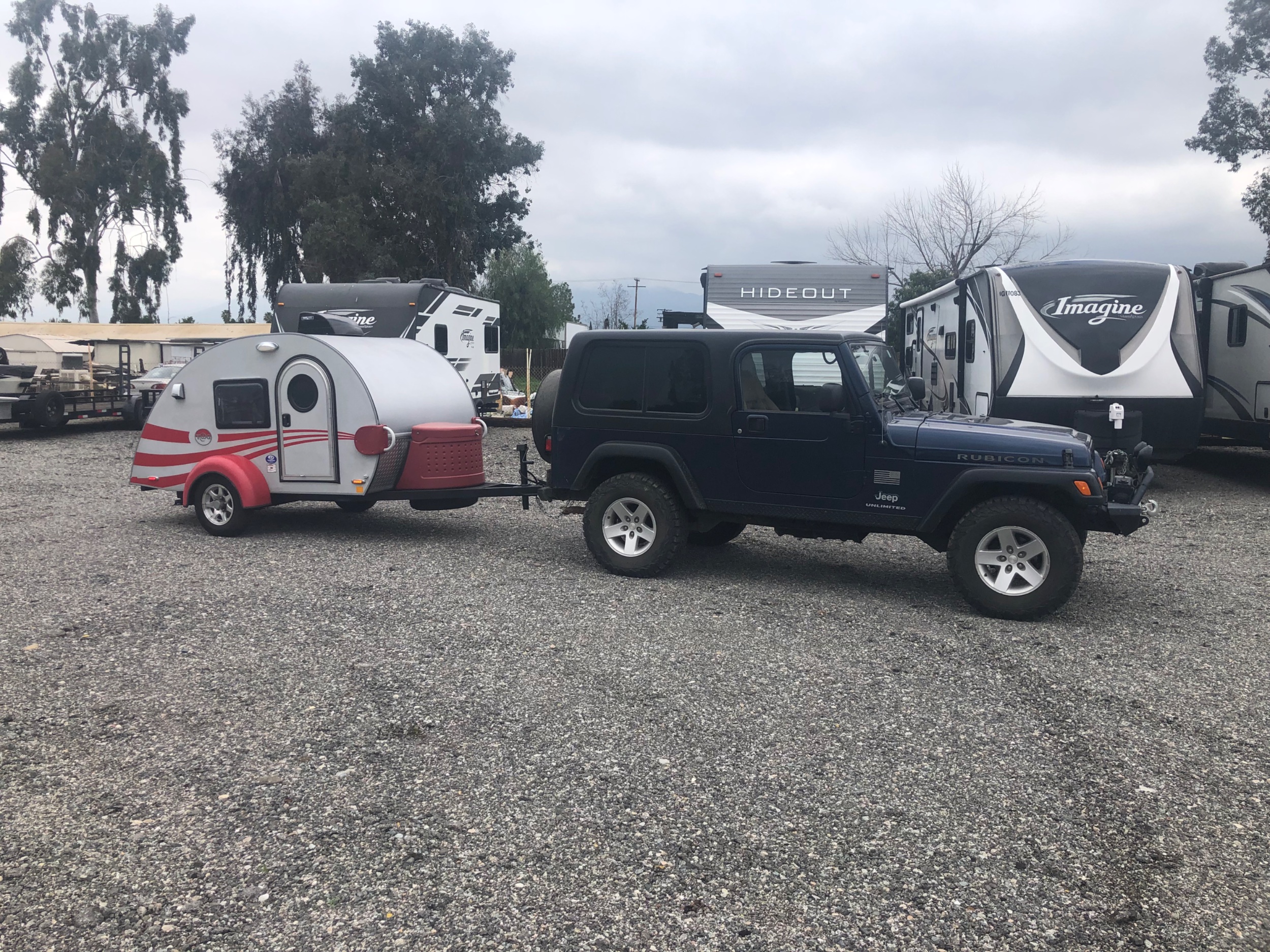

PO installed a OME 2.5” lift on my 05 TJR Unlimited hard top running 32s. I don’t know which rate they are. The ride quality unladen is great with no vibration. I pull a 1200# teardrop with 200-300# of gear in the TJ. Ride and handling at 70 is great when loaded.

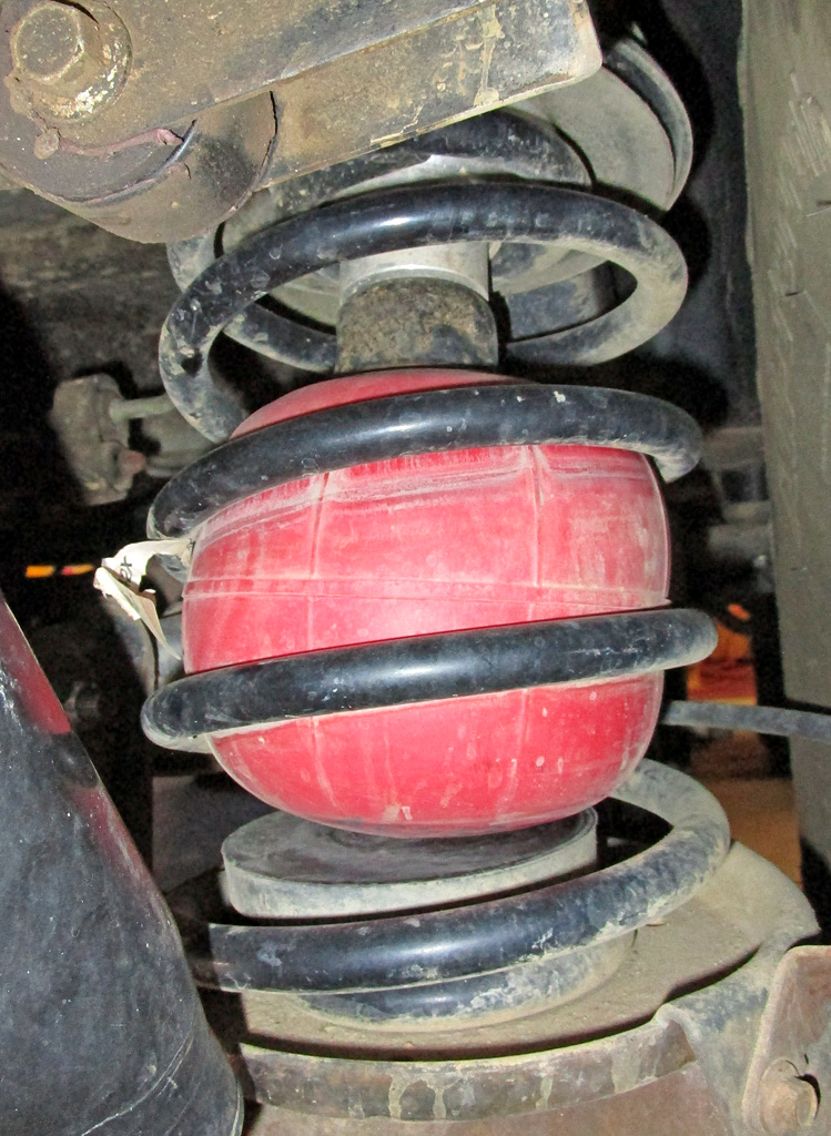

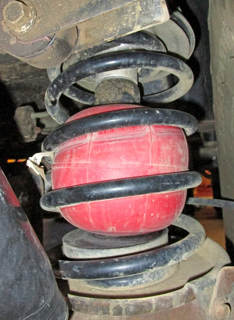

Has anyone ever used OME springs in conjunction with an appropriately sized air bag to account for varying weights - like a lighter spring to support a unloaded Jeep, then pump up some bags for when towing a small trailer? Curious if anyone knows a suggested part number off the top of their head.
I use OME 2" lift springs with AIR LIFT 60811 1000 Series balloons. I keep them at the minimum 5 PSI except for when I'm pulling my heavy trailer, then I use about 30 PSI. They keep everything level. My bump stop cups sit just slightly above the balloons most of the time (with an extender), with NO jounce pad (the balloon is your new jounce pad). Be sure to file your bump stop cup rim smooth so it doesn't cut the balloon.
These have worked great for the 3 years I've used them. They're fine offroad too, with full articulation of the rear axle.
