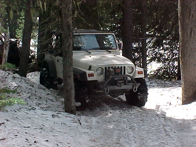

I could get my 4 angry squirrels to do 65-70 MPH even with the heavy 33" TSL Boggers on the Jeep. And I had a Warn 8274 winch on the front too.
Funny story, I found out REALLY fast what NOT having a good ground on your winch does. My brake lines were glowing and the winch wasn't working anymore. Added a GOOD ground between the frame and the battery and Wala the winch worked great.

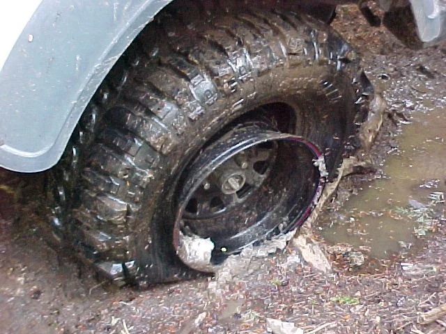

BTW Boggers are NOT a good snow tire without some sipping. And metal rims don't hold a bead as well as aluminum rims do.
