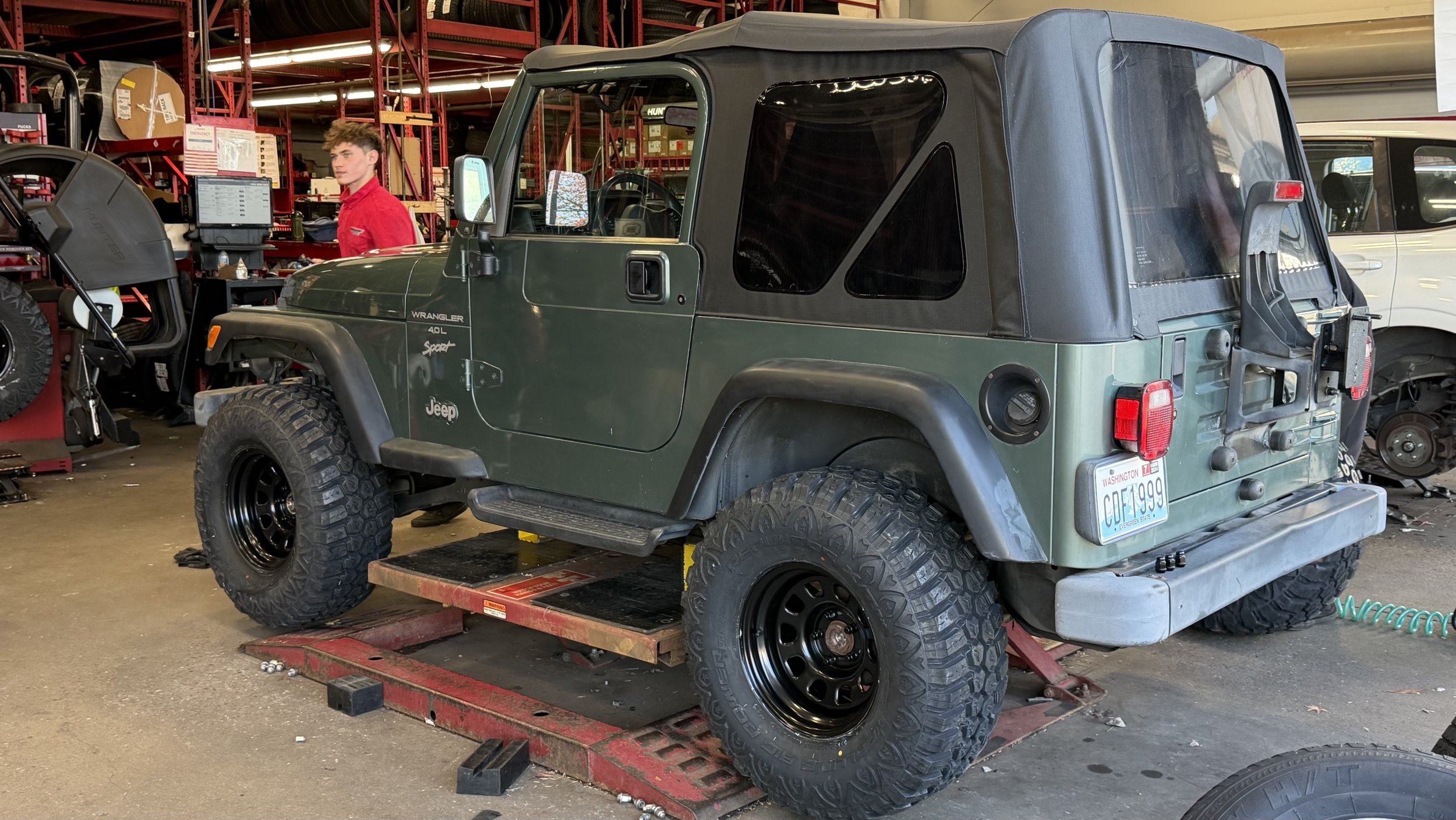

Here’s a picture for fun:
33s on stock suspension? 🤔 When I had a 2" lift, I did coils, shocks, bump stops, rear track bar relocation bracket, and a MML when I had slight vibes. That's it.
