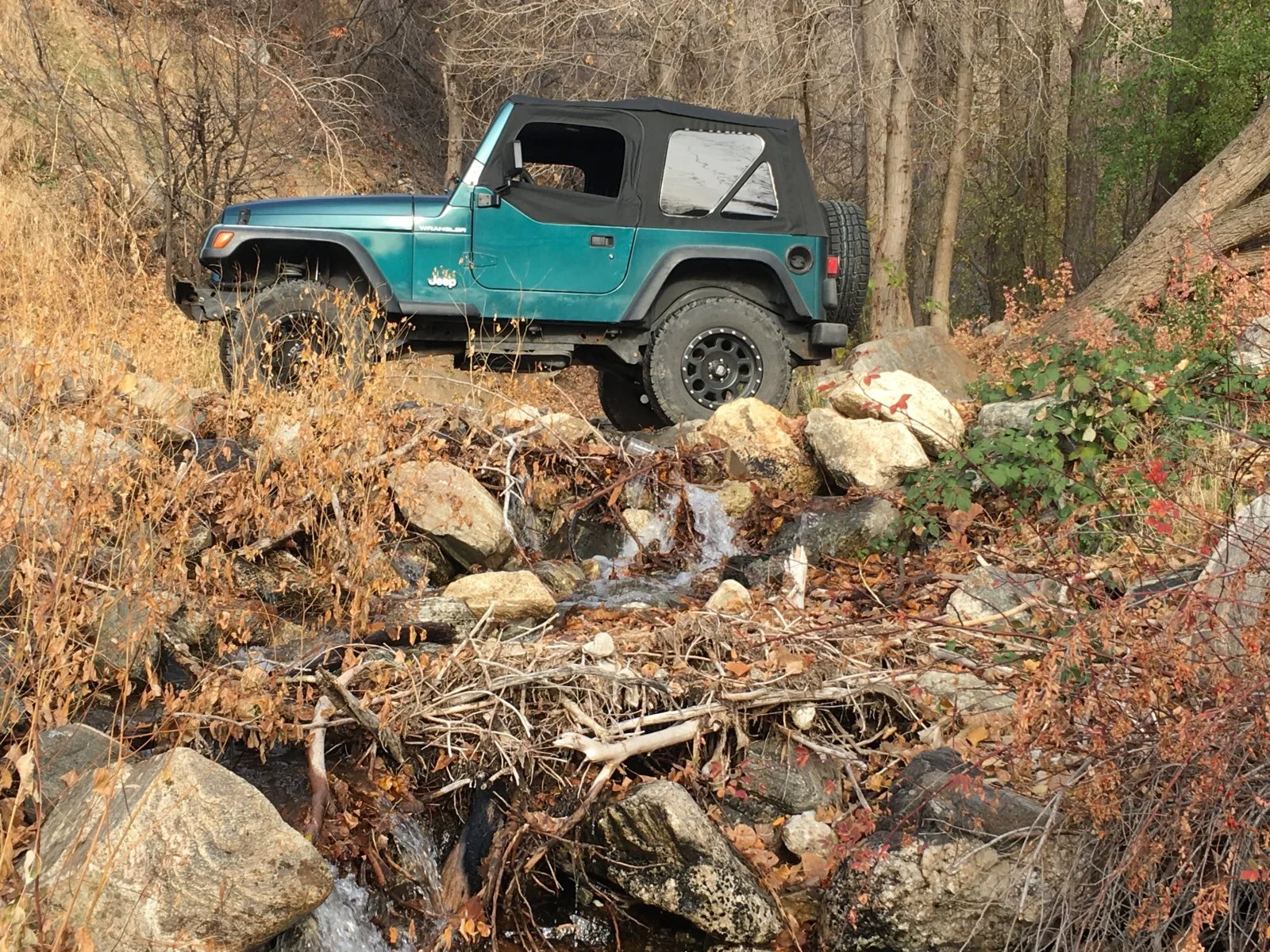

Oh man, this is an expensive one, but if it was me, I think I'd get rid of the factory low hanging skid plate and get a tummy tuck!
Looks like you've got a transfer case drop on there as well, so it's even lower than normal! I believe @StG58 has some knowledge on which skid plates will work with the SE model Wranglers.

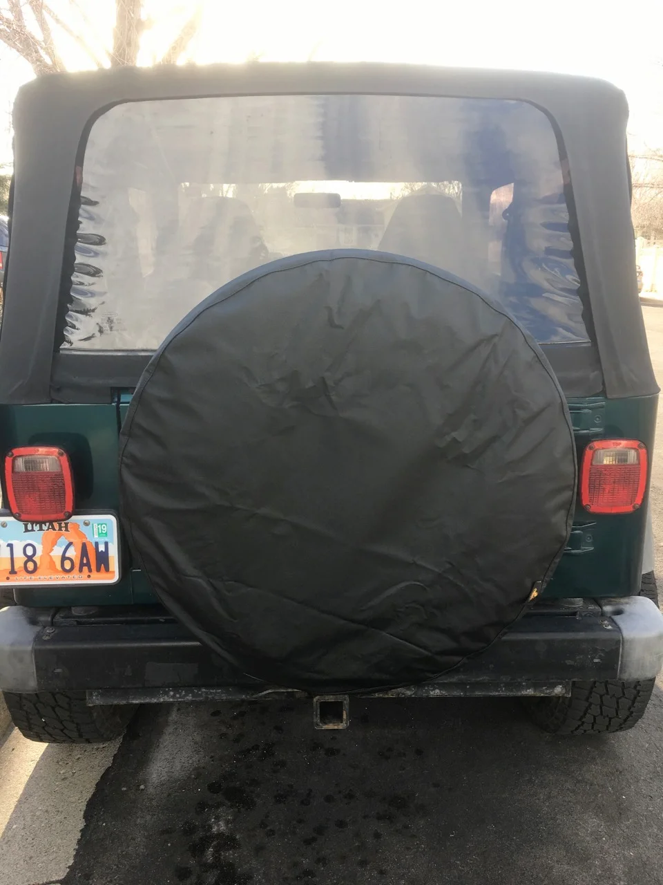

Really like the wheels on there, is there a matching 5th wheel and tire?
Thanks! Its the same size tire, different wheel, but its pretty similar looking. According to the previous owner, he looked forever to find a match and this was the closest he could get.

@Chris is correct, there are not a ton of skid plates out there for SE's, especially the automatics. Check out UCF and see if you like their offerings.
