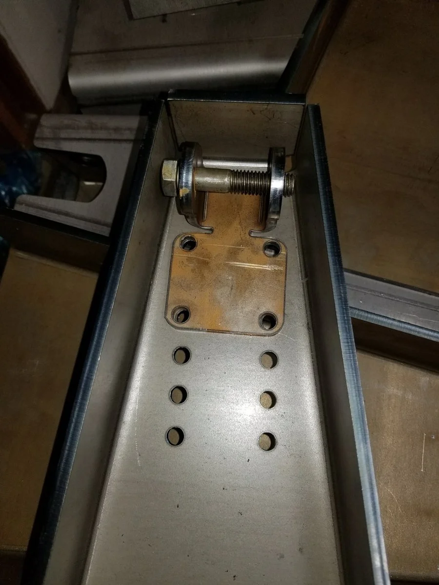

Since this is theoretical, Back in the days when outboarding rear shocks was new, I saw lots of write-ups using ford towers and various shocks. It could be done easy enough. However, as tworley said, the mounts are completely incompatible. If one were handy with fabrication you could probably have a bolt-on shock mount that could be swapped out when you upgraded. JeepWest does something similar to allow for different shock lengths or ride heights. If this isn't something jeepwest built, my apologies.

I think you're right, that is a jeepwest design.
The problem using those mounts (in my opinion) is that the increments are to large. Very fine adjustments are needed, otherwise you can lose travel with those mounts. The poly mounts can be burned in exactly where the shock is going to be safe and not over compressed.
That is most certainly Dave's design. And a good one at that.
