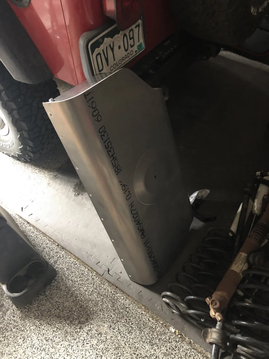

Typically I’m pretty stoked that I don’t have a commute as it takes me a month to burn through a tank of gas. However right now that is less than ideal since I want to drop my tank soon to fix the filler plunger problem (not the filler neck) and install this bad boy. I filled up last week, so I’m a bit out from wanting to shove my hand in gasoline.

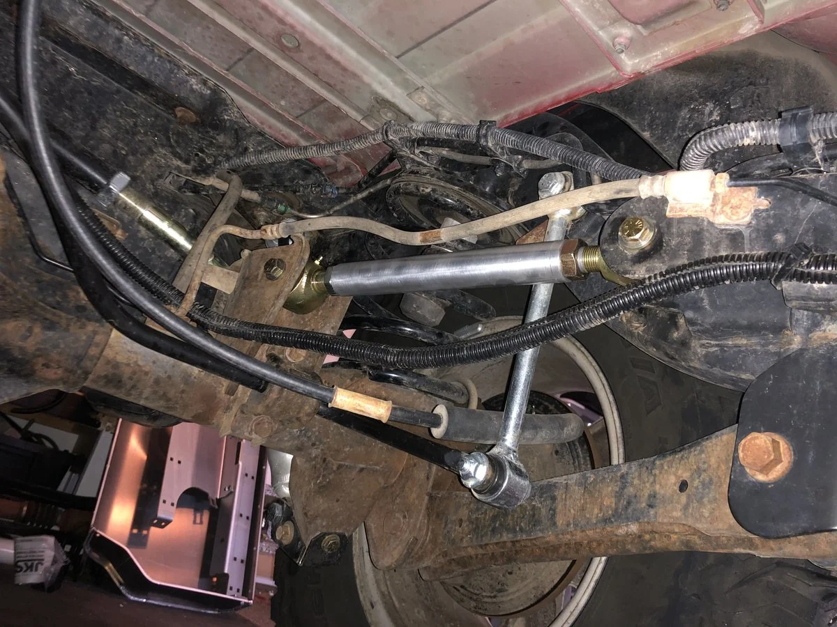

After a lot of back and forth with savvy, the arms are in! Just had to drill out the bolt holes a small bit in the mounts.
As you can see in the picture, I really need to think about the bottoms, the bushings are pretty gone.

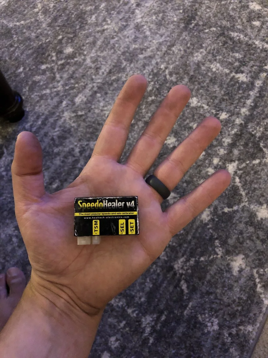

I had no idea how small the speedohealer was, apparently I’ve never seen it in any perspective shots.
it’s definitely pretty solid feeling, so now to read some wiring diagrams to not fry the PCM.

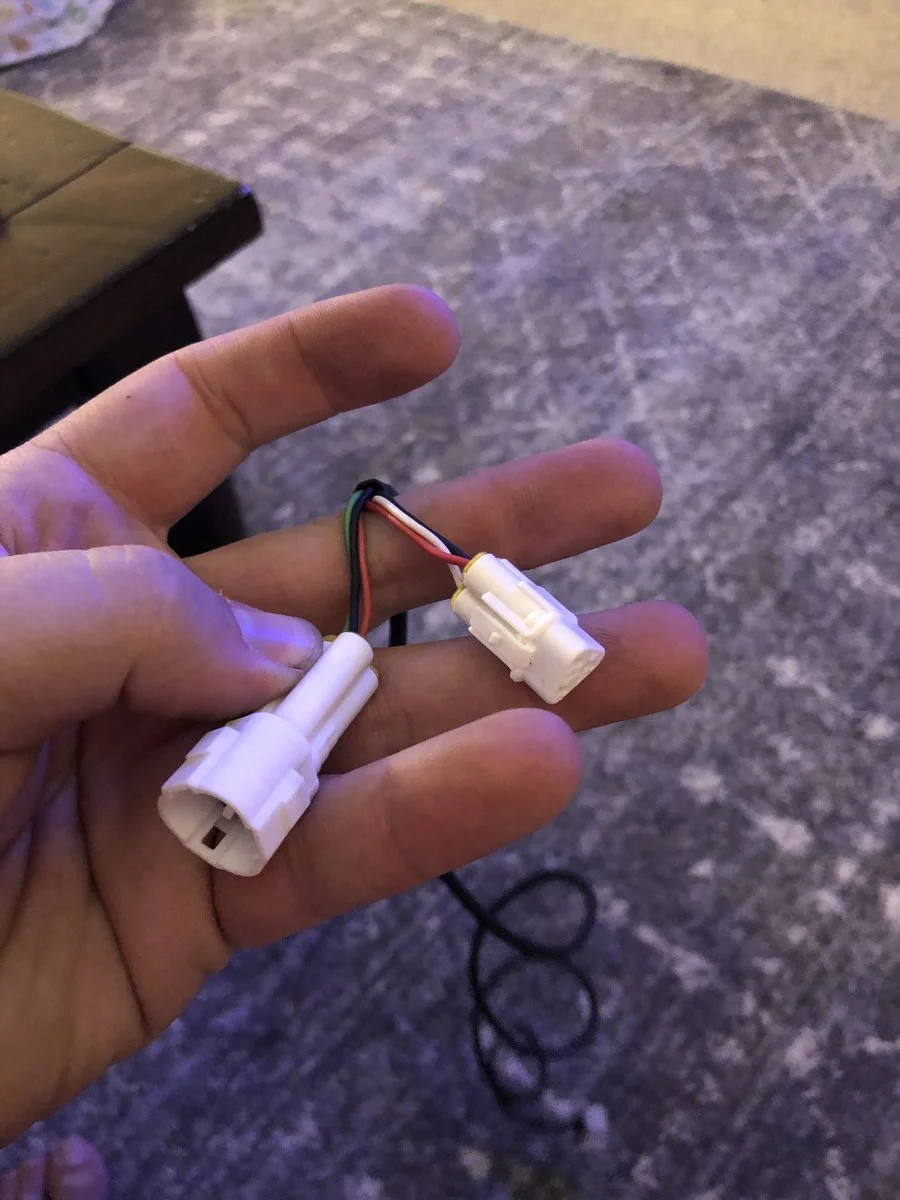

I think mine is from a GXR and am guessing the female plug is the input from the sensor and the male is out to the computer

If you get a chance and don’t mind, can you get a picture of the cable at the transfer case? I’m fairly confident of red (power), Black (ground), green (data from TC) and white (data to PCM). I’m assuming they keep consistent wire colors across machines...
