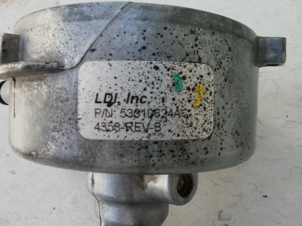

Interesting thing I found out. So, when I took the old OPDA out with the holes aligned I noticed that crank pully was not lined up at TDC. It was assumed it had just slipped in the past given its age. I noticed my new OPDA was turned noticeable more after aligning to 0 degrees than the old one. So, I removed the black cap off the new OPDA and turned the engine until the holes lined up. Then when I checked the crank pully it was almost perfectly lined up at TDC. So, it hadn't slipped. The old OPDA just wasn't installed completely at TDC. So, always check and don't assume the old OPDA was installed correctly.

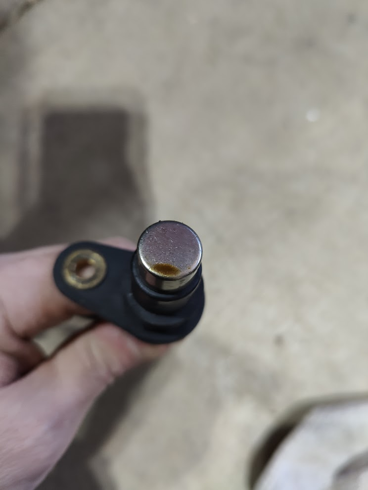

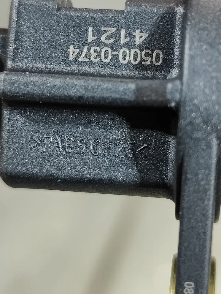

I thought it was around that. It must just show one when it loses the signal. So, I put the NAPA sensor back in and drove it around for about 20 minutes. It stayed in sync the entire time, and I watched the difference move up and down with the rpms. It never just hit one and stay there. Maybe the Crown sensor is bad, or the plug wasn't making a good connection. Fingers crossed this fixed it. Wife and Kid ( his Jeep ) are ready for me to take it to a shop as he drives it back and forth to school each day. And pulling out into traffic and it deciding to go to limb mode isn't real safe.
I did notice the Crown OPDA has a much tighter fit for the sensors than the old Dorman one. I could remove and install the sensors easily on the Droman. They would just slide right out or in. I had to really twist and pull / push to swap in the NAPA sensor.

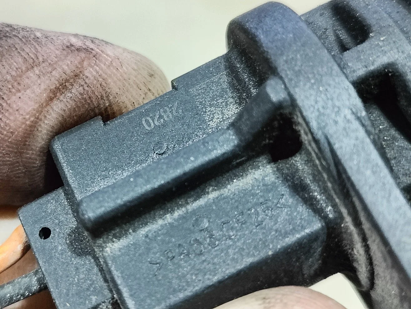

I don't think it is the crank sensor. I am pretty sure it is the actual connector for the cam sensor. It did it again about an hour ago. So, I decided to connect the scan tool up and watch it. As soon as I touched the connector I saw it hit 17 degrees and go out of sync. I tested it several times and if I grap the connector even without moving it much it goes out of sync. I never saw the degree change like that again, but it goes out of sync. I figure it just jumps to something to quick to show up. Moving other wires like the ones that go down the toward the dip stick don't cause that. I also noticed once it goes out of sync the degree is stuck. It always shows the last reading like 0.6 or whatever. Maybe once it goes out of sync the PCM doesn't care what it is anymore and stops reporting it. I also unplugged and replugged the sensor with no change.
So, I think it must be the female connector on the harness as I have tried three sensors now, and I wouldn't think all three are bad. I am just not sure if it is the connector itself or the wires where they go into the back of it. When I tested the wires earlier with my volt meter I didn't find anything when moving wires around. So, I am thinking the female plug is not making a good connection with the male plug. I plan to work on it more this weekend when I have more time and daylight to determine exactly where the problem is. At least I have something to trouble shoot now.

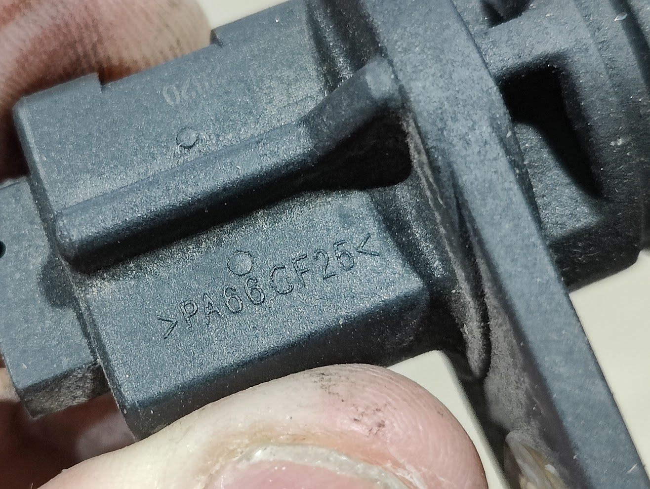

Assuming I need to buy the female connector, is their recommended brand? I found this one at Amazon.

I installed the new connector. My wire connection is in the thick part down near the 'T' intersection. I zipped tied the connector to the AC line due to having a lot of extra wire now and deciding to keep it away from the heat from the engine. Drove it around the block and it was fine. Maybe that finally fixed it.
If anyone ever needs it, here is the wire colors going into the old connector.

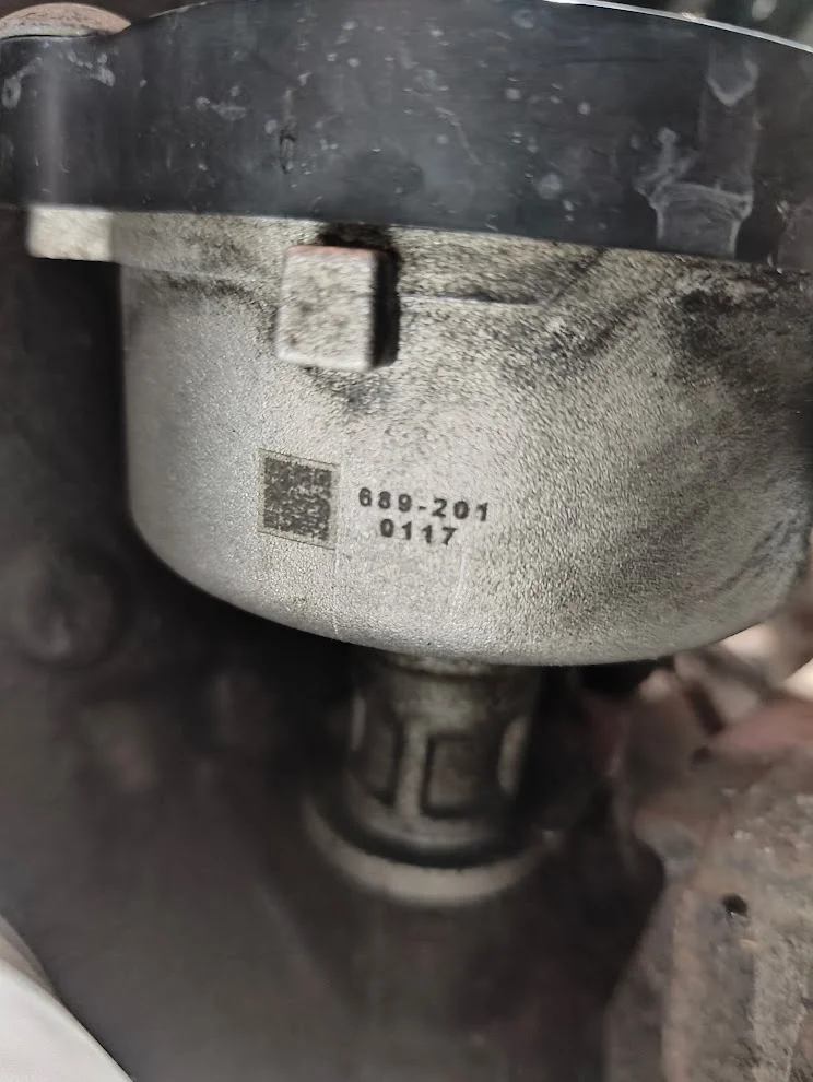

I did notice a sound coming from the new Crown OPDA. It goes away when I put a little pressure on the top of it. It is fully seated and not leaking any oil around the base and the bolt holding it in is tight. I put maybe another 1/4 round on it, but it didn't change anything. I removed the top and there is no up and down movement like the Dorman had. Maybe it is normal or just breaking in to match the cam wear.
