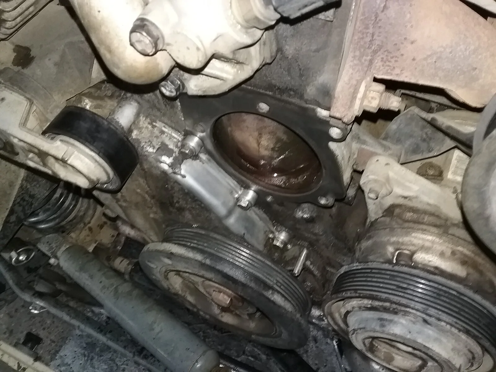

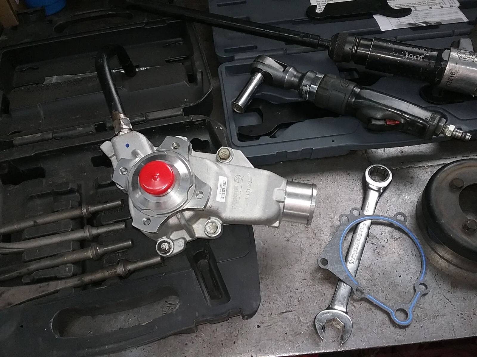

Today was water pump changing day. Fairly uneventful. Replaced both hoses and serp belt while I was there. I always have a hard time burping the system. Just about took a finger off on the fan when I carelessly reached for the upper hose to squeeze it. A job's never complete if blood isn't drawn, right?

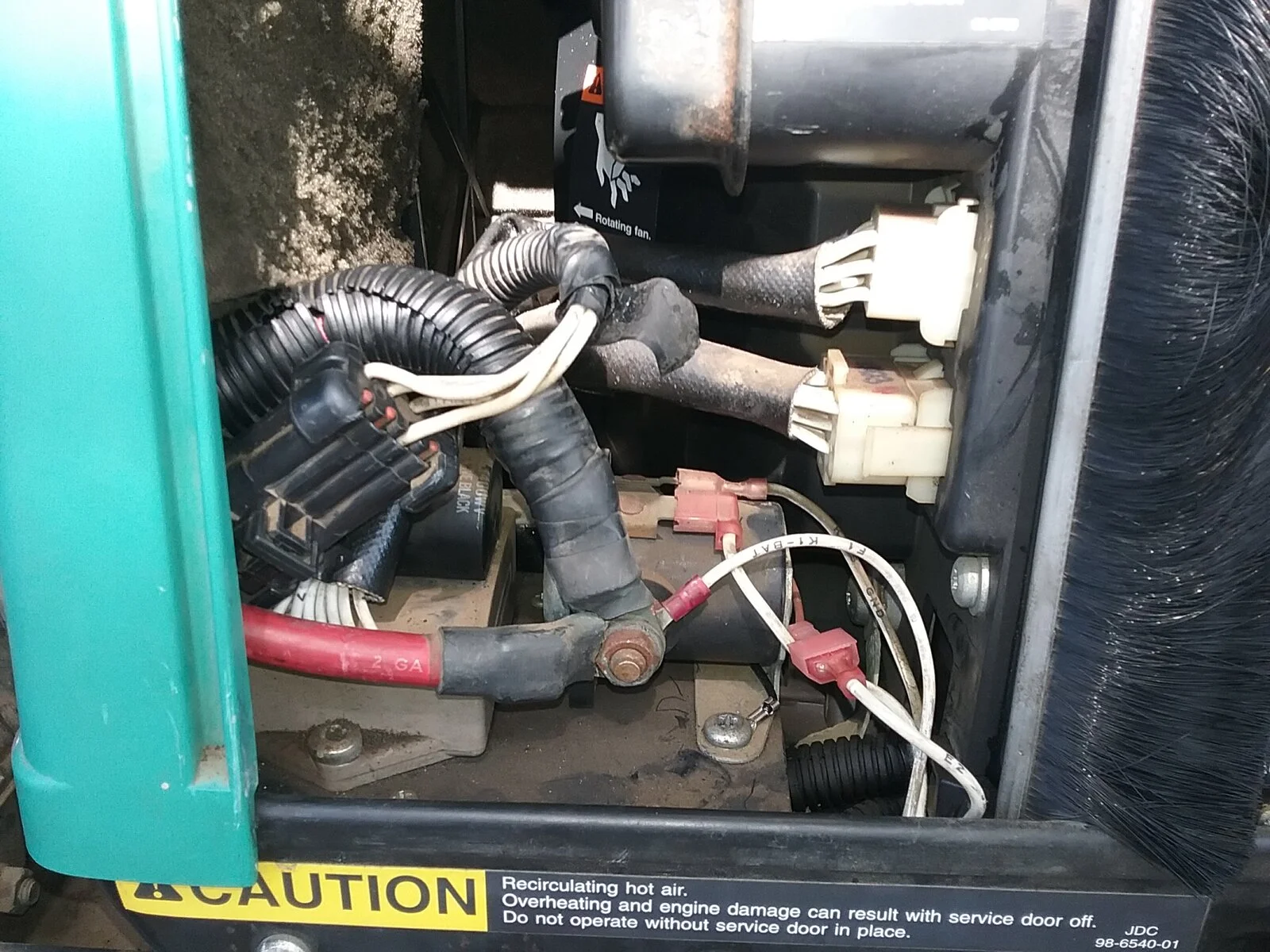

While the jeep was cooling down I worked on replacing the fuel filter on the coach genny Didn't fix the issue, so looks like the tank needs dropped, ugh!
Had to remove all this just to get to the pump.

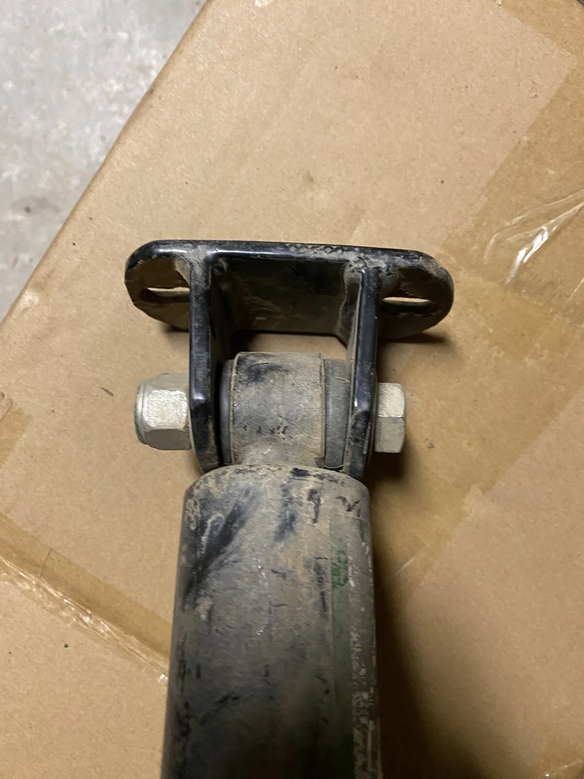

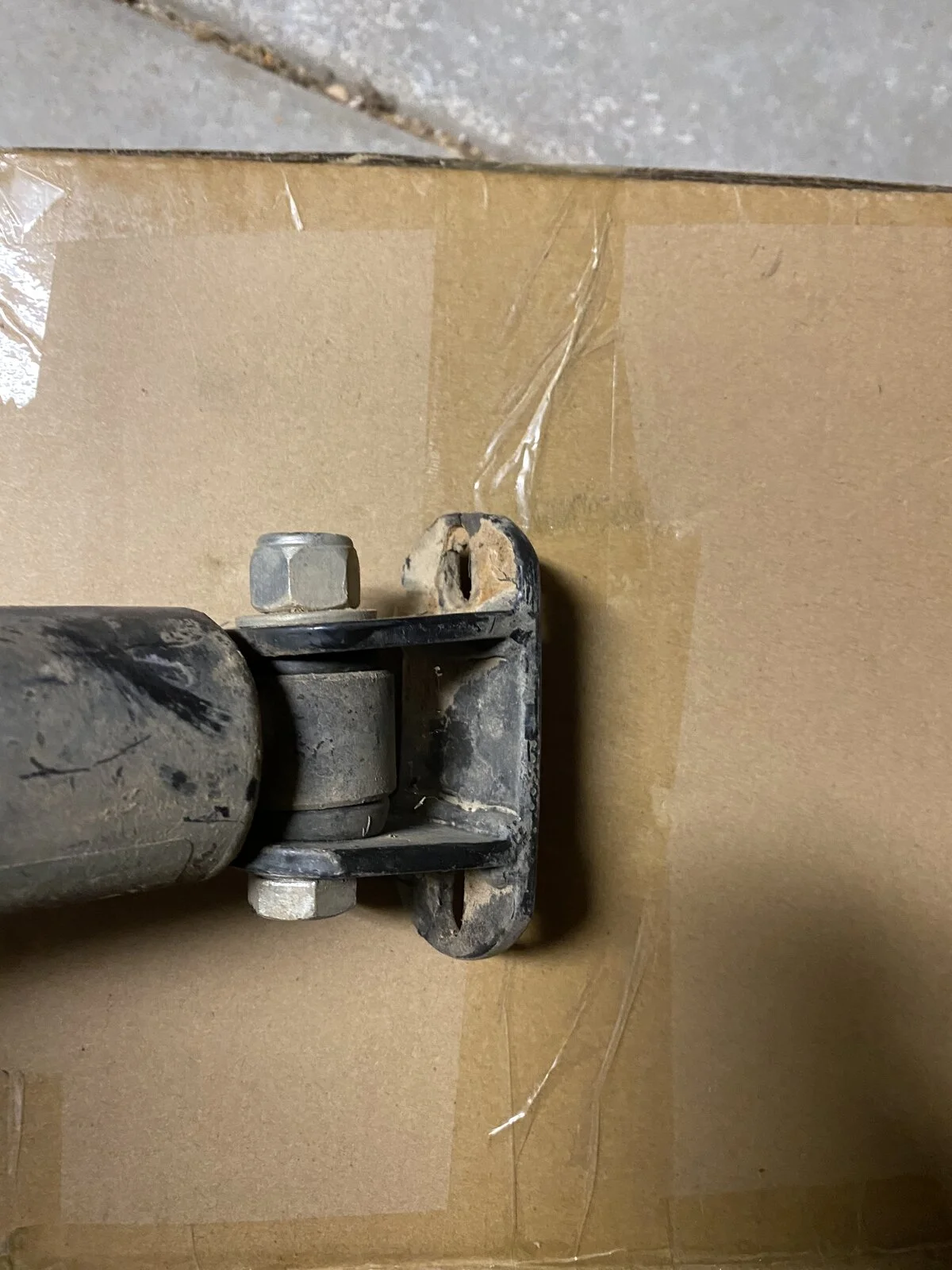

I think I'm going to put the Rancho shocks back on. I was initially impressed with the JKS shocks, but after a few hundred miles, they have changed characteristics noticeably. They seem harsher on small events, and feel firmer all around. Not sure how a shock can change like that, but my butt dyno feels a change. The problem I had with the Ranchos was the rear shock bias. I want more of a 50/50 bias, but couldn't achieve it with my current stats. So, what I'm going to do is get some BPE's for the rear upper mounts. This will give me another inch of down and gets me a little closer to a 50/50 bias.
With BPE's, 4.50" up/ 3.67" down. The fronts will have a better bias as well at 4.32' up/ 5.09" down. All in all, it was an experiment, and a minimal investment to try a different shock combo. The take away? If you like a firmer shock that handles ok, but is firmer that the RS5000X shocks, the JKS shock is a good economical choice.

That's interesting. How do you think they compare to Bilstein shocks? By your description, they sounds similar. I'm going to move to the Ranchos in the near future, if they have an appropriate length for my setup. JKS was on the list, but it doesn't sound like they are what I want.
I can't compare them to Bilstein cause I've never ran that shock, but I wouldn't discount them if you like a more sporty feel. They are firmer than my first gen OME Nitros were, and firmer than stock shocks, and Ranchos. That's all I really have to compare them to. I'm heading up to the Sierras in search of snow this weekend, so I'll get a better feel for how they handle mountain roads.
Sporty, Yes, jittery, no. That is my complaint with the Bilsteins. If they had a little bit softer feel on gravel, "coarse" pavement, expansion joints, etc, they would be a great option. But...they don't, and they feel very stiff over that stuff.
