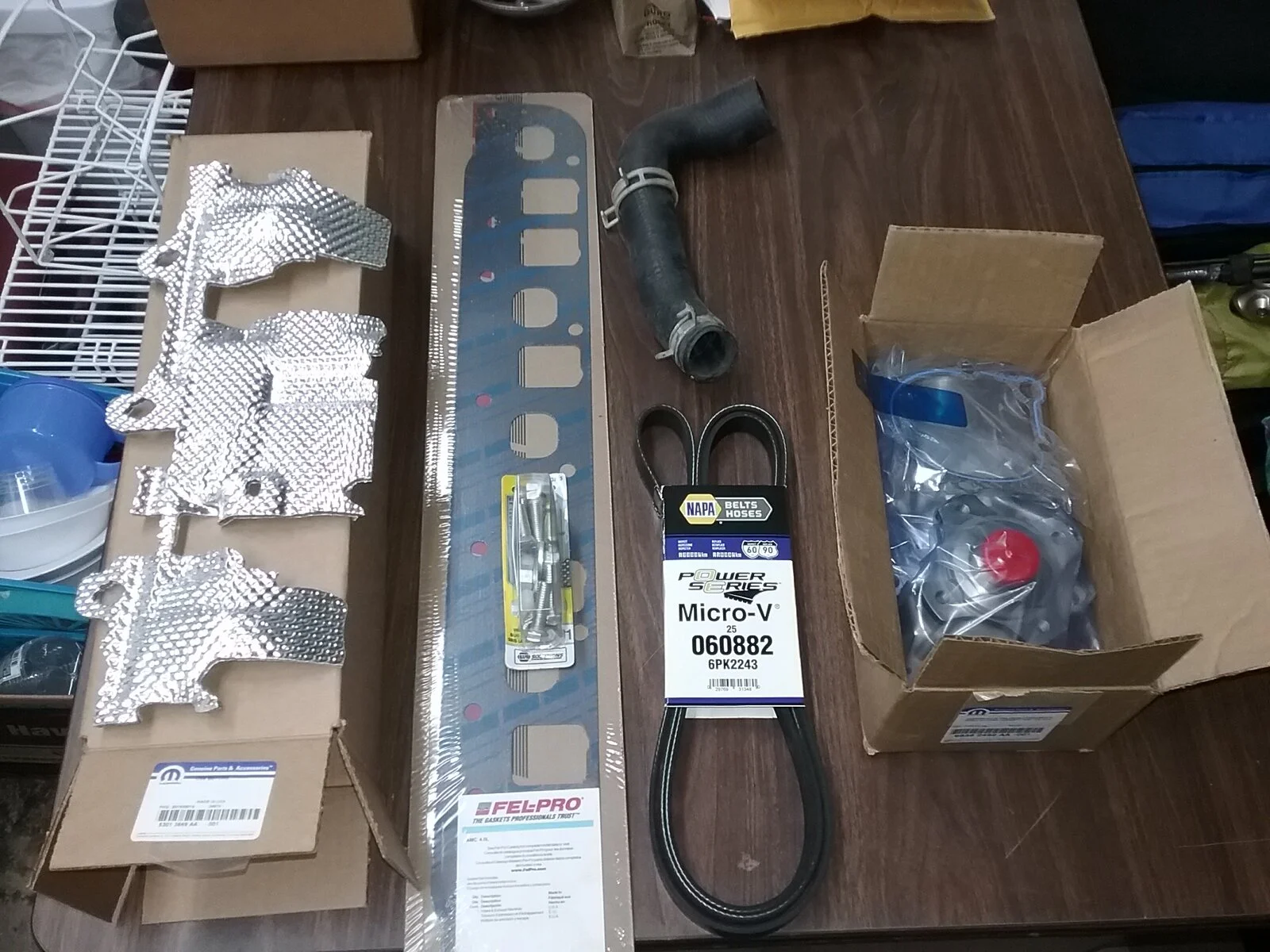

In other jeep news, my water pump is giving me hints that it is going to puke its guts out at the least opportunistic moment soon, so I have a new Mopar unit in stock. Might make it an all day'er and change that whistling intake gasket at the same time. Fun times!
