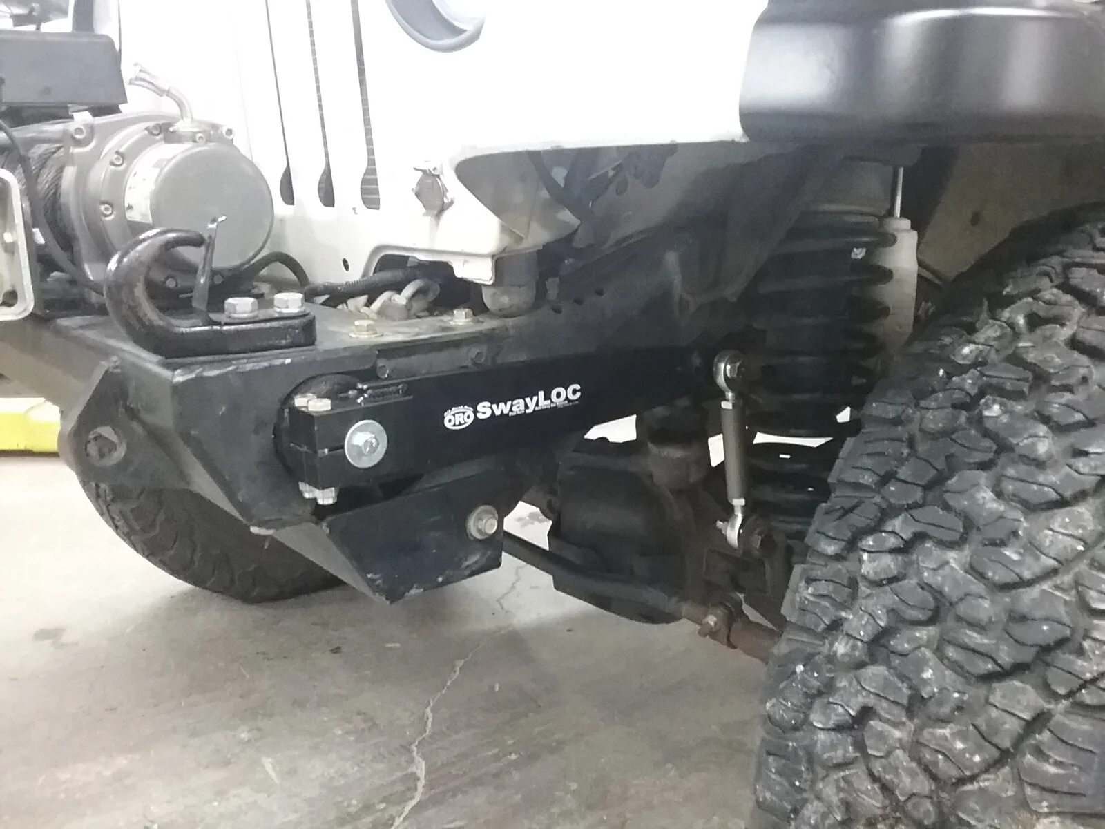

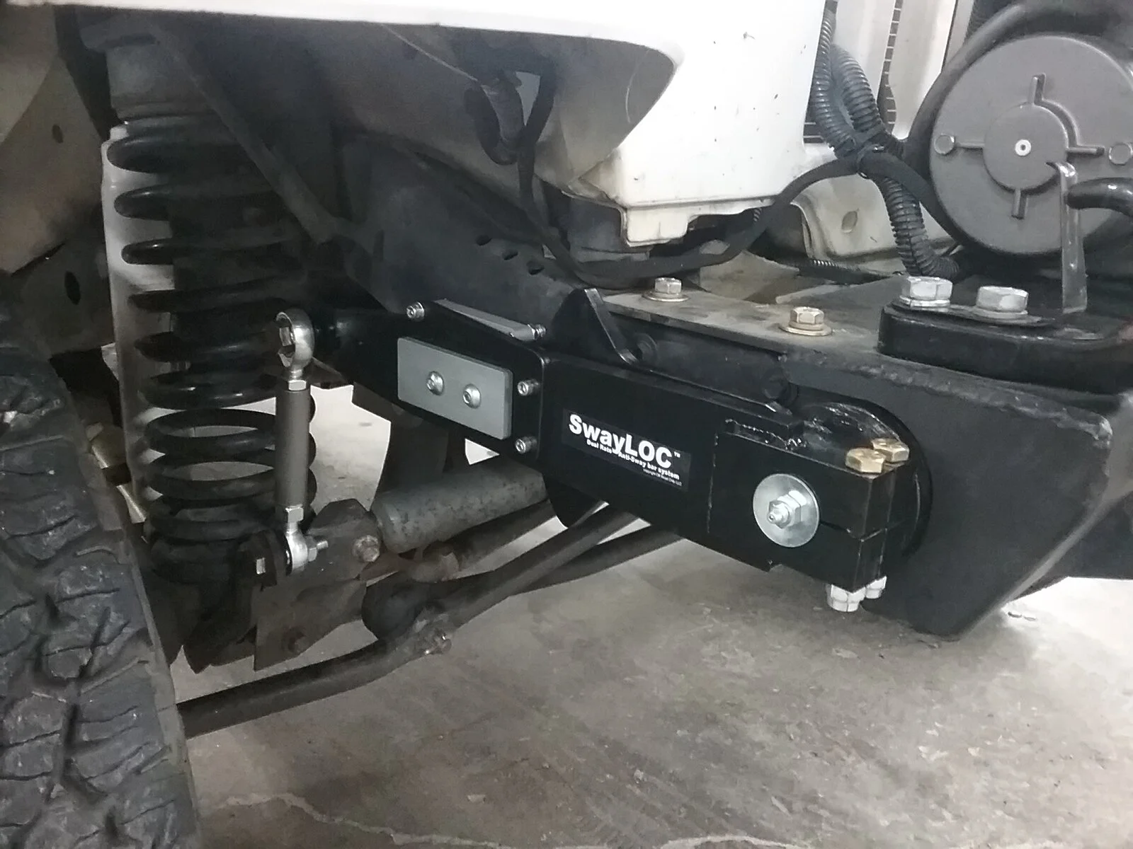

All done.
Start to finish, took me about 3 hours. Not terrible, but I'm sore today! Didn't have a chance to play with it, but the drive home felt solid. Can't quite pin it down, but it does handle different, not in a bad way or anything. It feels a little more solid than the factory bar, but at the same time the small events seem more controlled and smoother. Can't wait to try it on the trail next weekend!
I didn't want to do shocks and the Swayloc at the same time because I wanted to feel the differences, if any, before changing shocks. This should wrap up the last of my refresh items for the season. Hard top will go back on after the Halloween run, then I get to deal with harmonics, again.

What hole on the arms do you guys suggest I put the end links on? I currently have it on the 2nd. hole from the end and it feels very solid around corners.
Bring the tools to change the holes and we can find a rock to flex on Saturday to find what the correct balance is.
I always ran mine on the loosest setting but I never had a rear swaybar and my shocks were so stiff that I could run without a swaybar. So my preference might not be a good point of reference.
