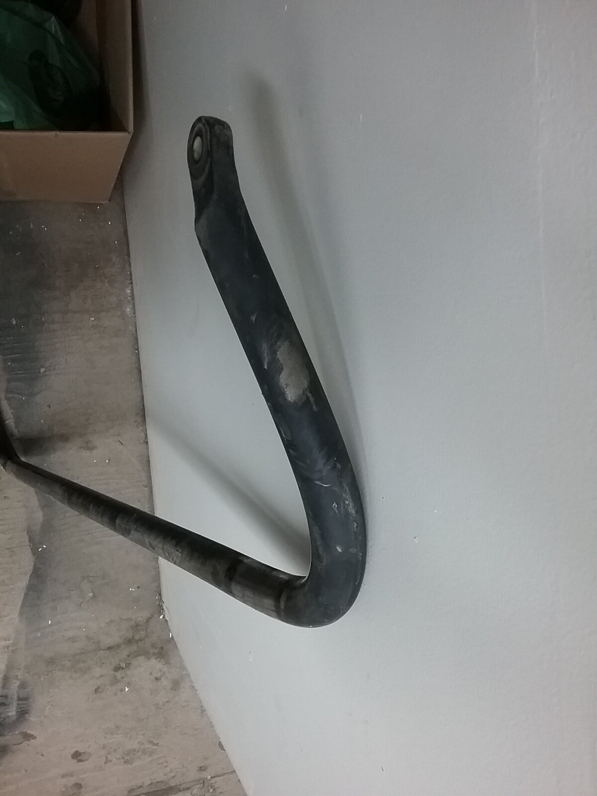

With a break in the weather I did a little flex to make sure that passenger side arm clears. Under full stuff, full lock I have 3/4" of clearance with the tire, so I'm good! Before, my factory sway bar would rub against the tire, as seen here.
Must be the SwayLoc coupled with the 10.5" tires. I can't get my 12.5's to clear the AntiRock. I could if I put some washers on the steering lock, but not worth it for me. Nice job here though!
What back spacing are your wheels?
3.625"
I've always rubbed the stock swaybar and driver side shock tower. Now I rub the anti-rock and the driver side shock tower.
My wheels are 3.75", but like you said, with the pizza cutters, I get a bit more clearance. I also added a washer on the the steering stops a while back.
3.625"
Its weird how we all have different points of contact on relatively similar setups. My 35 x 12.5 on a 4" BS wheel clears the shock towers and SwayLoc arms, but the inside rubs my control arms at full lock, both directions. My solution will be a couple washers.
Reactions: bobthetj03
I’m another with contact on the arms, but since it’s all low speed I decided I’m okay with it.
That is odd. I’ve never contacted my lower CA’s. The twins do with the Maxxis 33’s. I’m not sure what their BS is on their steel ProComp D window wheels, but I know their front axle isn’t centered because they haven’t installed the JKS front TB from @rasband. Should be doing this soon, as well as some other mods, but the interesting thing is they hit the stock CA’s when they turn.
