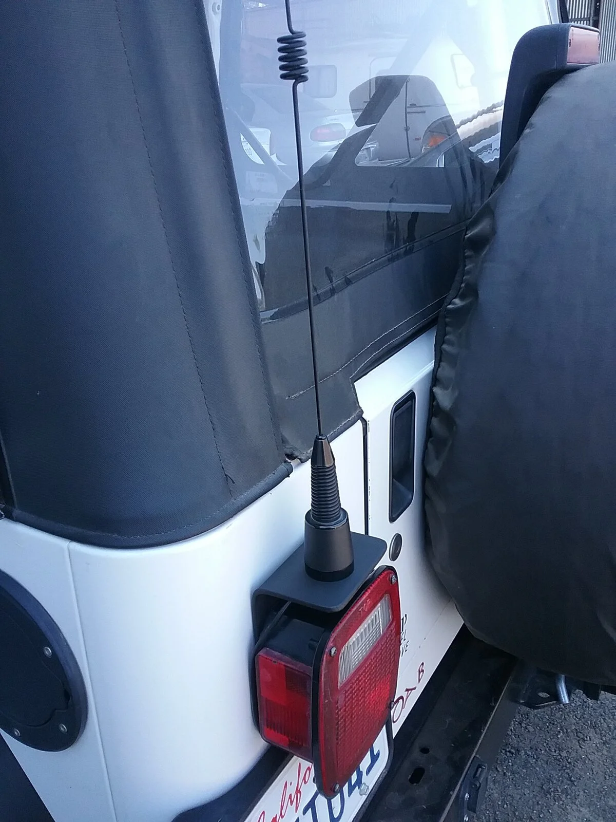

Small issue. When I made my GMRS antenna mount on the taillight the soft top was on. I thought I gave enough room for the antenna to clear the hard top rear glass, but I did not. I can't drill a new hole and move it over a bit cause it'll look stupid, and the NMO mount won't seal. So now I need to decide whether to put my old mount back on, fabricate a new one, buy one, or relocate the antenna. Anyone else have their antenna in a different spot, and is it performing well?
Assuming that it uses the same bolt hole you drilled, you can use the teraflex one I am using. I have no issues with it, and it clears the hardtop and soft top windows no problem. I use their driver and passenger side mounts. Here's the driver side

Because my antenna has an NMO mount, it is bigger in diameter at the bottom vs. a CB antenna, so I need to take that into account. Also, I had a problem with this antenna in high wind situations on the freeway where it would sometimes flail out of control and smack the back of my hardtop. I would literally have to come to a stop to calm it down. Happened twice on me. I even complained to Midland about it and they sent me a new antenna. I have a feeling it is a result of the antenna being really close to the side of the hardtop and catching the draft in a weird way. It hasn't done that with my home made mount being a bit closer to the right and also made from 3/16" steel. This is another reason why I'm considering moving the antenna all together.

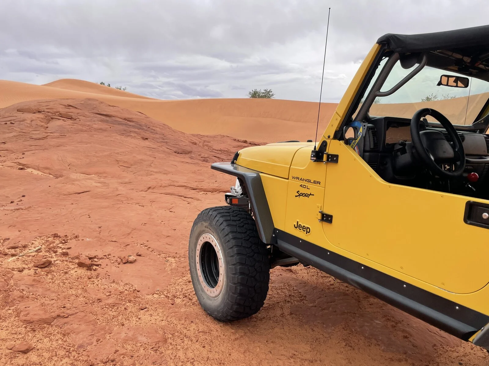

Driver side just in front of the rear view mirror. Problem I have with that location is the coax routing. There is no real clean way of running the coax into the dash. Plus, I have no idea how the antenna will perform in that location with the shorter antenna.
