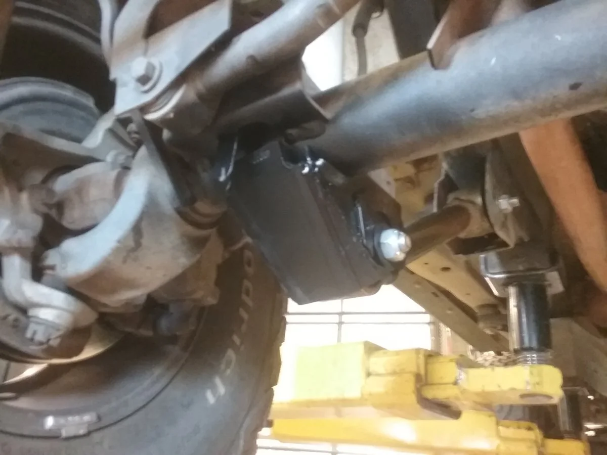

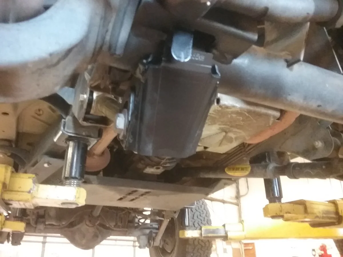

Got mini skids installed yesterday. Also, with the help of @Alex01 , MML install as well. Removed the drop on the t-case, which i was pleased about.
Any effect on the vibes at all with the MML + removing the drop?
Adding the MML and removing the 0.75" t-case skid pucks netted the same result as lowering the t-case, so I'm good with that. I don't feel the vibes in the steering wheel/seat any more till 75mph. I rarely go that fast. I still want to lower the front pinion just a tad more to gain some more caster. I'll see how far I can go. I still hear a slight harmonic, but it's hard to tell with the top off, so I'll deal with that when the hardtop goes back on in the Fall.
So, after this weekend's shenanigans, my oil pan is an inch higher from danger, and my t-case skid an inch higher than stock for more clearance. Modest gains, but gains non the less.
After these latest adjustments, my front pinion is sitting 1* lower than the front ds @6.5*. My rear is now 2.5* lower than the rear ds @14*. Think I'll raise the rear up a degree and let it ride.
