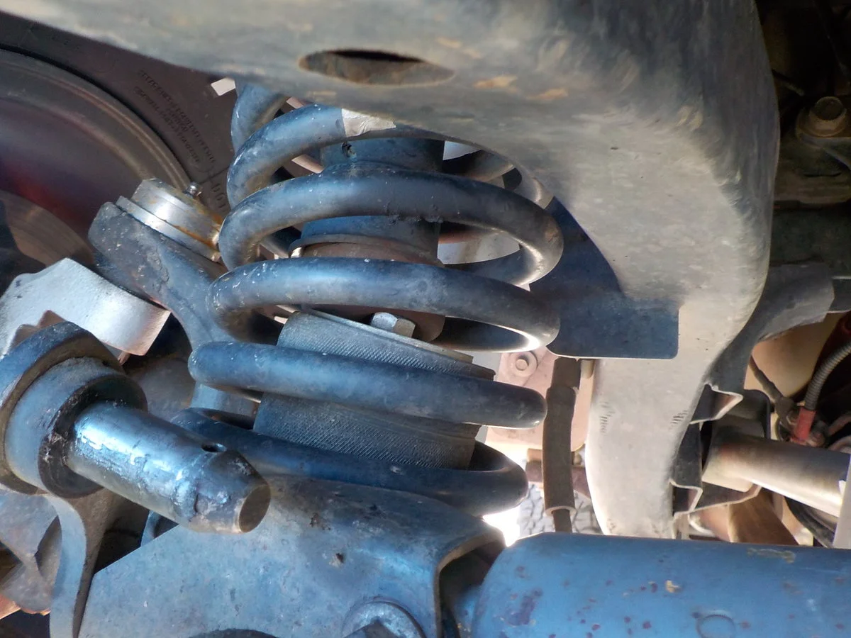

The roads in my town are in pretty bad shape, so I'm often hitting the bump stops during normal driving around town. I have 3.5" of up before my bump stops hit the jounces and 5" of total up with the jounces fully compressed. The zip tie test confirms that the jounces are stopping any further up travel during normal driving. I'd like to increase the up to give the shocks more time to do their job prior to being stopped by the jounces, but I don't want to lift the jeep any more than it is now. I was perusing the MC website the other day and saw a new item that was of interest. Replacement jounces. It got me thinking that if their jounces are softer, that maybe It would provide a little more cushion on smaller events than the factory jounces provide. A quick email to Will at MC to ask the question gave me the opposite. He said their jounces are actually a little harder than the factory jounces, which in turn provides a better ride. This has me a bit confused, but if their jounces have more of a shock absorber type of movement like shown in their video, maybe their could be something to it. It also appears that when they are fully compressed, they give about 1" of upper bump stop. Can't confirm that unless I buy them, install them, and cycle the suspension, a lot of work. I hate pulling the front springs! If indeed they provide 1" of upper bump, I could feasibly remove one of my lower hockey pucks. This in turn would give me one inch of additional up before hitting the jounces and still provide enough bump stop to keep the shocks from bottoming out. My shocks are the limiter. I originally set the bump stops to give me half an inch of shock shaft before hitting the jounce cups (jounces removed), so I have little wiggle room. Another thought I had was to cut one inch of jounce off to give more free up travel, but that could bite me in the butt and make the hits harder due to less jounce cushion. Just ramblings in my mind right now, but I would like to experiment with this idea. Thoughts?
So...are you hitting hard and fully compressing the jounces or are you leaving a bit of travel on the table? I don't think replacing jounces will get you what you're looking for. I think removing some bump stop will, though I don't know that it would be noticeable or worth the effort...
Based on my measurements, I'm hitting the jounces but not compressing them much.
According to Rancho's specs, the 2.5" lift shocks are 14.43"/23.84". the zero lift shocks, 13.05"/21.03". I'm sitting at 19" in the front at ride height. I'm pretty close to a 50/50 travel bias. If I went with the zero lift shock, I could lose an inch of bump stop, buy would lose quite a bit of droop. It would be around a 70/30 travel bias. I know having more up is beneficial, but losing that much droop doesn't sound appealing either. Ideally I need a shock that is 13.00"/23.00".

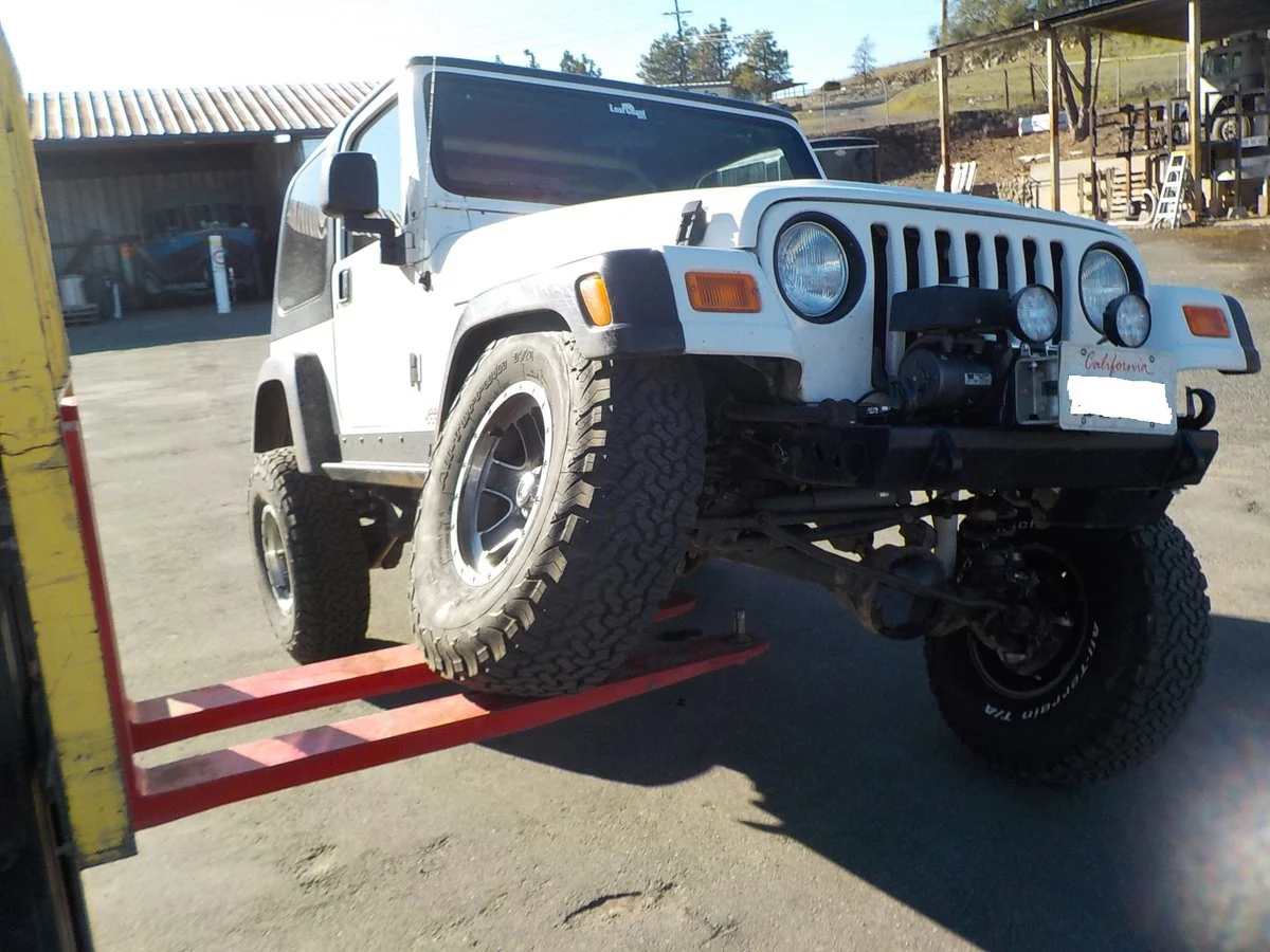

I assume you're using factory jounces? Maybe it's time to revisit the bumps... Perhaps some fun with the forklift will show you how the jounces are compressing at various loads.

Yeah, I did the ole forklift flexing a while back. Getting good compression disco'd, but you aren't getting road transfer to the ole butt dyno when you're static like that. That's why I was toying with the idea of cutting off some of the jounce so I have a bit more free travel before hitting the jounces. Having a jounce that doesn't compress as easily, like Will @MC mentioned with their's, doesn't seem like it would help matters. The only thing I was considering with MC's jounce is the ability to use it more as a bump stop and be able to remove a lower bump, which is a rigid hockey puck. I just don't know if MC's jounce will give me an inch of solid bump with it fully compressed.
