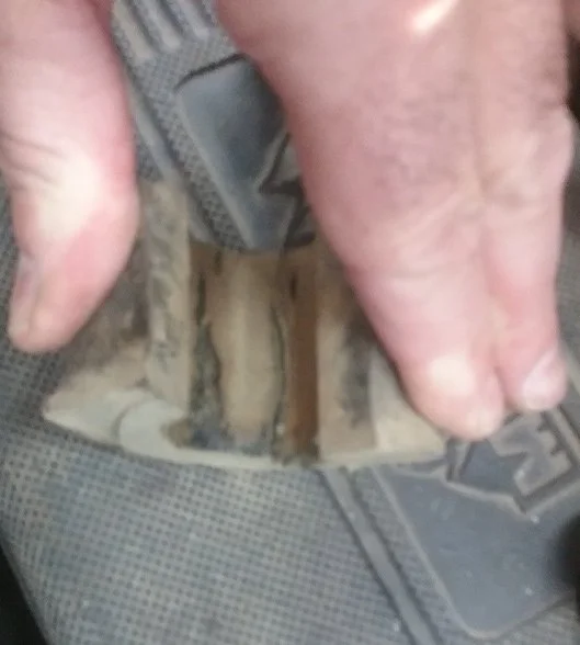

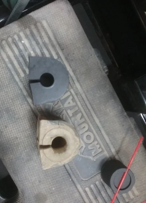

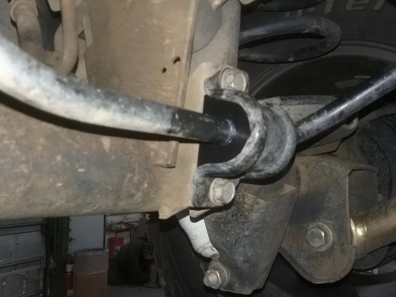

I am my worst enemy when it comes to strange noises coming from the Jeep. Clunk at slow speed, off camber situations. Guess what that means, checking every fastener I can get to under the POS. Put it on the lift and took a torque wrench to everything I could get to. Other than a slightly loose body mount bolt, nothing. Then I tugged on the rear sway bar. About 1/2" of play, so ordered some new frame mount bushings. Not sure if this is the culprit, but it needs addressed. While I had it on the lift, I reduced my front bump stop extensions from 2" to 1.5". It's an experiment. @rasband is savvy, lol! Wait, did I just do that?
Changed out the rear sway bar frame bushings last night. they were shot for sure.

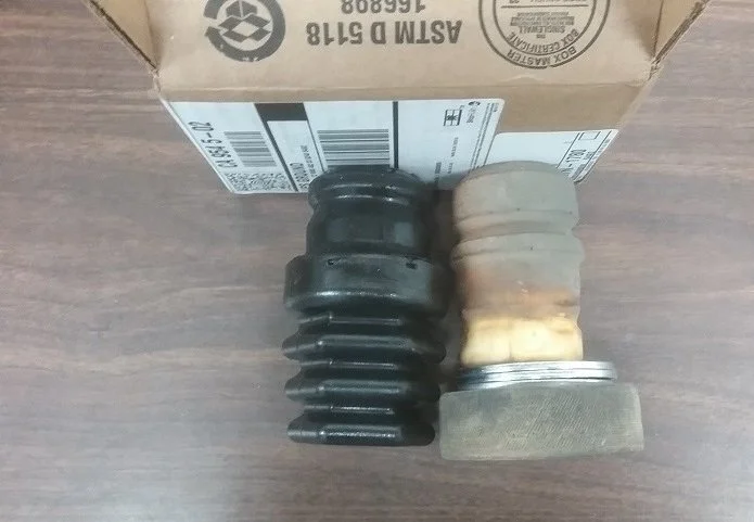

Been waiting for another flash sale from Metal Cloak to order their jounces for the front. Today is the day, so I ordered up another pair. Gotta pull the springs for this one. Not looking forward to that, but oh well, it's the price you pay to play!
Other 2 Durosprings came in the other day, so I need to free up a weekend to pull the front springs and make the swap. should work out as far as bump stop extension is concerned, but I'll cycle the axle and see where I end up. My hope is to loose the lower extension all together, which hopefully will provide better cushion on smaller road events. The Durosprings should effectively give me 1.5"-1.75" of hard bump stop extension after full compression.
Durospring on the left, my current bump stop extension on the right,
My biggest concern with the front is bottoming out my shock selection. I still have a fair amount of tire clearance as these KO2's run small. I'm only leaving about 0.5" of cushion before the front shocks bottom out, so I'm cutting it close. I'll know more once I pull the springs and cycle the suspension.
How much force did you put on the bumps to determine hard stop? I would assume driving conditions could incur a lot more force than I can exert on them.
I was reading somewhere it hard bumps out at 1” but I just wanted to hear your input. Like others said, you’ve got me spending money!!!
The material is a bit more dense than the factory jounce, so I'm banking on probability that the lighter TJ will not compress it as much as a JK/JL. Sounds good in theory.
