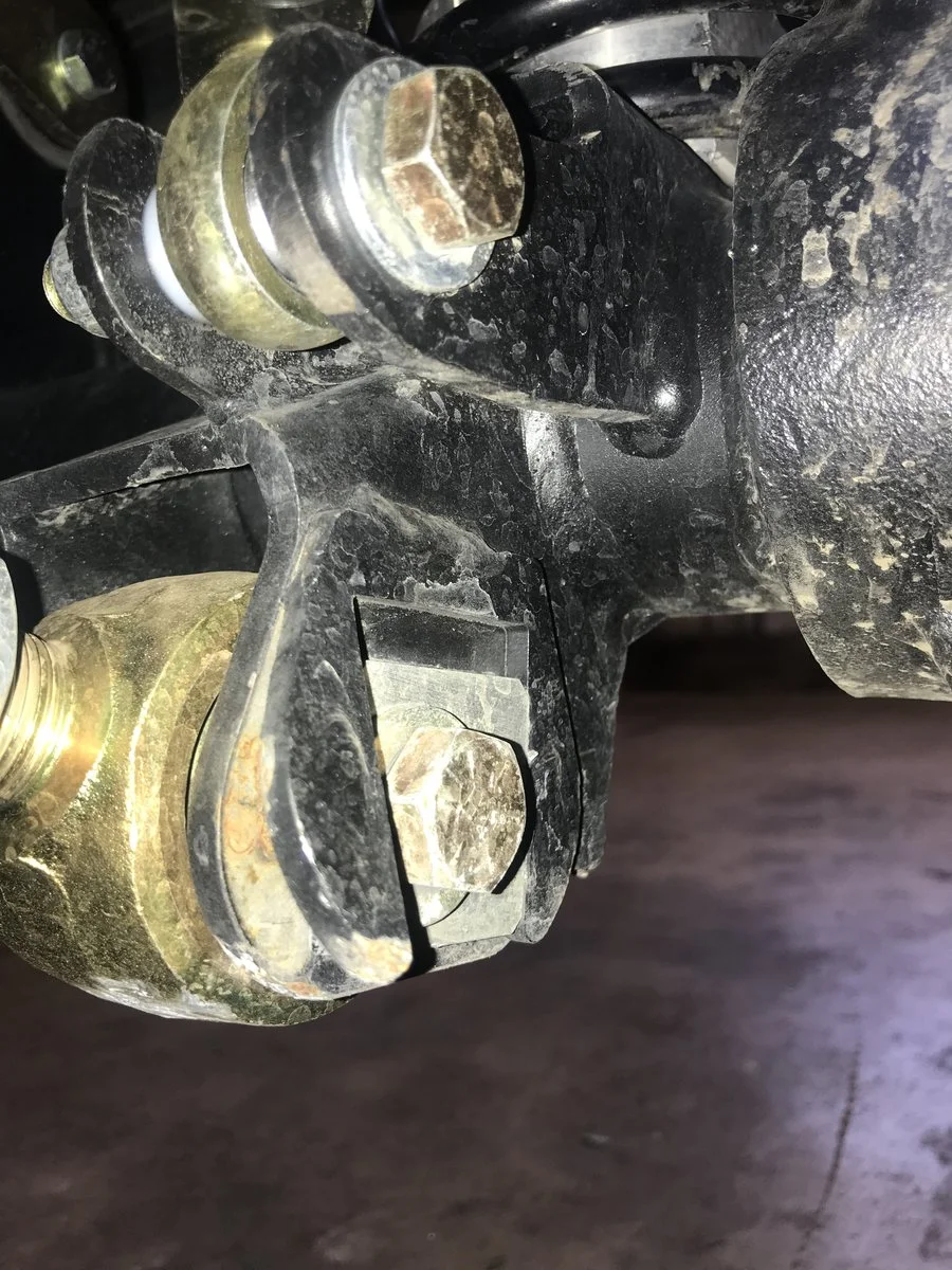

Check all your bolt torques (control arms and track bar) - I had a similar issue that was caused by one slightly loose bolt.
