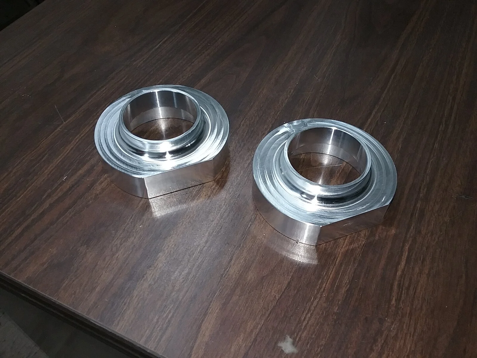

The poly 0.75" spacers I have in there now are no longer giving me 0.75", so these 1" billet beauties should take care of that and give me just a tick bit of rake back.

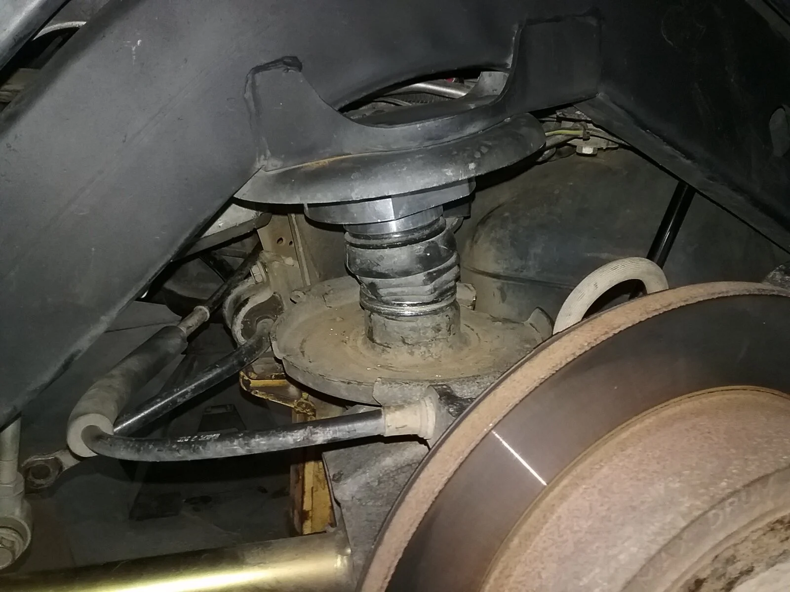

Ended up shortening the lowers 1/4", then adjusted uppers to suit. That gave me enough clearance to stuff the axle till the tb relocation bracket hit the tub. I added 3/8" additional bump to keep that from happening. The Ranchos now compress to 1/2" of shaft showing. Mucho better. I Don't think the JKS shocks are going to work, as they will be too long. I'll check my numbers tomorrow.
Drove the jeep to work this morning. Drove a combination of half freeway, half surface county roads, most of which are in rough shape, so I got a good feel for some small and medium events. Drove some twisties as well to get a feel for handling. I have to report that the JSPEC shocks are a noticeable improvement. They glide over the small events smoothly. The handling feels about the same as the Ranchos, a bit soft, but still firm on harder turns. So far, I'm pretty impressed with them. Now, I have to take this with a grain cause I also changed a few things in this process.
1. I have a better, more even travel bias, so now the shock gets to do it's job with more real estate to do it with.
2. Hard top is now on, so I added 100lbs. to the back.
3. The new spacers raised the rear 1/4", so a tick more lift which now gives me a small rake. 4.. Maybe the JKS shocks do a better job at dampening?
