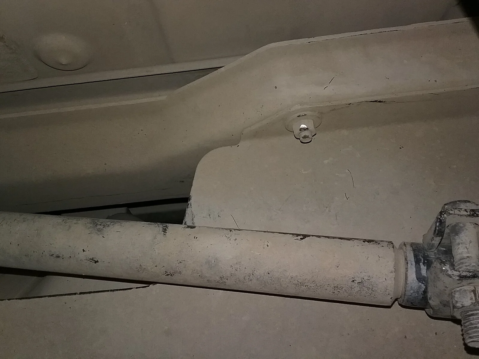

Also wanted to check my rear bump stops. I was lazy when I installed the MC jounces and didn't check, so I pulled the springs and put er at full bump. My rear TB has decided it wants to be the bump stops. Not good.
Did an oil change/tire rotation over the weekend. Still getting an occasional lifter tick that was becoming more pronounced towards the end of the oil change cycle, so I decided to try some Rislone this oil change.
Affirmative ghost rider, it’s a hit
What did you end up doing? Bend it on a press?
Cut that shit out of the gas tank crossmember. When I get home and out of the smoke and ash I’ll take a pic.
I wanted my axle centered in the wheel well and wouldn’t compromise wheelbase. A Currie TB would probably have solved it. My TB is the Tier 4 Core 4x4. It’s about time I got under there and took a look. I did cycle the suspension and my only issue was a slight rub of the TB on the passenger side shock at full stuff
Have you check your wheelbase? Perhaps during your hunt for a correct pinion angle you pushed the axle back unintentionally.

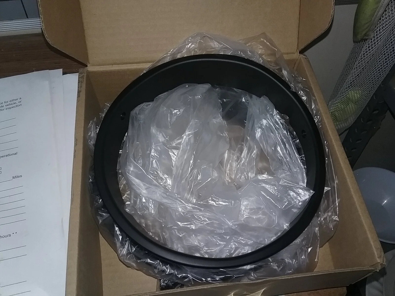

After 100 miles or so on the recent oil change, the lifter tick has not resurfaced. I guess the Rislone did the trick, or the combination of fresh oil and the treatment. Either way the tick has went into hibernation for now. I've decided to keep the headlight bezels black, but mine are rough, so I ordered some new ones in black.

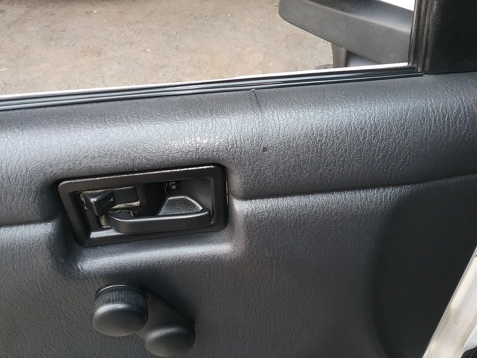

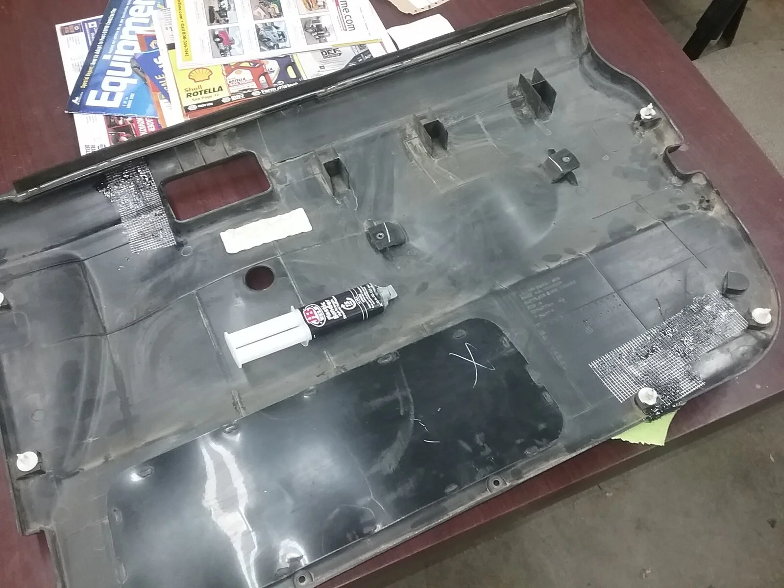

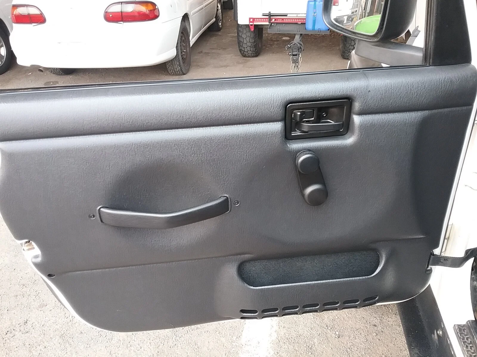

Door panel is back on and cleaned up. It's not a repair to be super proud of, but it's better than staring at a crack I guess, lol!
I always thought they were black, but after cleaning them up I can see the agate color. If they were black my repair would have been less noticeable.
