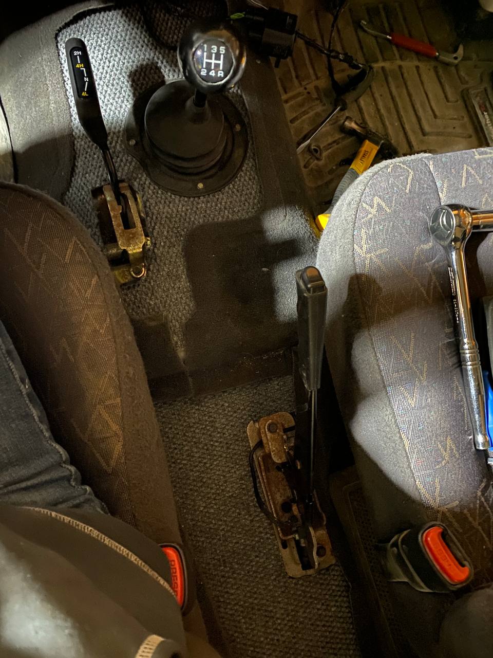

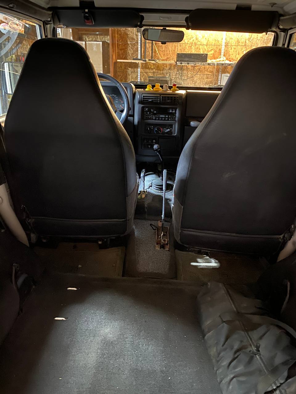

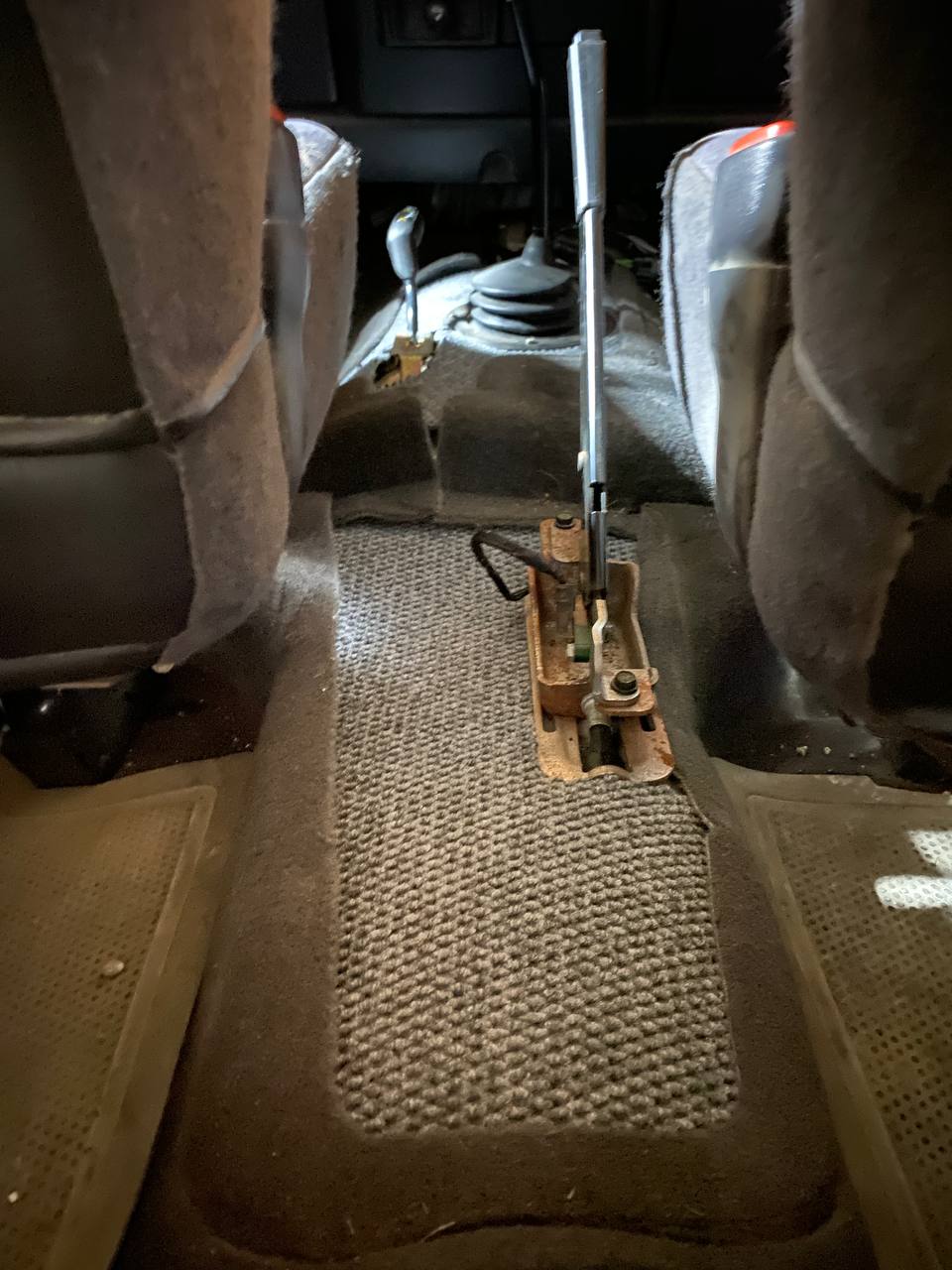

Please share a pic of the center console delete you have me curious.
A 25 mpg TJ would honestly be pretty awesome. It would be interesting to see how that motor does 4 wheeling if properly geared. They make good low end torque.
Here ya go! I found that I got very little use from the center console, so after removal I put carpet down and will soon be 3D printing a couple cup holder, a tray for miscellaneous items and my sister-in-law is willing to sew some custom covers for the t-case and hand brake for me. Feels WAY roomier in the front now. Not finished yet, but I like it!
