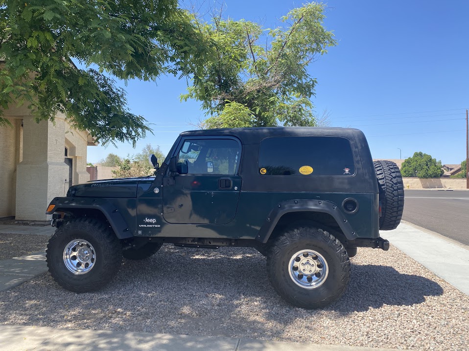

I may have settled on the polished 69's. I just can't see myself running black rims. I ain't hip enough for the blackout stuff.

Looking good....great taste in TJ color ;)
Reactions: pc1p

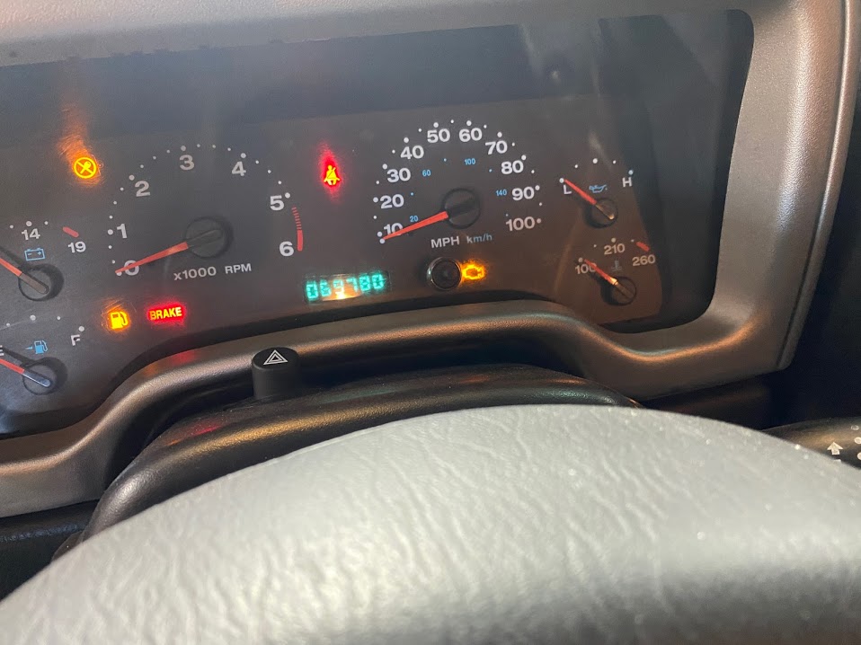

The WranglerFix ECM appears to be working fine, though there are some quirks that I am working out with Mark. First, the CEL doesn't immediately light up with the key turned on.
After about 13 seconds, the security light comes on, followed quickly by the CEL. Sometimes the gas tank light goes off and comes back on at the same time.
With the CEL not coming on, I am having a hard time connecting to the OBD-II diagnostic. My scanner will pull PIDs once the vehicle is running and will pull active codes once running, but will not connect with just the key on. Mark is going over it with his technician, so hopefully we can have an answer soon. With my move coming quick and with the engine running strong, I haven't worried about it too much.

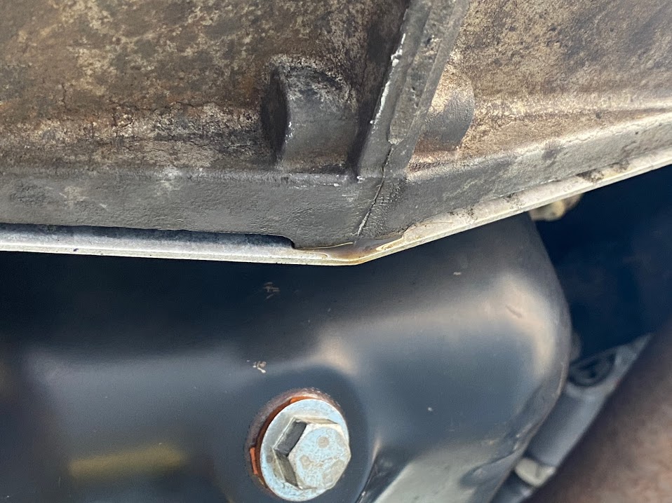

Had a fairly modest oil leak after replacing the clutch and RMS. I suspected it was the oil pan gasket; the pan was tweaked slightly on the bottom, which I know can exacerbate an oil leak. I ordered a replacement Dorman pan from Amazon on the "Open Box" sale (only $22!) and a new gasket, this time I went with FelPro vs the Mahle. With +110º temps, this was not enjoyable to replace, but I got it done and it appears to be fixed - I did not want to move to the new house and have oil drips all over the garage and driveway.
