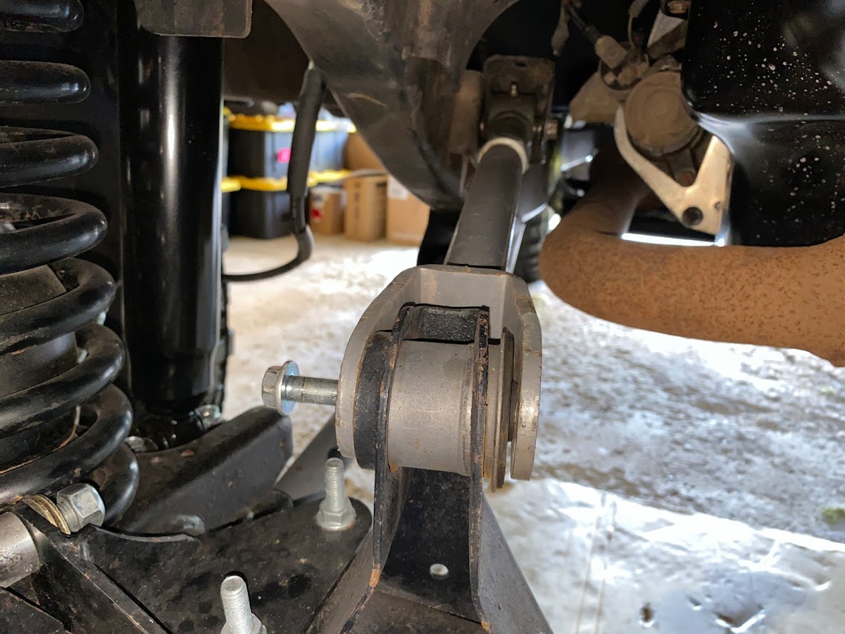

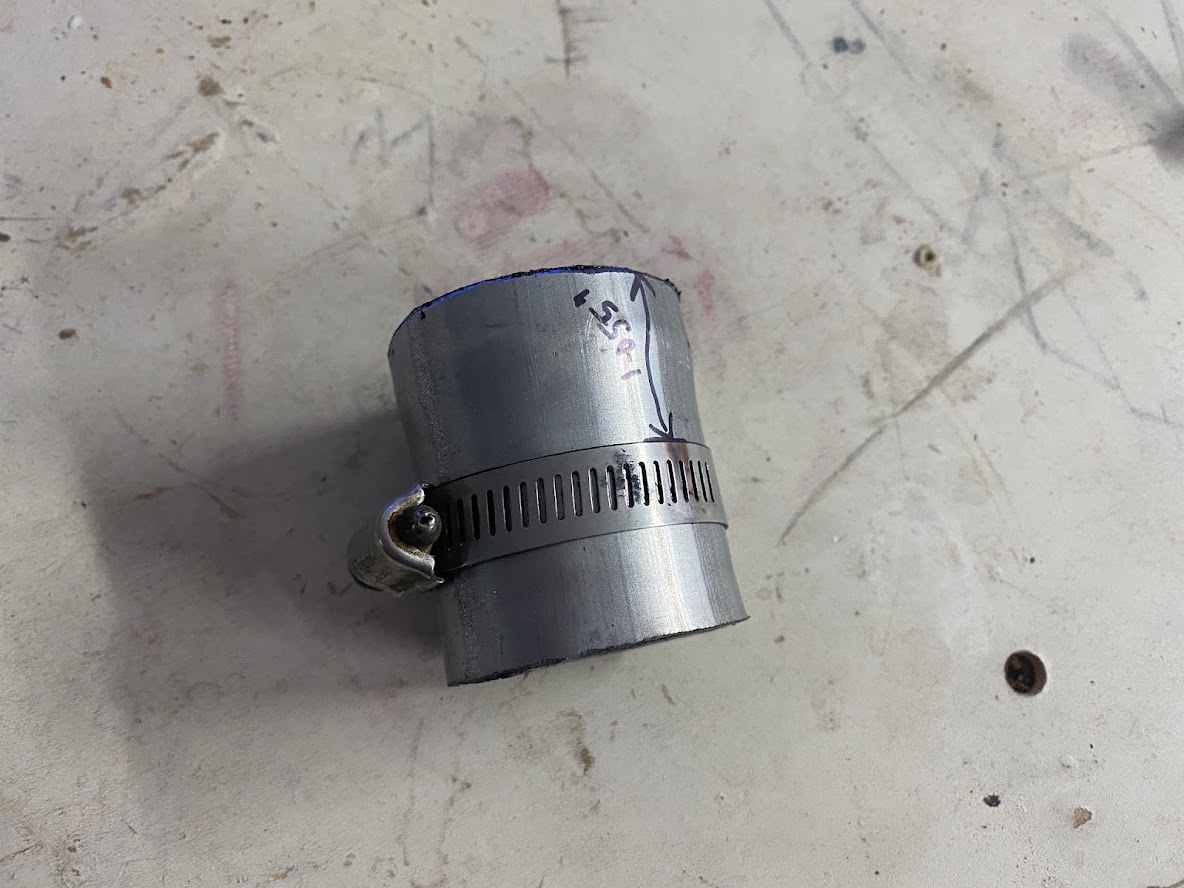

Well I finally got my DW figured out! Turned out to be the passenger-side UCA bushing at the axle. The retaining "ring" in the axle bracket was worn and the bushing was able to move side to side. You can see it in the picture below; it wasn't this bad but I was able to pop it out this far with nothing more than light pressure from a screwdriver...

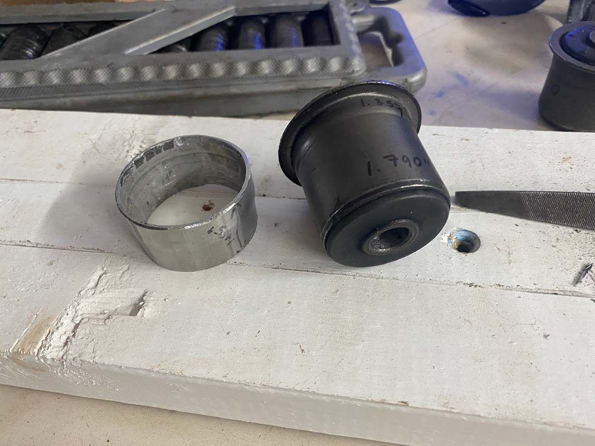

Thanks to Blaine's advice, I tried his trick of using some exhaust tubing to make a "sleeve" for the inside of the factory bracket. Essentially, you're just giving the factory bushing some more surface area to bite into. I went to my local exhaust stop and had them make me a few pieces of tubing that they expanded to the proper diameter.
I cut them to the proper width and tacked them in place, using the old bushing as a guide. Viola! back in action...

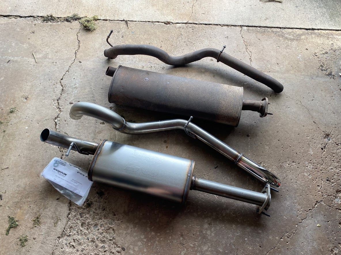

The @Quadratec Competition Cat-back Magnaflow exhaust finally arrived (it has been on backorder for a while - I ordered it on 4/20/21!!). Worth the wait thankfully - it has a nice mellow sound that has zero drone and just slightly more tone in the 2400-4400 RPM range. Sure beats the factory rattling muffler...

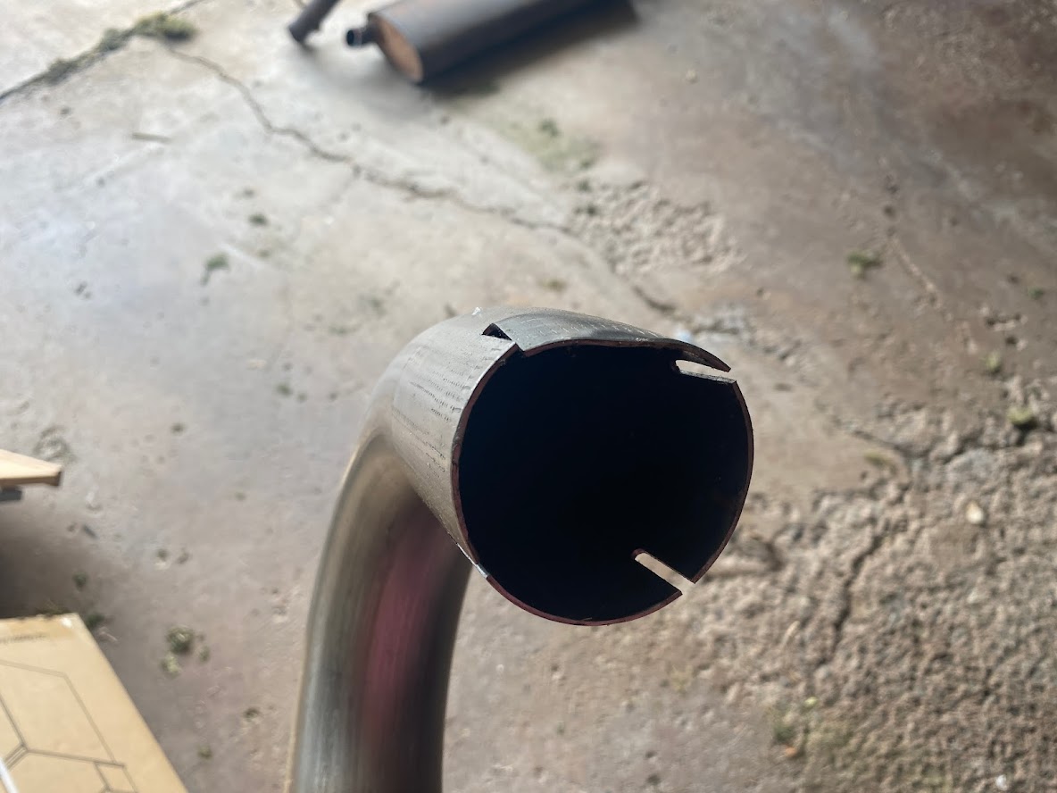

One of the tangs on the rear most portion of the tailpipe was bent down. The box looked beat up some but it was nothing I couldn't easily straighten out with an adjustable wrench.
