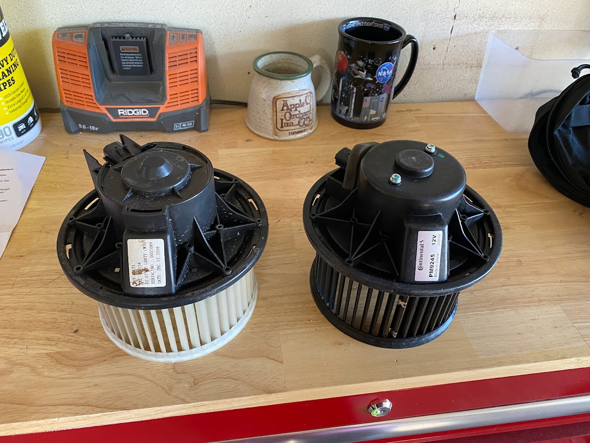

This had to be the easiest HVAC blower replacement in the history of automotive HVAC...
It took a whopping 15 seconds to remove and 30 seconds to install. The blower noise has been eliminated and all I can hear now is the sound of moving air through the ducts and vents (the old one had a very noisy whine!). The new blower also moves a lot more air now, so that's a big plus I wasn't really thinking about...

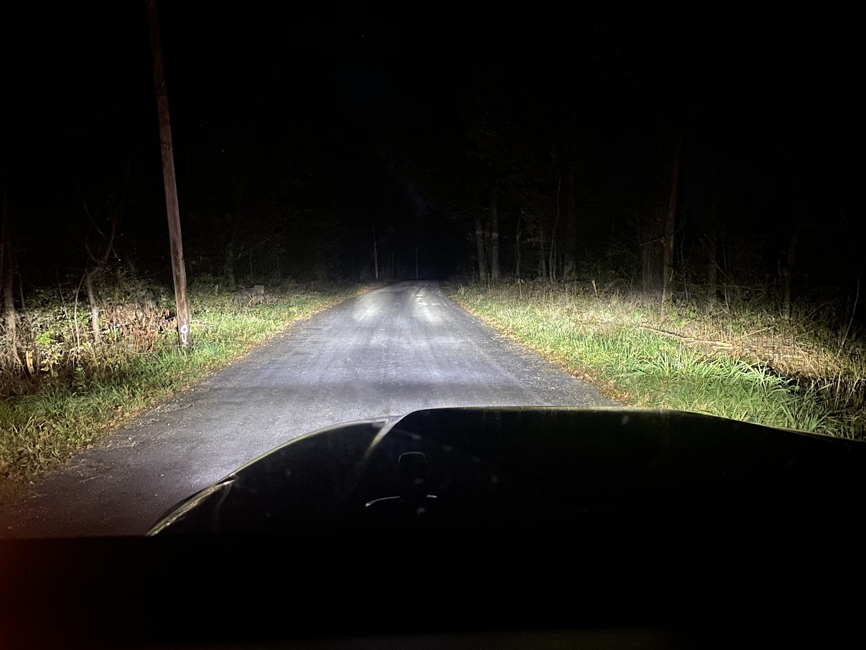

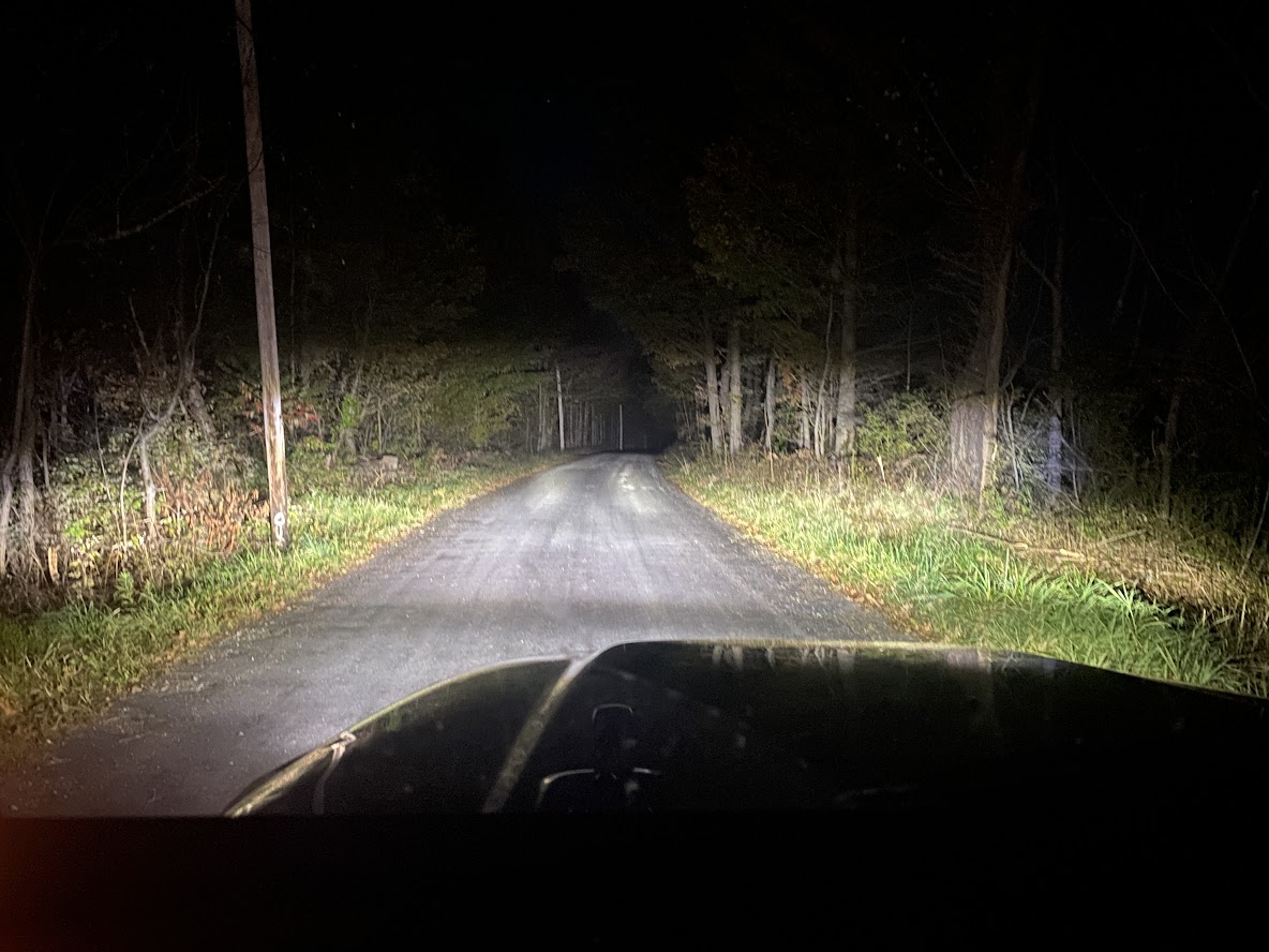

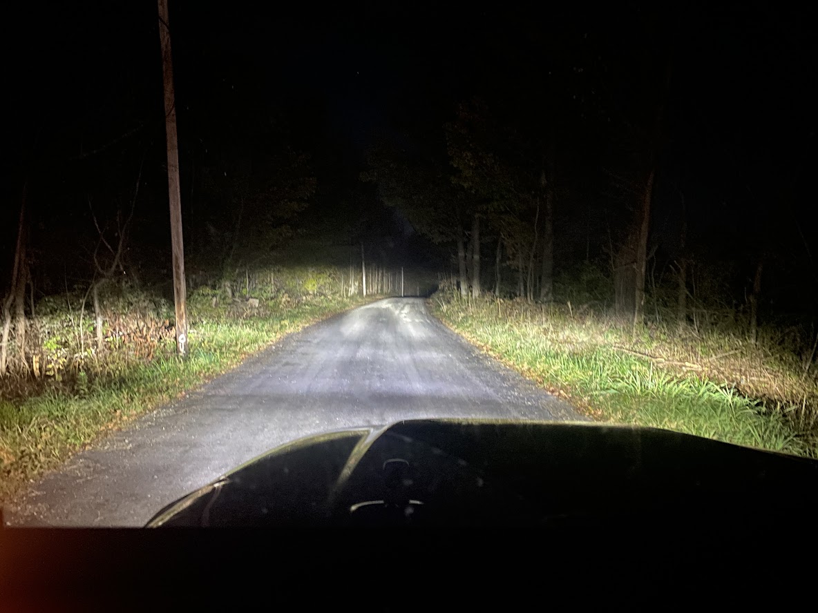

In my hurry to get ready for the move back to the east coast, I never properly adjusted the headlights after swapping the Truck-Lites in place. I matched the height and width of the beam pattern of my wife's 2017 Grand Cherokee (using my garage and grid as a guide) and the results so far have been good.
I took some "long exposure" photos below with my iPhone. Not the best to capture comparative results, but you get the idea of how the cutoff looks and how the lumens fill the woods next to the road...
Low Beams:
High Beams:
Low Beams w/Rigid SAE Fog Cubes:
I'm thinking I'm going to ask Santa for a set of KC HiLiTES 100 SlimLite LEDs to replace the Hella fogs on the pillars (https://www.quadratec.com/p/kc-hilites/slimlite-led-6-inch-pair-pack-100)
New blower motor on the right?
