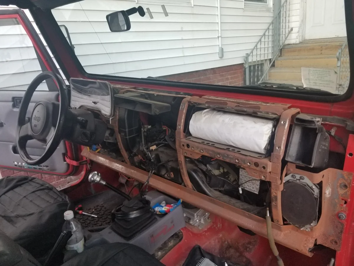

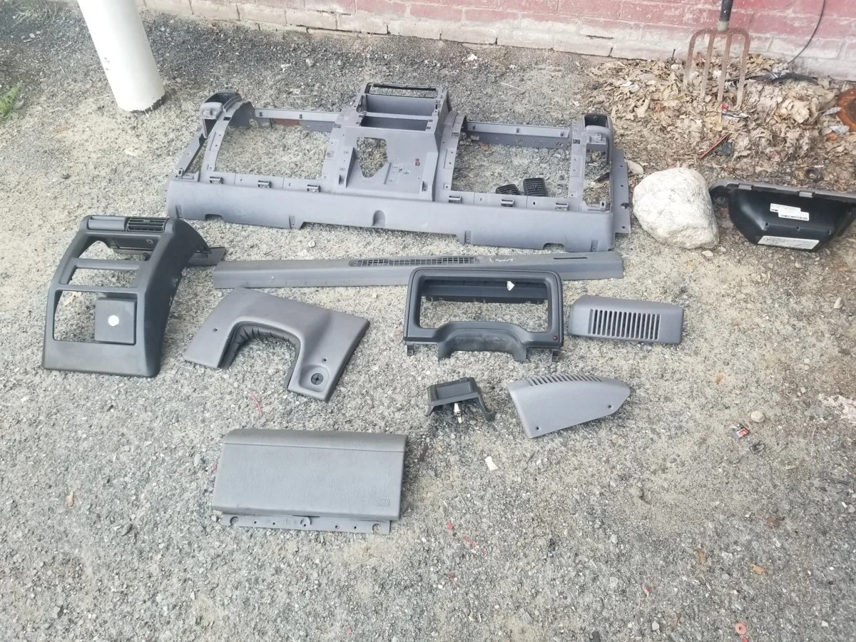

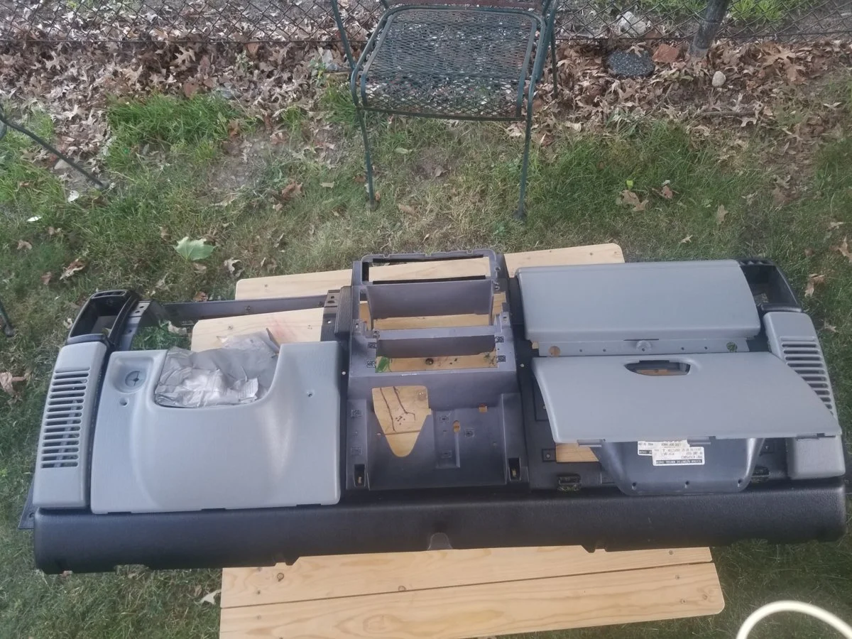

while waiting for my welder to start working on the body panels, I decided to remove and paint/refresh the interior dash and trims. Do any of you ever removed the passenger airbag cover? There was 5 rivets that I had to cut off in order to remove the cover, now I need to source new ones. where can i buy them? or I will have to just zip tie them.
I am planning on painting all black, including the center console and door panels.
I also found extra wires and cut wires that I will have to try and sort out.
Will paint tomorrow and share pictures
Local hardware store should have rivets of all sizes. I got a rivet gun at Harbor Freight and it came with a bunch of rivets.

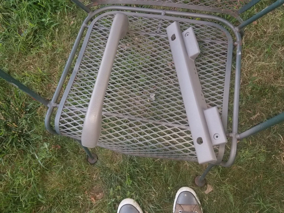

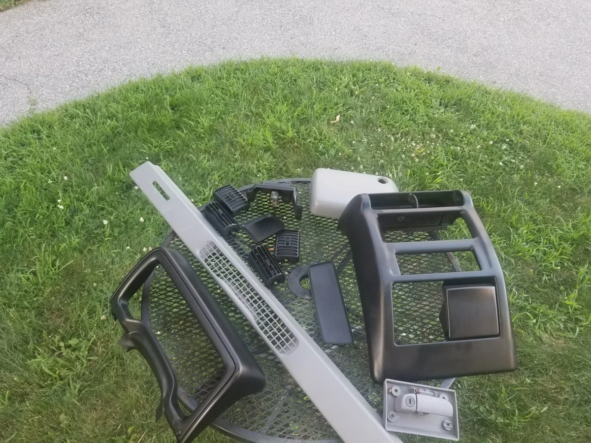

It came out good. Just finished painting. Will let it dry over night.
Looks great! The p.o. of my Jeep painted all the interior trim
Used to be grey, he painted it tan. Looked good when I bought it, but didn't take long for it to start peeling.. he did a horrible prep job. Guess the duplicolor is in my near future...
The dupli-color works perfectly on vinyl and plastic. have used it on multiple projects.
To get it right, use a degreaser cleaner and wash the pieces really good. Let it dry , then I used a light sand paper, and sand them down. Doing so allow the new paint to set in nicely.
If you spend time prepping it correctly, it will come out good.

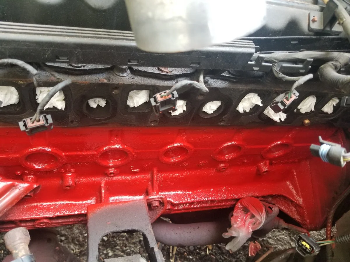

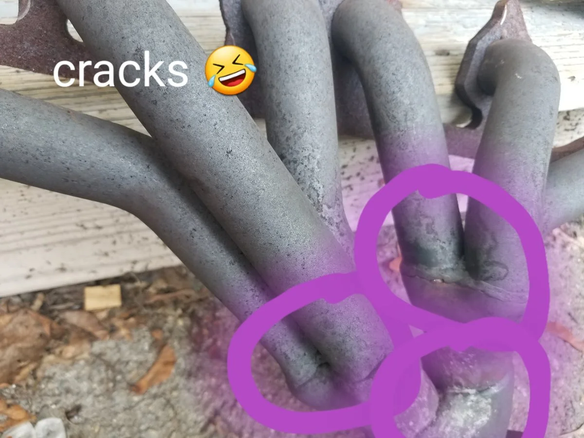

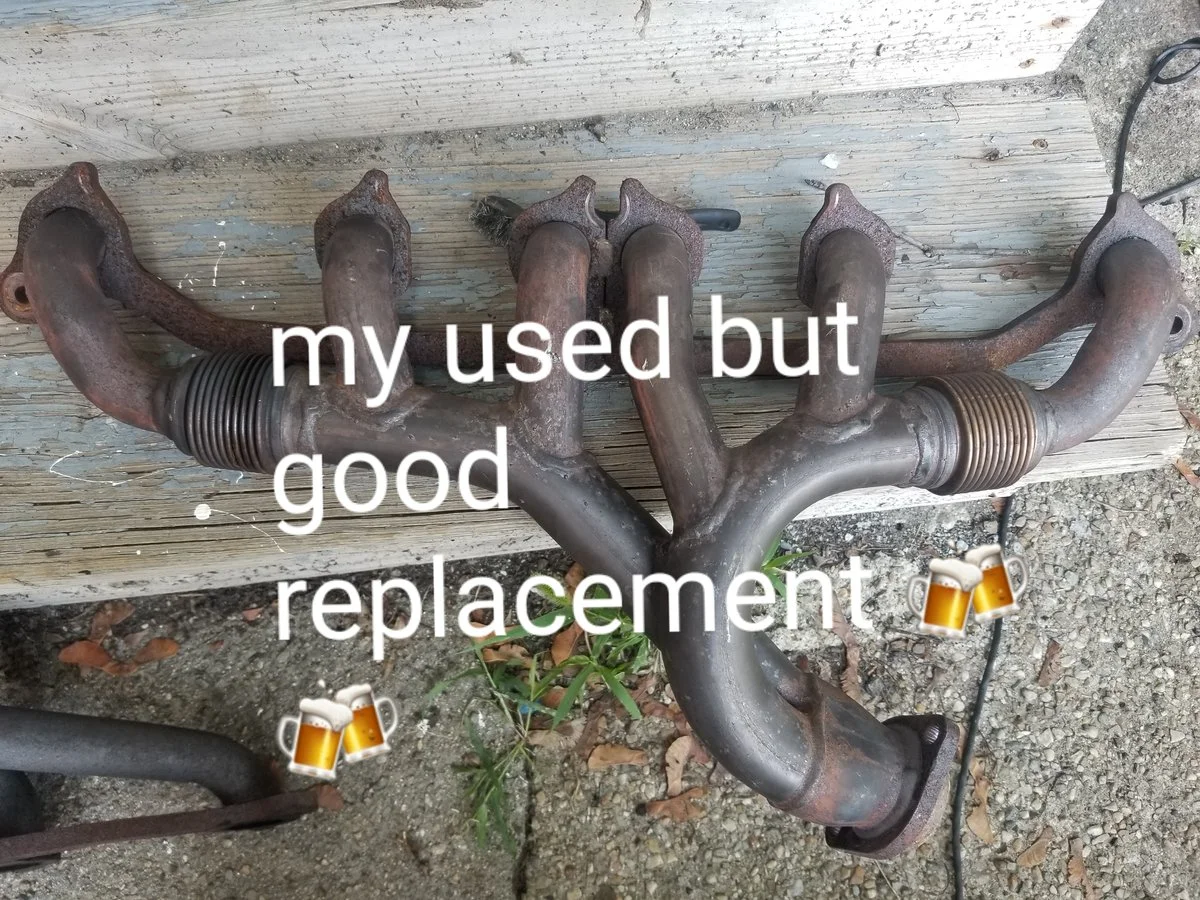

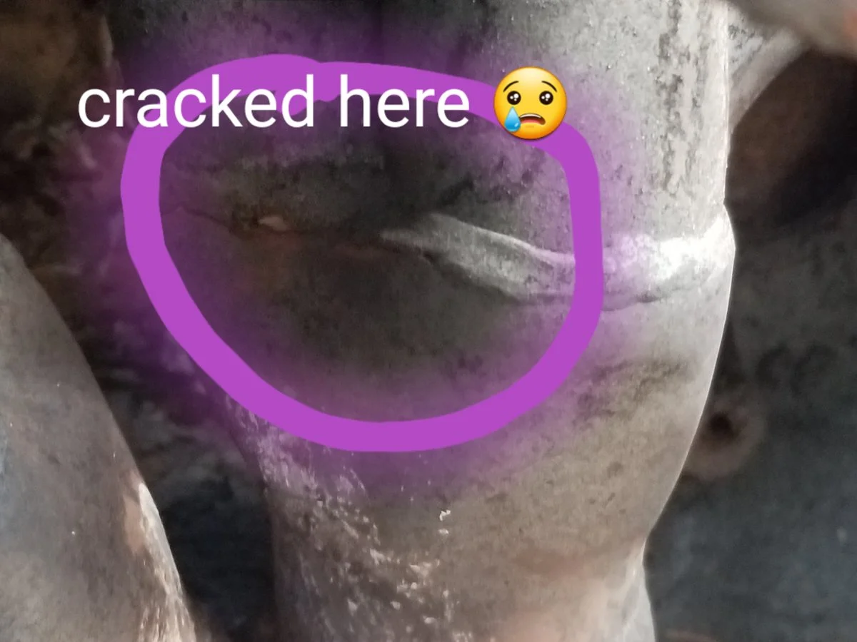

Didnt have much to do today, so i decided to replace the cracked exhaust manifold. The replacement is a used piece that is in great condition. Got it from my local yard for 25$ and it looks like it was recently installed.
The job wasn't bad at all, but ran into an issue at the end. The bottom at the flange 1 of the 2 bolts hole is bad ( can be seen on the pic of the block ). The bolt was too tight and went through the hole including the washer, wish i took a picture. Now only 1 bolt is holding the two pieces, so the flange doesn't go in all the way on one side.
Is there a way to repair it with some sort of kit? I cant image cutting the down pipe and welding a new one just to fix this. Anyone every had deal with this? Please advise

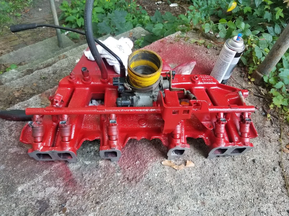

Attached are some pics of old and new exhaust. I also decided to quickly paint the block and intake manifold as they were nasty looking.
