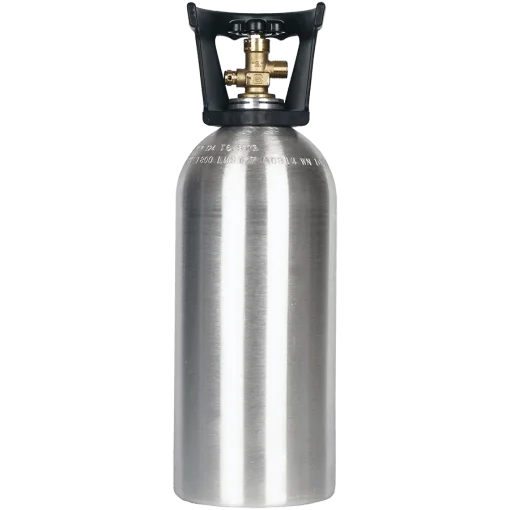

I bought a 10 lb. aluminum CO2 tank online from a beverage supply website where they are much cheaper for the same tank sold by a 4x4 site. Make sure it has the big plastic handle on it as shown in the first link.
LIke at this website: https://beveragelements.com/beverag.../10-lb-co2-cylinder-with-handle-aluminum-new/ (most sources are much more expensive than this one whose price is only $84.99)

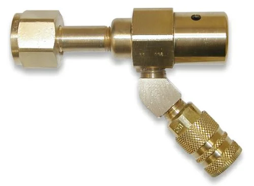

You can get a regulator from http://www.polyperformance.com/poly-performance-co2-fixed-regulator-227c-150
Then add the fittings & 45 degree angle to that regulator so it looks like the below. On the quick disconnect, be sure to get the 'Universal' style which fits both styles of male fittings commonly in use on air fittings. Add an air hose or coiled air hose and a tire chuck and you're done. Harbor Freight Tools has most of those parts, Home Depot will have the brass adapters too. Use teflon tape when putting them together. Make sure to only install the universal style quick disconnect or you may find yourself being unable to plug something into it later. Harbor Freight normally stocks them, my local tool specialty store carries them too.

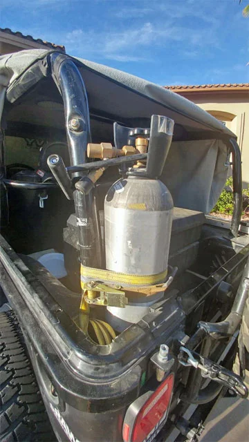

Jerry, how and where do you mount yours?
It's not permanently mounted, I usually just keep it inside a big huge aluminum storage box in the back of my Jeep. A cinch strap is sometimes used to hold it to the vertical section of the-most part of the rear rollbar as you can see below.
That's a bike lock through the top of it to add a little more security. And a protective black rubber crutch tip covering the quick connect fitting.
