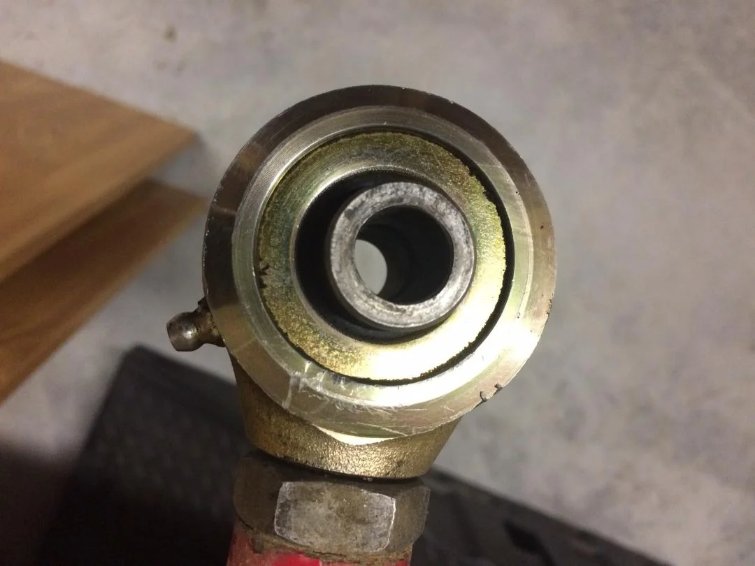

My Metalcloak front track bar heim joint started to fail somewhere around 10k miles. I didn't notice it until I was doing other work that required adjusting the bar. But after that, I realized it was plainly obvious during a dry steer test. It can't be seen by grabbing and shaking.

They sent me a free unsolicited replacement when I publicly asked how common this was. That was appreciated, but it still doesn't fix a design or a price point problem.You need some Cloak-Aid, too. And a nice hug.

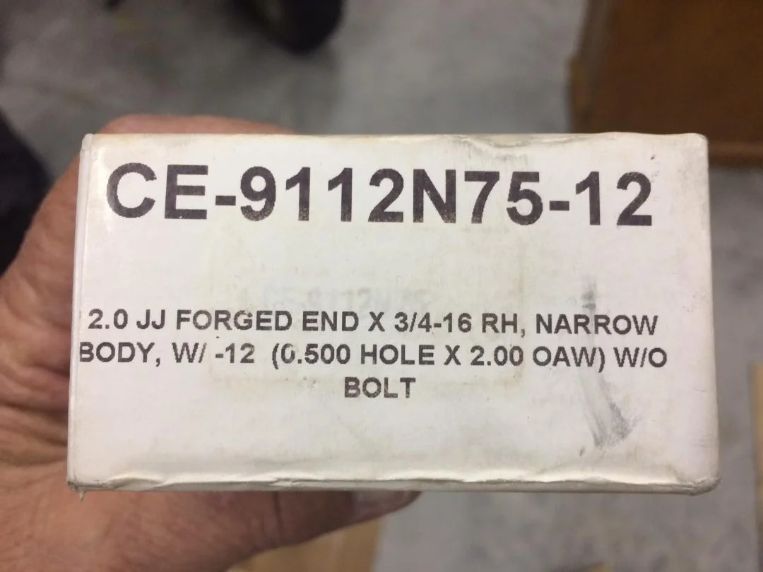

You just cant thread one in?And then I researched how to build my own Johnny Joint replacement end. That is the plan when this current MC joint wears out.
Easier said than done. Swapping to a JJ is a small welding project.Ok, I will go back to my first comment on this=heim joint, if it is a common thread, swap it to a johnny joint in single shear...problem solved.
Blaine and I discussed it a while back. There are clearance issues with the standard housings. I forget the specifics, but there is a reason that the Currie track bar has the JJ offset on the bar. They do sell the weld on housing with a specially sized JJ to build your own track bar.so I sorta remember your thread on this, but I dont remember why not?
A newb suggestion....You might could use a Johnny Joint to replace the heim joint on the end of your trackbar.
