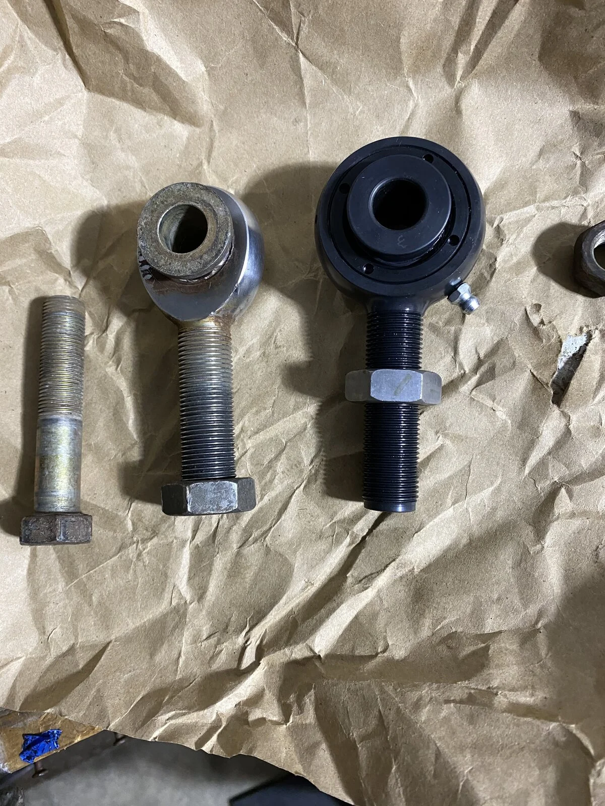

In my brief search I did not find anyone who was running the smaller forged JJ. Currie decided to run the larger weld on joint for a reason. Not sure of those details. I decided to order the EMF heim as it is rebuildable and adjustable. Expensive, but if it lasts it will be worth it for a bolt in piece that hopefully will solve my problem.
I received a call back from MC asking about what issues I was having with my heim. I told him that I had found an adjustable, rebuildable and greasable joint. He replied”EMF”? Talked very highly of them. I suggested they offer those joints even as an upgrade. Seems they may be reluctant due to possible supply issues. EMF is a small company who does all work in-house, that’s what I read anyway.
It could be as simple as any smaller joint isn't going to be strong enough for the application. It would explain why the MC heim is failing so often since it's even smaller, and not a JJ.
Very well could be. I ordered an EMF adjustable, greasable and rebuildable heim. Everything I can find on their products says they are top notch. Being able to adjust it should make the life plenty long. Will post up when I receive my order.

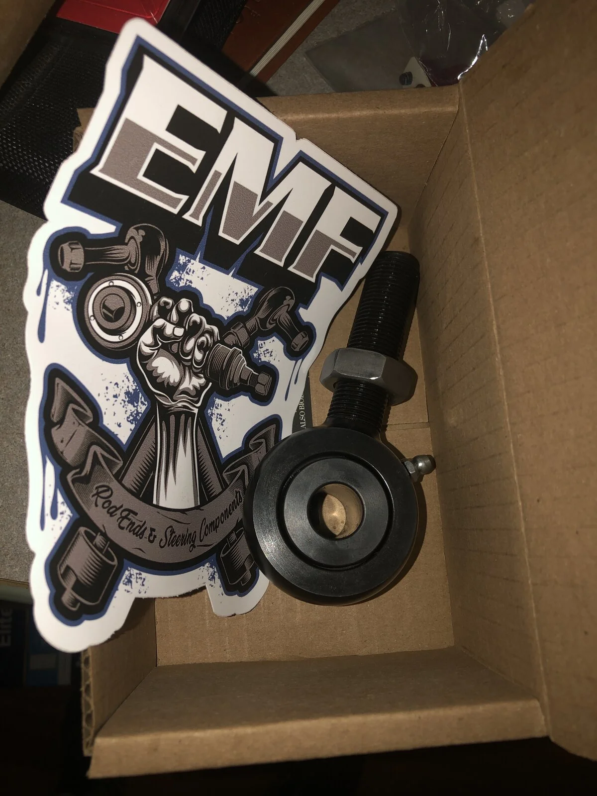

The EMF joint showed up today, a day late but reasonable time coming from Canada I guess. Was packed well and they threw in a couple stickers. Joint seems well built
and stout, hoping to install tomorrow.

Started install, thought the bolt was going to be the problem, ended up taking off front tire for more room broke it loose fairly easy, probably should’ve done the jam nut first and hit it with a penetrant a few days ago it’s giving me a hell of a time getting it off, hit it with the yellow Map gas torch and some Freeze off, still won’t budge. Retightened the bolt and nut to get rid of any slack but it’s on there good...
Started install, thought the bolt was going to be the problem, ended up taking off front tire for more room broke it loose fairly easy, probably should’ve done the jam but first and hit it with a penetrant a few days ago it’s giving me a hell of a time getting it off, hit it with the yellow Map gas torch and some Freeze off, still won’t budge. Retightened the bolt and nut to get rid of any slack but it’s on there good...
I just adjusted my track bar after installed different front springs. That’s when I found the play. So mine should be pretty straight forward to RNR.
Anyone know offhand what size the OD of the jam nut is ? I’m assuming over an Inch, none of my wrenches are big enough and the adjustable isn’t cutting it so far.
I’m interested if it will have the same amount of misalignment as the MC heim does with the spacers. Looks like it will. Also make sure you install it with the adjustment side down. So in the event of a failure it can’t fall apart.
Are you talking about the “retainer ring” for lack of better term facing down ? Only issue with that I see is it’ll make greasing a bit cumbersome but if it’s safer...then I’ll do it that way.
EDIT: ended up installing grease fitting out for now, I’m kind of weary of torquing all the way to 150ft/lbs after seeing that other ball crack....it’s at 120 now, going to keep it at that until I can confirm with EMF.
So I texted the tech support number on Saturday about the torque specs, about an hr or so later I got a reply, they said 150 should be ok and it’ll start deforming at 200. Super impressed to get a response on the weekend.
And for the jam nut issue I’m an idiot, I was so focused on the just going the direction to spin the nut off the stud overlooking that it can’t go that way as it’s jammed there lol, to realize I needed to back it off and go the wrong direction....smh good to go now !
