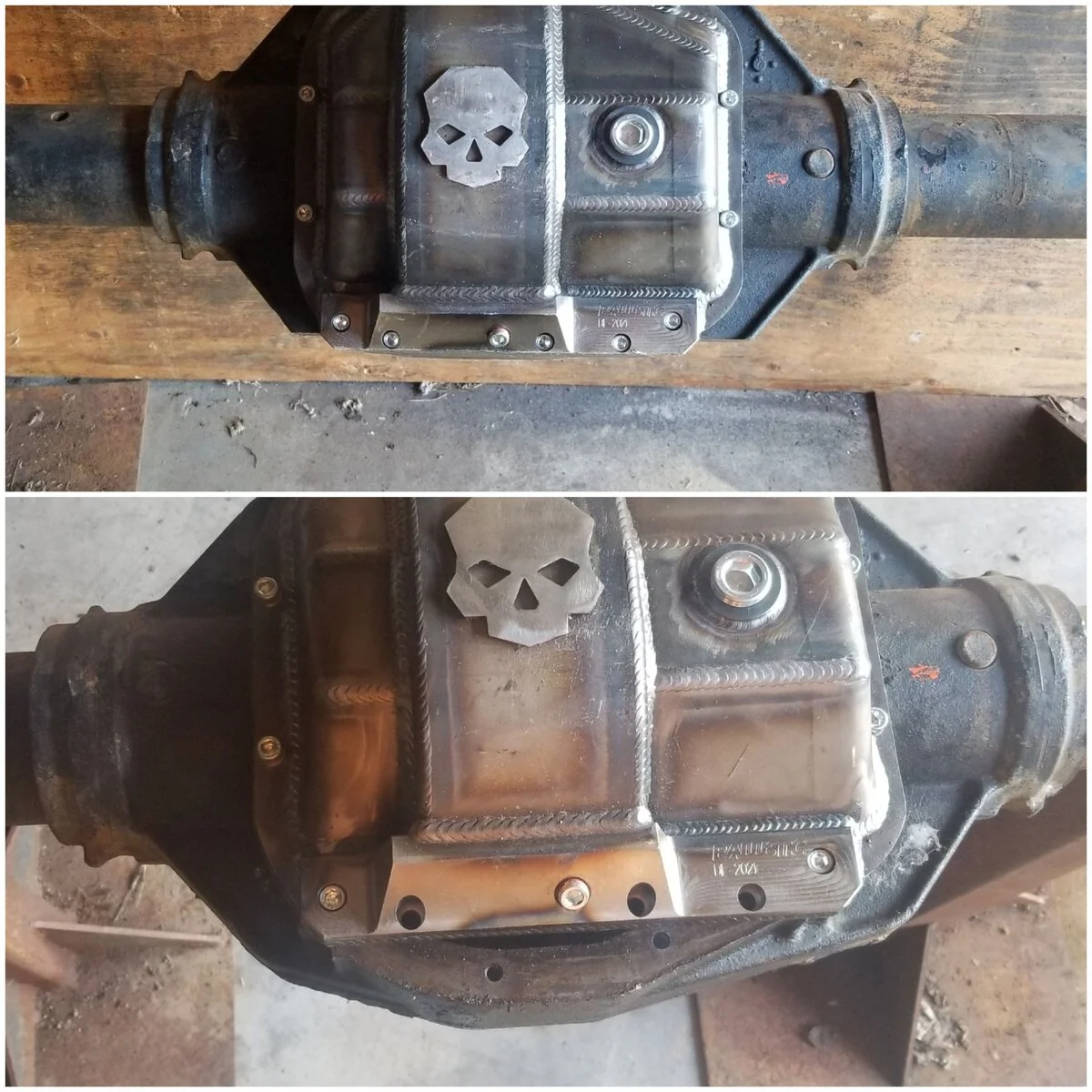

I really like this 10.5 shave kit
Full width and use stock tank but build a skid cover the clearance for diff the heat gun tank shve it in and form fit!......I have done a few like that
What will you shoot for on track width with the full width axles? Like EvansCreek has 80" limit and I know naches has some limits too. Where do you wheel in WA?
Reactions: Wildman
WOW nice!! Does this change how large of a ring gear you can run or why is there so much excess casting on bottom? Seems like the challenge will be getting a good uniform sealing on the new surface.
I have to turn the ring gear down to 10 in they dont sell lower gears for 10.5 because the 10.25 works so l will take .125 off and as far as sealing its all machined so rtv works grat

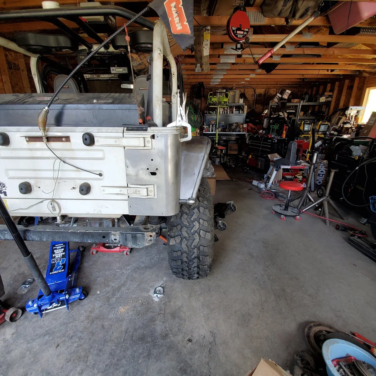

I went with the Metal Cloak stretch corners and Overline fenders and have their 8" flares. The only reason I went with them was so that I could remove the flares when wheelin. I had 3" flares on my old Poison Spyder armor before and my tires stuck out enough I got hassled by the SP a few times. So I ended up only being able to push my rear axle back 4.5" and haven't started on the front yet so I don't know if I am going to so any stretch in the front yet.

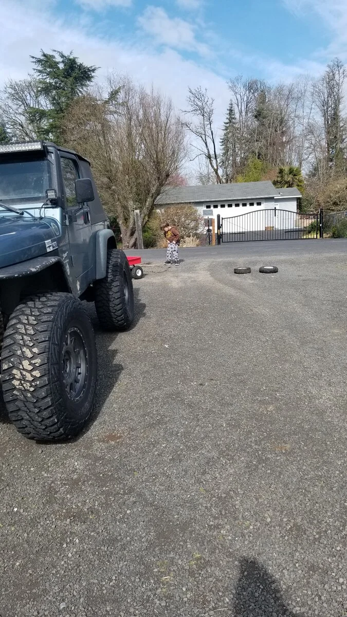

Here is what my 36x13.5x16.5 iRock mounted on a 9" rim with 4" of BS looks like on a 61" wms axle. This is all just mocked up right now so the axle may shift a small amount when all finished.
